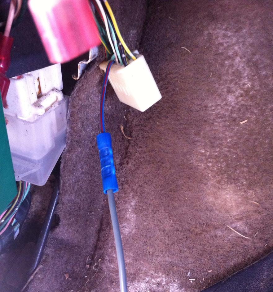

So yesterday I attempted the mod. I found the blue/red wire under the kick panel on the drivers side, cut it and touched both sides to ground, 1 at a time then both, but nothing changed the flash of the locker light except putting it in low. So with the wire cut the switch worked like normal.
The blue/red wire I cut goes into the black box under my seat, is that the right wire?

You able to share any photos?
this black box?:

The Blue wire w/ red stripe comes from the black box by the driver's side kick panel. You want the ground the side that comes from the plug. Found a pic for reference. Also just to double check, did you try driving and turning to get the locker to engage? The light will flash until it engages.
