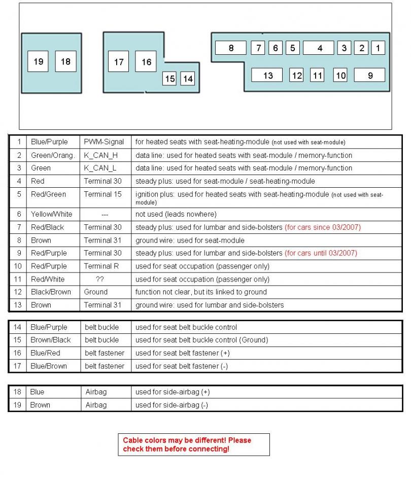

Hey guys, I'm working on adding power to a seat pulled from a 2015 BMW X5. I thought this would be an ideal seat to use since it's the passenger seat with less use and includes quite a few controls.
For now, I'd be happy if I can just get the movement controls working, things like memory, heat & cooling can wait. These are the wires coming from the pigtail connector:
This is the wiring diagram for the connector:
Connector X12*1B
So far, I've only been able to get power to the lumbar adjustments working by connecting the smaller red wire and one of the large brown wires to a battery. However, there's no added power when connecting the large red and the other large brown wire to the battery.
The small brown/blue pair are for the airbag, so I've twisted them together with a wire nut.
These are two sets of yellow/brown, yellow/red pairs. One pair is used for the "Front Passenger seat module" which appears to be required for the seat functions, including heating and ventilation.
https://www.newtis.info/tisv2/a/en/...nts-with-a/a245-seat-module-driver/1VnYvNnU70
I’ve tried powering all red wires with all brown wired grounded (excluding the small blue/brown pair which is for the airbag). Do I need to be running one of the yellow/brown, yellow/red pairs to a 5v power source?
I'm not sure where to go from here, any ideas?
Usually on a BMW, the yellow twisted pairs are the CAN High and Low.. as the voltage floats and it just looks for a voltage differential of 5v I believe rather than say 0v and 5v
