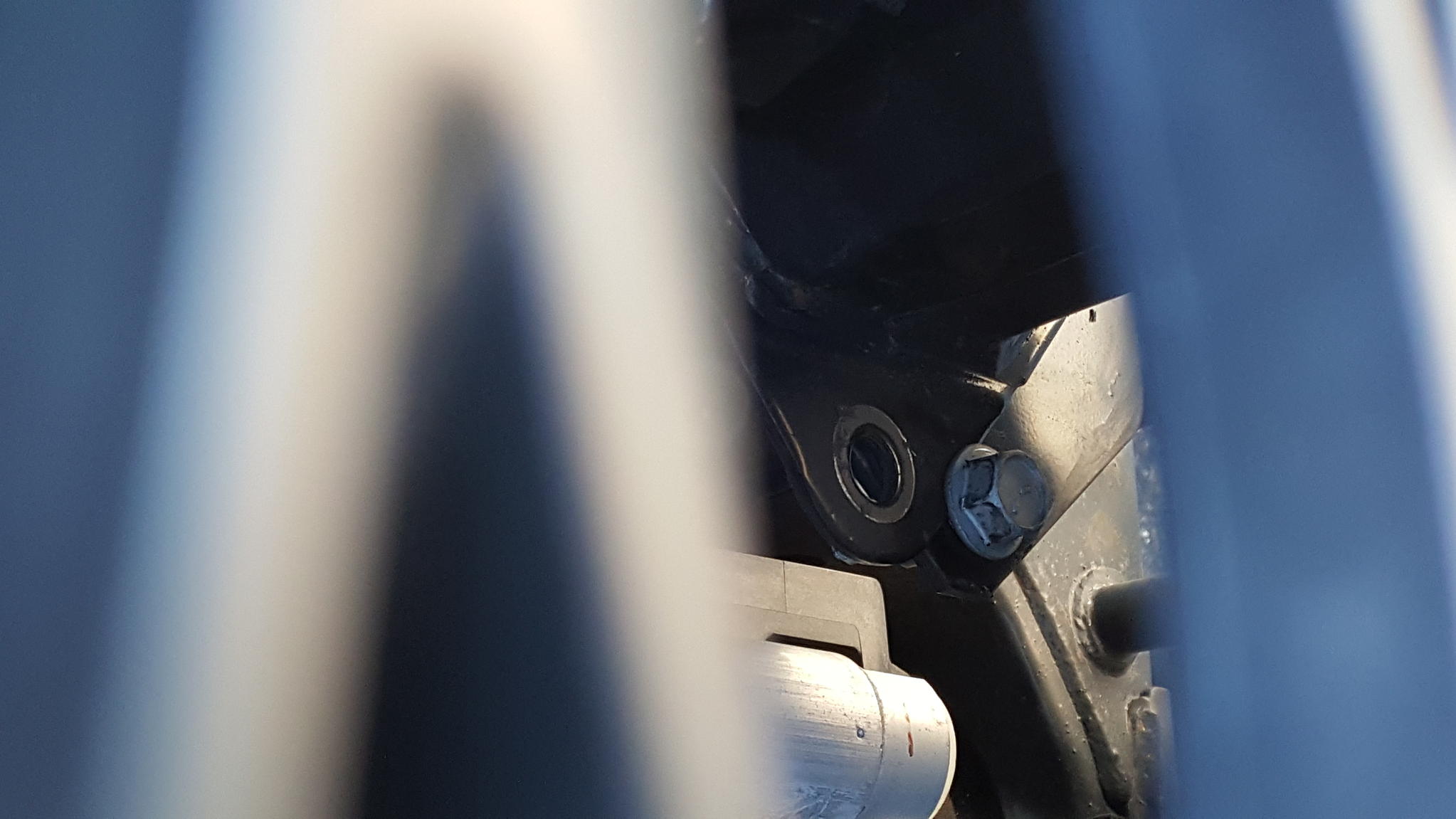

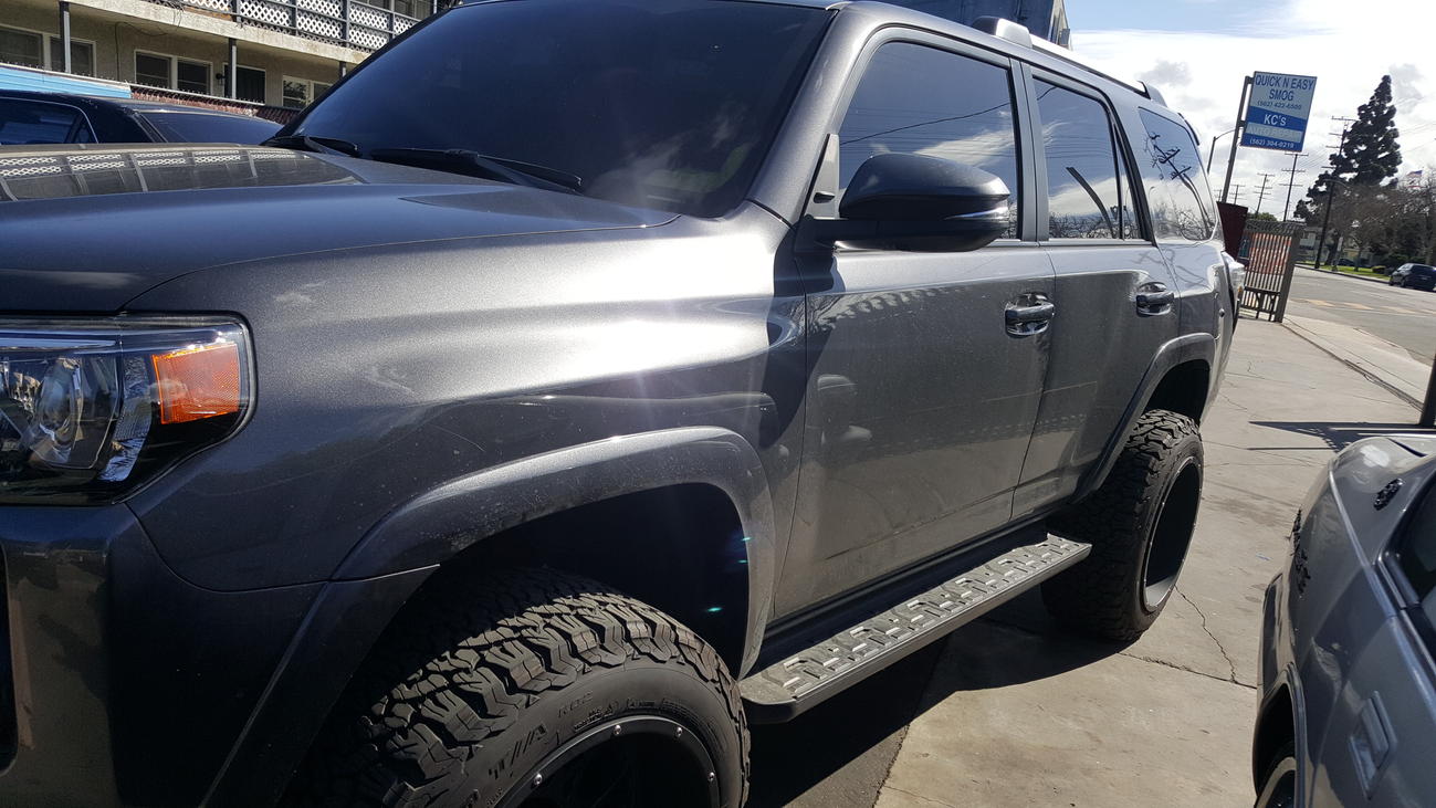

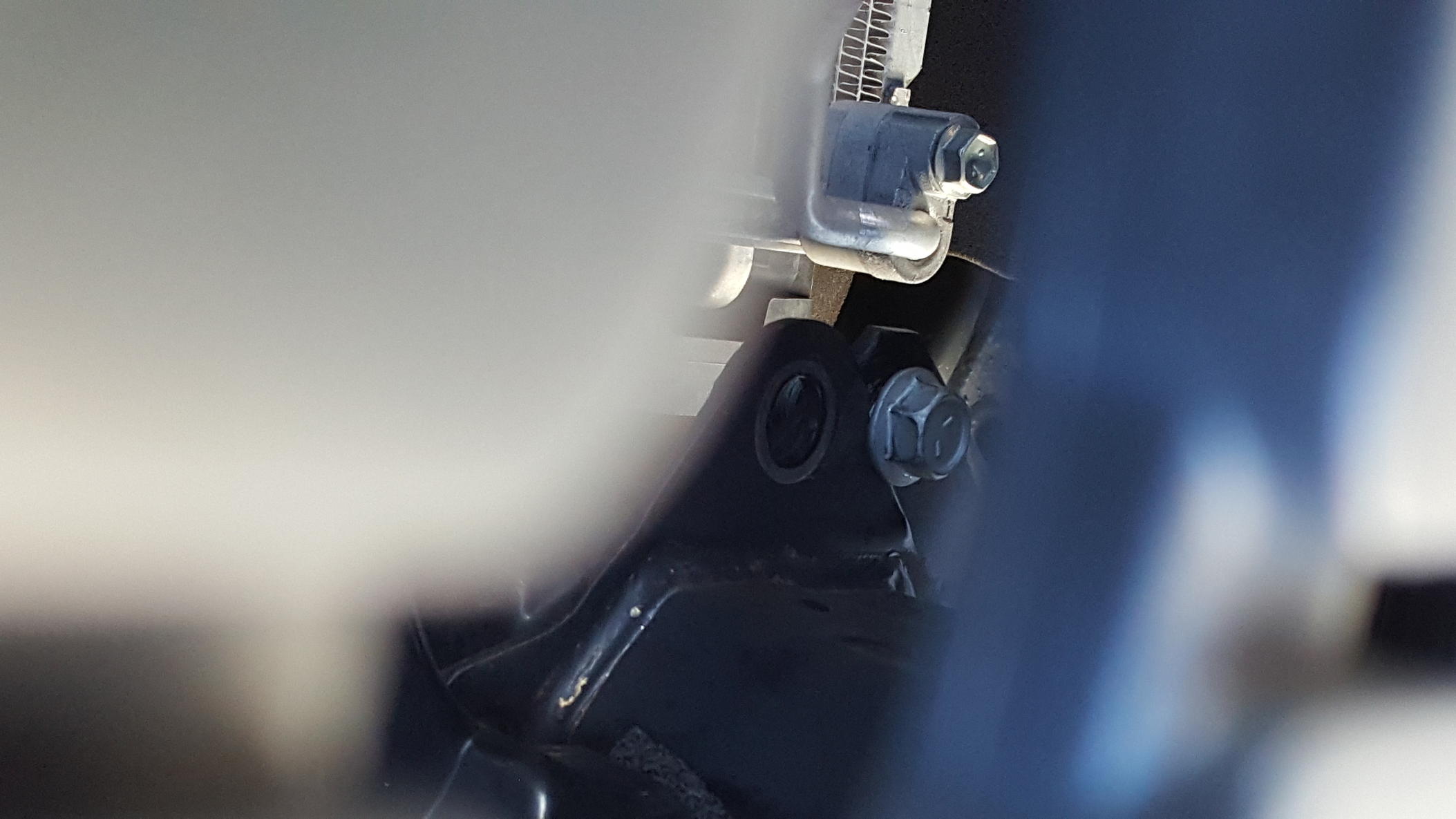

Hey all, just needed an opinion I just installed a 1 inch body lift from toytec on my 2016 sr5p and put on my front bumper cover without moving the bumper support up as suggested by other 5th gen owners with a body lift. I did notice I had to use a little more strength to get screws to line up but all screws and everything ended up lining up almost perfectly. My question is will this be safe? Would I be better off moving that bumper support up? I don't want my cover flying off on the highway. Thanks!

you should be fine with moving it up one notch.
Moved up the bumper support bar
Moved up the bumper support bar and reinstalled 6 of the 8 screws instead of 4 as suggested, the extra 2 however are just sort of wedged on the edge of the bracket not in any of the holes and are just on there for my peace of mind.
