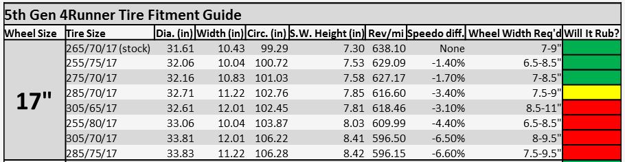

Forgive the vagueness. To my knowledge, which is admittedly novice, you will need to upgrade the UCAs to accommodate the angle changes involved with tires and lift and a BMC as well as fender liner cut will be mandatory. I am not familiar with anyone on here that is running 35s and from some images Ive seen of rear tire tucking while rock crawling, body impact seems likely too in those situations.
I have attached a guide I saved that was posted by another member (whom I forget) to give you some guidance perhaps. I did all my suspension work and tires simultaneously so not sure how the individual components impacted the need for BMC, just what I learned on here.
