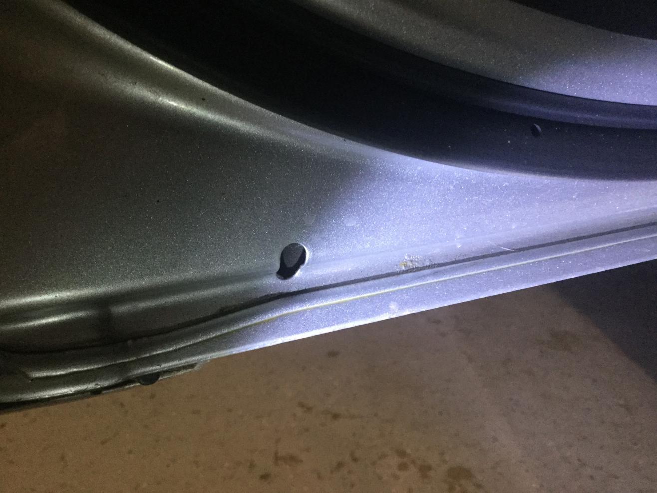

i have a little bubble above the rear license plate bezel/Toyota emblem and just noticed some forming at the bottom of the rear door on the inside. I was surprised. It very slight and I can manage it with waxing and fluid film....for awhile. I actually just put corrosion x on it. a thin wipe.
I would just take a cheek poker, rust stabilizer, and a paint pen to it. Get the rust out now while it's mild.
Waxing and fluid film is just going to trap the cancer and help it fester.
