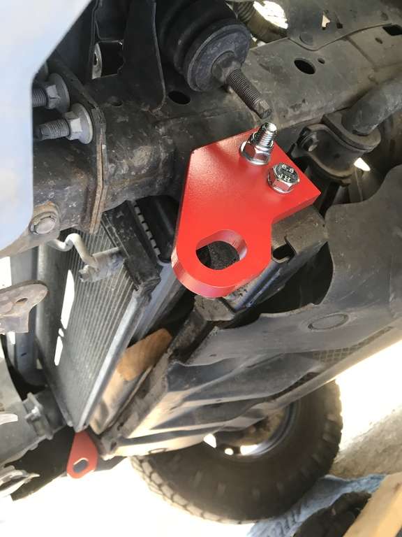

Here's a picture of them installed on my 4Runner. I painted them red to confuse the Jeep guys. :pound:

Why is there a 2x4 wedged between the cross beam and your radiator?

:pound: I was going to come up with a crazy story about hitting a fence and getting wicked air . . .
But, you have to loosen the radiator mounting bolts and lift the radiator up a couple of inches to install the recovery points. It's to make room for the bolts which, as you can see, are installed from the inside out. Once they're installed, you remove the 2x4 and bolt the radiator back into place. It's actually very simple and TOR provides very clear instructions.

I was figuring that was what you were using it for but wanted to ask, Hoping it was not ment to stay there.
