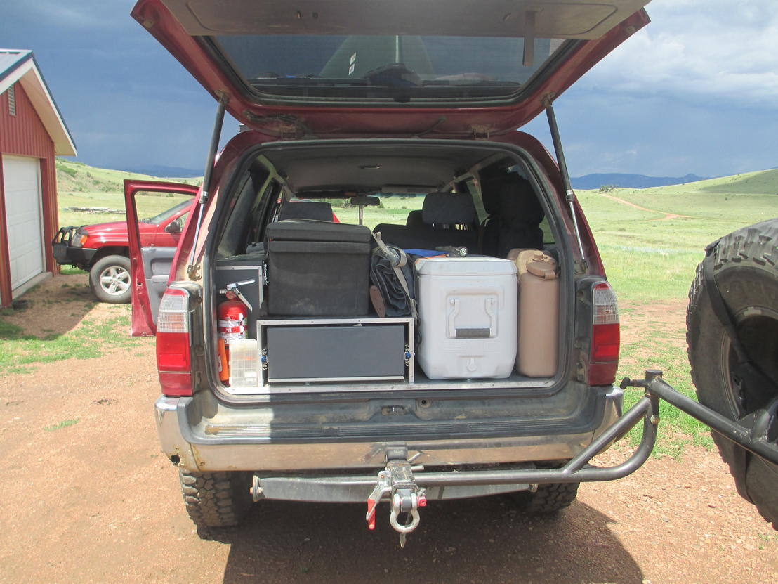

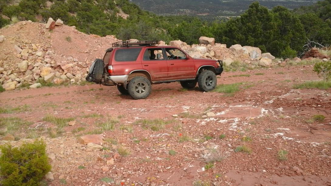

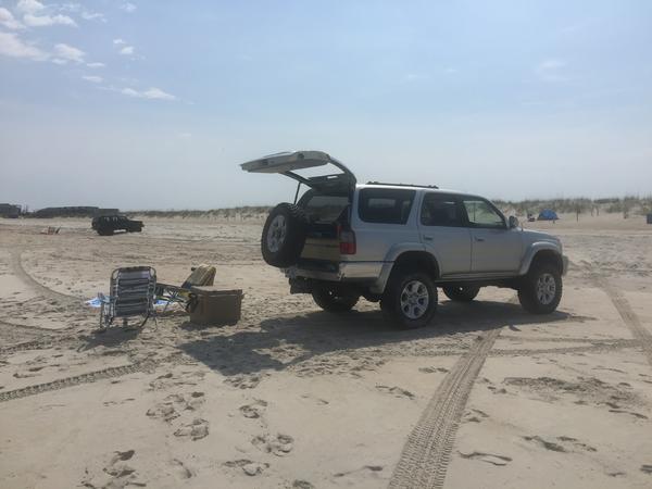

20170521_174020.jpg I built my own bolt on swing out . Some day I'll build a bumper and put this on my moms 4Runner but in the meantime it works pretty well. IMG_2492.jpg

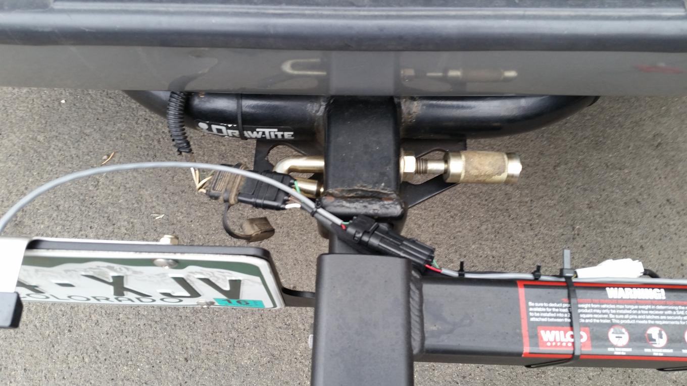

My Hitchgate does not rattle at all. I've been running one for almost a year now and I just completed a 5,000 mile overland trip with it. It is well built and plenty strong.
However, it does not play well with our hitch setups. In my opinion, the factory hitch on a 3rd Gen sits wayyyy lower than it should. This is especially true if you have the factory welded hitch and the "hitch flip" mod is not possible.
Our hitches already act like a skid plate offroad and the Hitchgate only makes this worse. Mine extends pretty far from the bumper...and since it sits so low it only makes matters worse. I only bought one because I found it for cheap on Craigslist and I like the idea of being able to use it on my next truck. Spending $1500 on a custom swingout for a truck that's 17 years old didn't make sense to me.

This is the exact reason my bolt on is temporary . In fact , when I was building it I tacked everything up and quit for the night and came back the next day , looked at it , cut it up and did the hitch flip and rebuilt it.

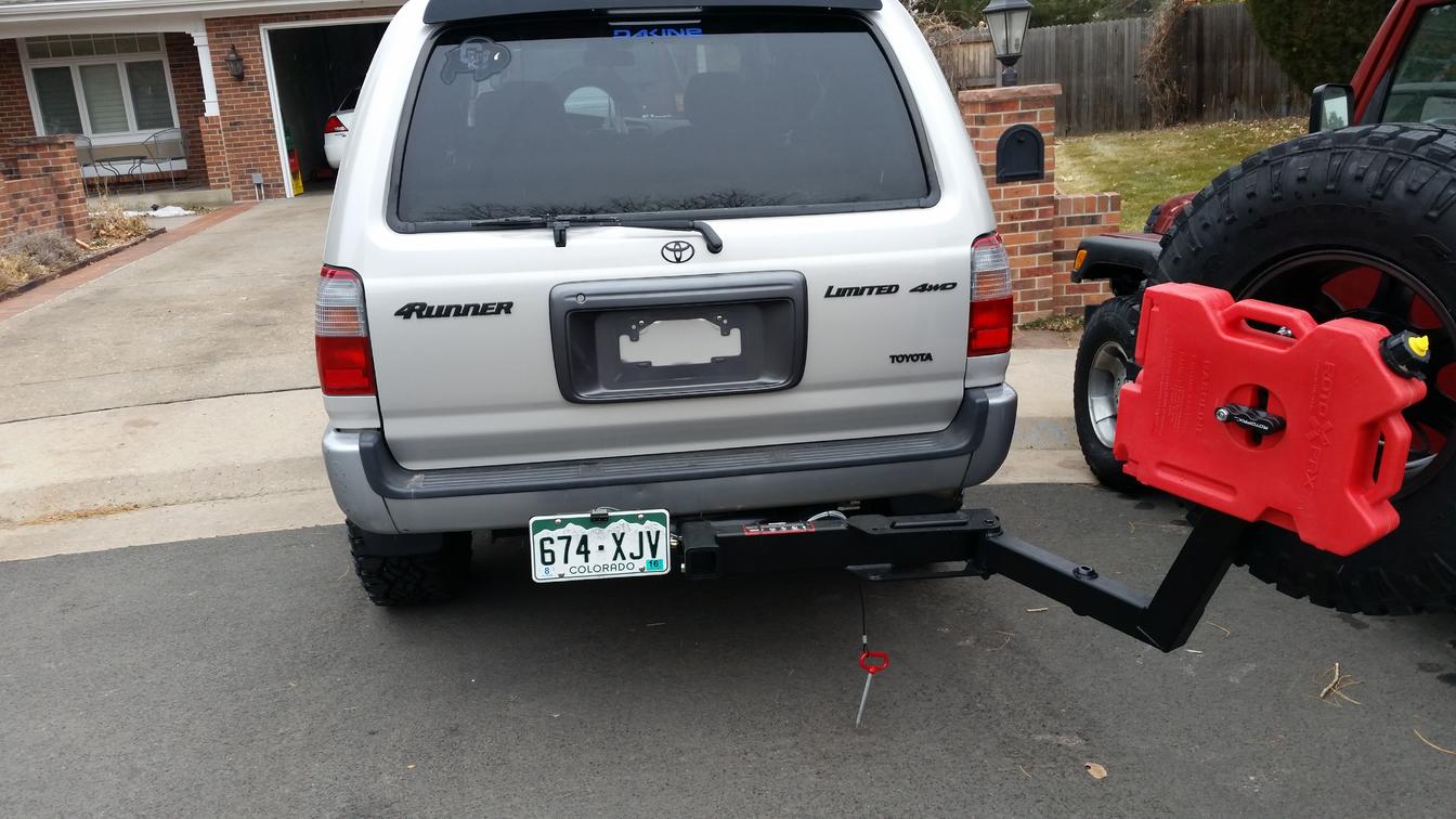

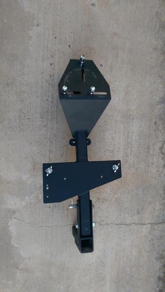

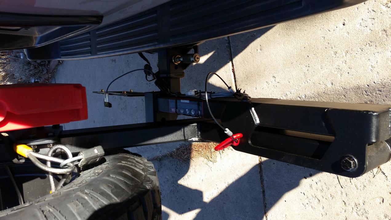

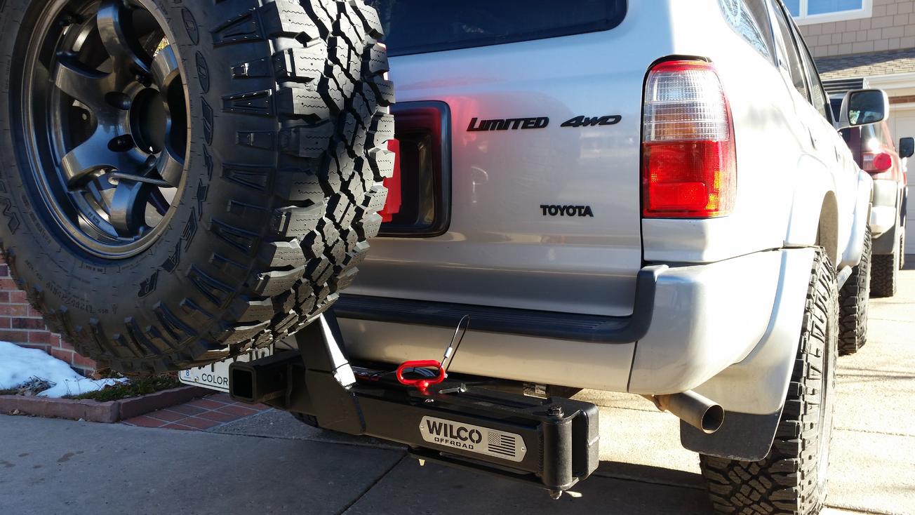

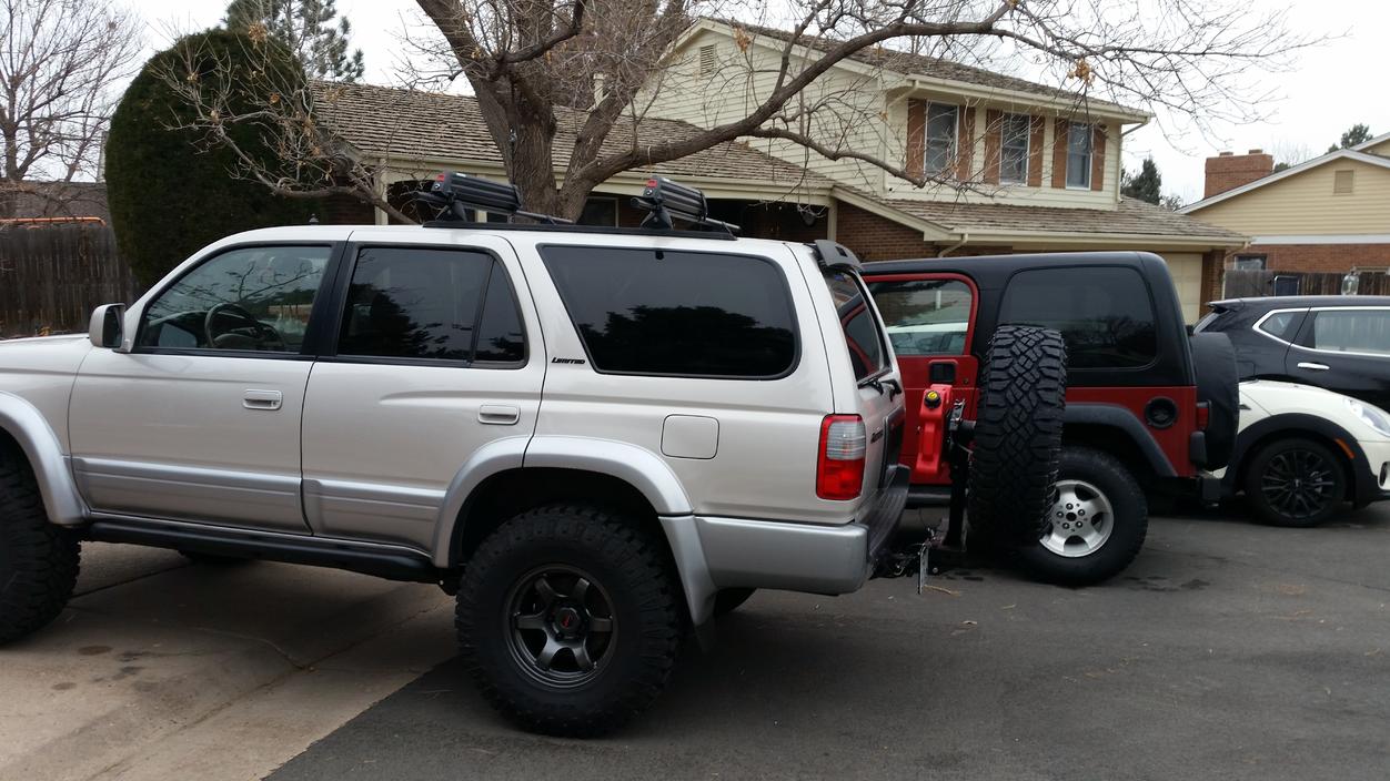

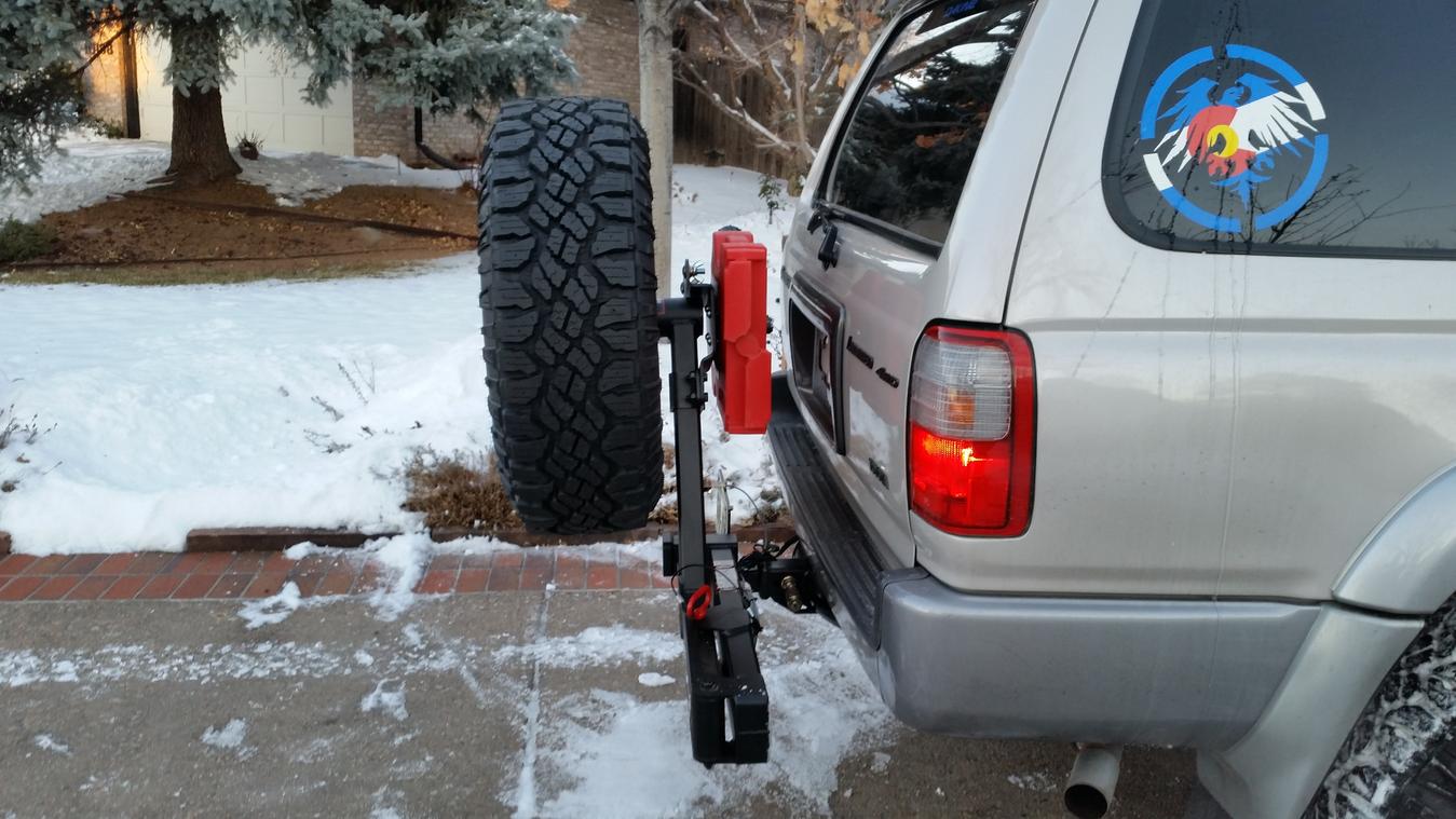

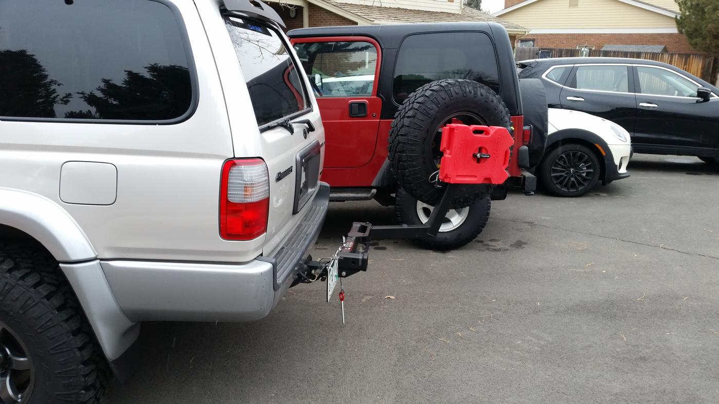

Bought the Wilco Hitchgate Solo for daughter's 3rd Gen 4Runner during a group buy. Cost me $390 + license plate relo kit.

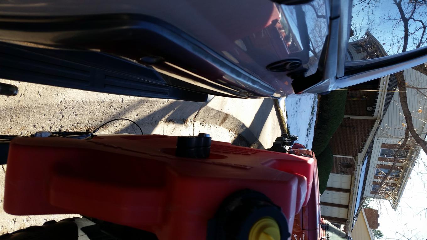

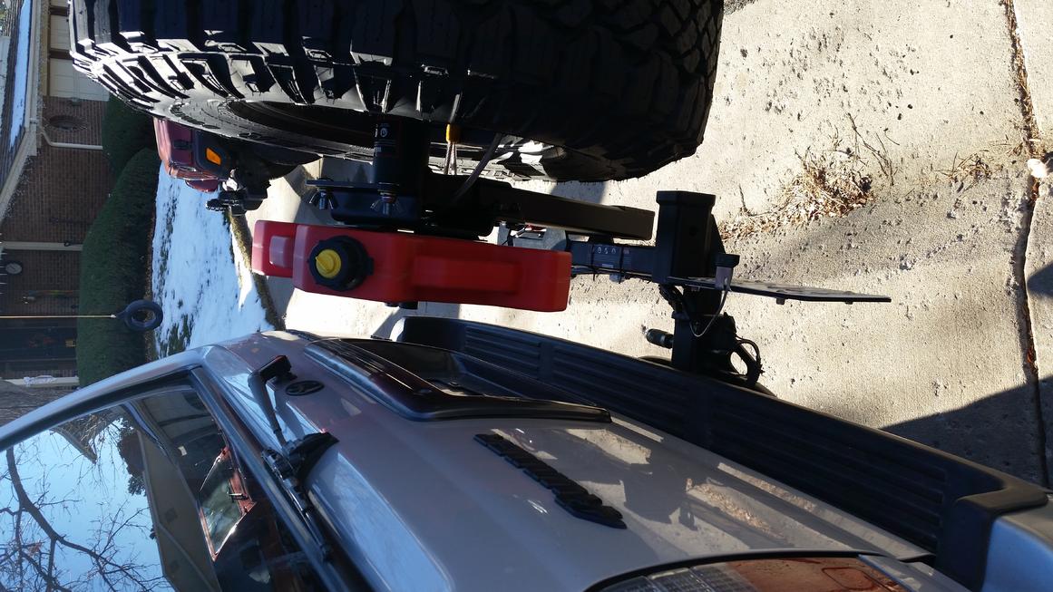

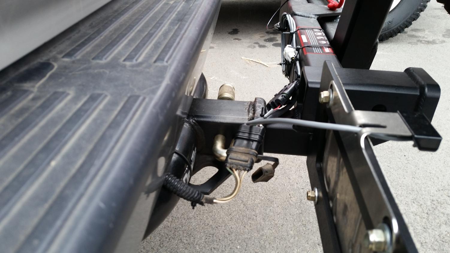

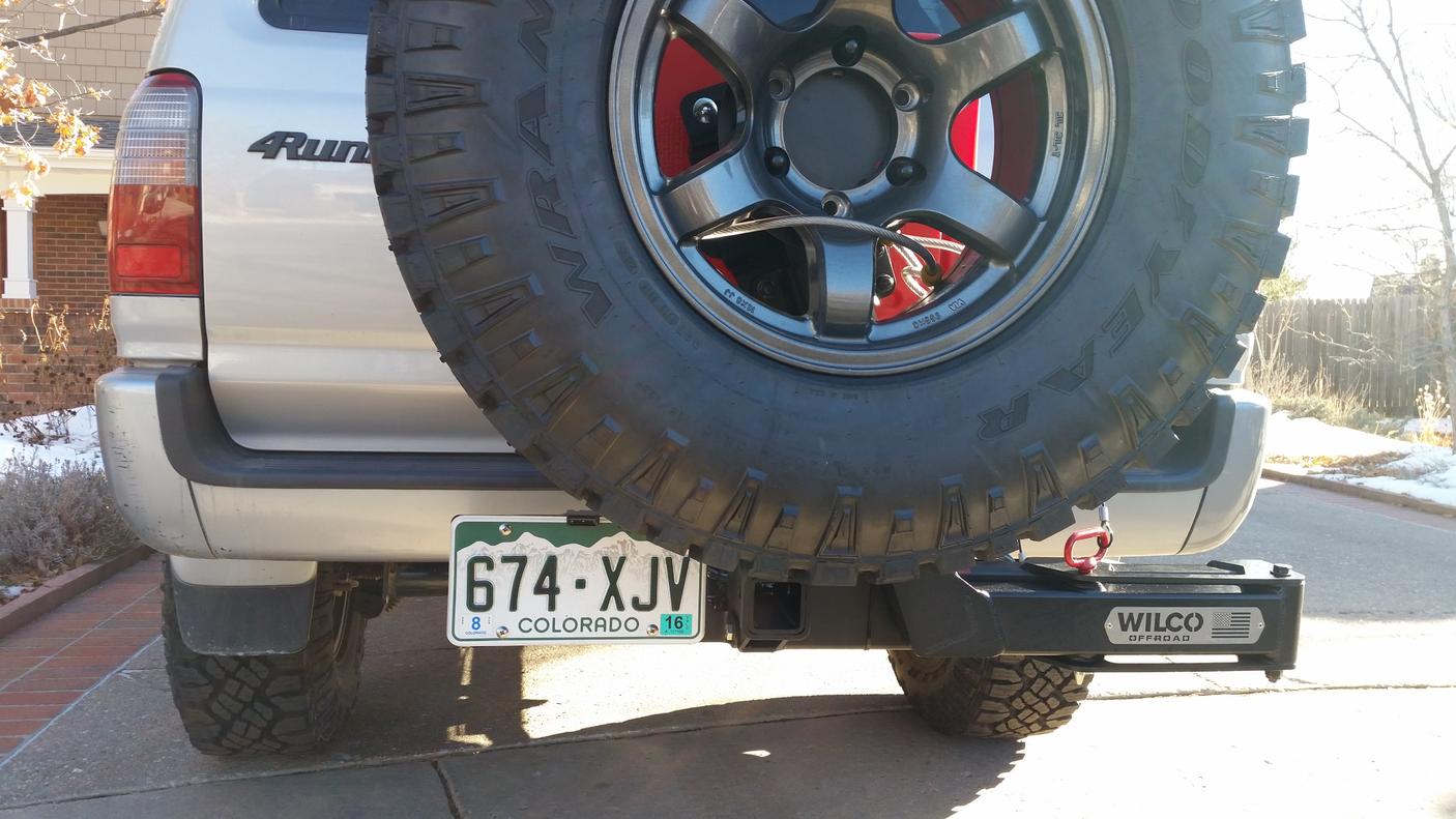

Few more pics. Definitely adds some length beyond what a swingout rear bumper would have. But for the price I got it way cheaper than rear bumper with swingout. I think most swingout bumpers that I have ever seen are $1300 plus but perhaps the poster above knows of a much cheaper rear swingout.
Bought during a Tacoma World group buy. I dont think you need the very large hitch racks...just the solo. It also has enough room to carry 3 gallon Rotopax (pics show the 2 gal on there).
