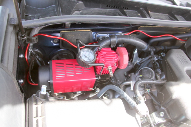

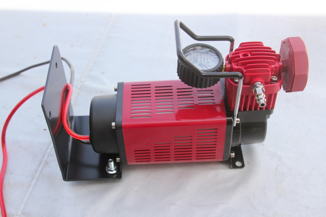

Installed an air compressor under the hood this weekend. I bough the MV50 compressor from Amazon based on all the various reviews around the web. First thing I did was tear it apart to see what I could do to improve it. Interestingly, it looks like they've made some improvements over the past couple of years. The intake and exhaust ports were slightly ported (I ported them a bit more just because). The reeds looked good. They've added some rubber o-rings to help seal the ports. So I really didn't need to do much to the head. I did replace the battery clip wiring with new, larger gauge, wiring.

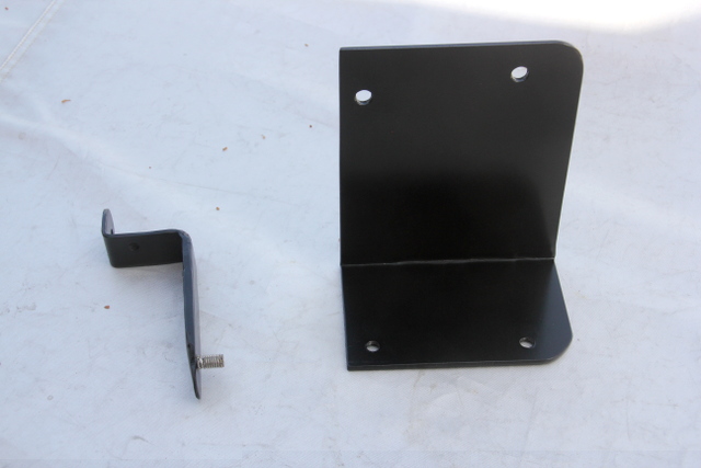

I fab up a couple of brackets.
The large one is aluminum and will attach to the inner fender. The smaller one is hacked up steel angle bracket. My welding skills suck, but with lots of welding and grinding it turned out ok. I only used 3 of the 4 mounting holes on the compressor. It's mounted pretty good so I think this is enough.
Here's the compressor mounted to the large fender bracket.

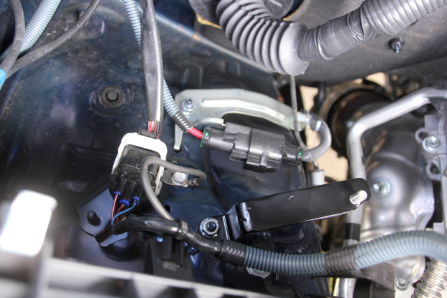

Here's the smaller bracket mounted to the stud on top of the fender in the engine bay. Yes, while welding it up I lost a corner of the bracket. I decided to cut my loses and left it that way vs. trying to add more material back and making it worse. With this set up, I did not have to relocate any of the existing wiring.

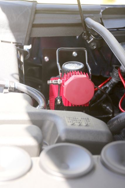

Then it was just a matter of hooking up the ground wire and setting the compressor in place. Here it is with all the bolts/nuts tightened up but the wiring not yet zip tied in place.
And one more from a different angle.
I let a bit of air out of one tire and tried it out and it works pretty much as expected.

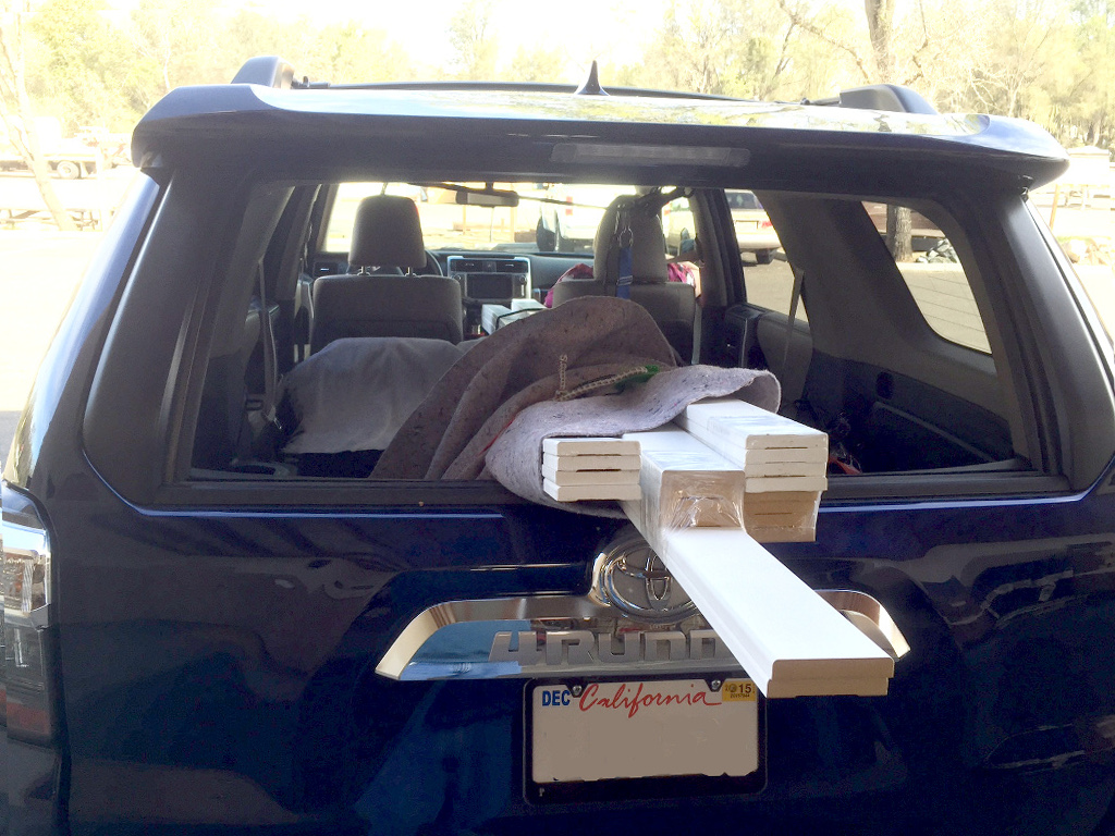

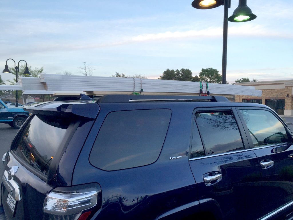

Not very exciting but here's an update on hauling the trim boards.
When picking them up initially, I put the rear window down, stacked them up on the center console with a bit hanging out the back. The longest boards are 11 ft. And, yes, I drove most of the way home with my hand on the boards just in case I had to stop quick. I did have a bungee on the back tie downs holding the boards against the tailgate so there was friction there that kept them from sliding.
To get them up to our cabin, I had to strap them up on the roof rack. I used 1x8x6ft pine boards to provide a little extra support. I used bungee cords looped around the crossbars. I've used the bungee cord method when transporting lumber on the roof rack for years and even with a fair amount of oak, it has always held them securely. With the setup below, there was very little bounce (we kept an eye on them through the sunroof). The large bundle did have more slip forward/back than I would have liked when testing, but they didn't move at all during the 2 hour drive.
When doing this, don't open the tailgate before removing the boards. I did that once with my 2006 and was shocked at how much damage the wood did to the paint on the spoiler.

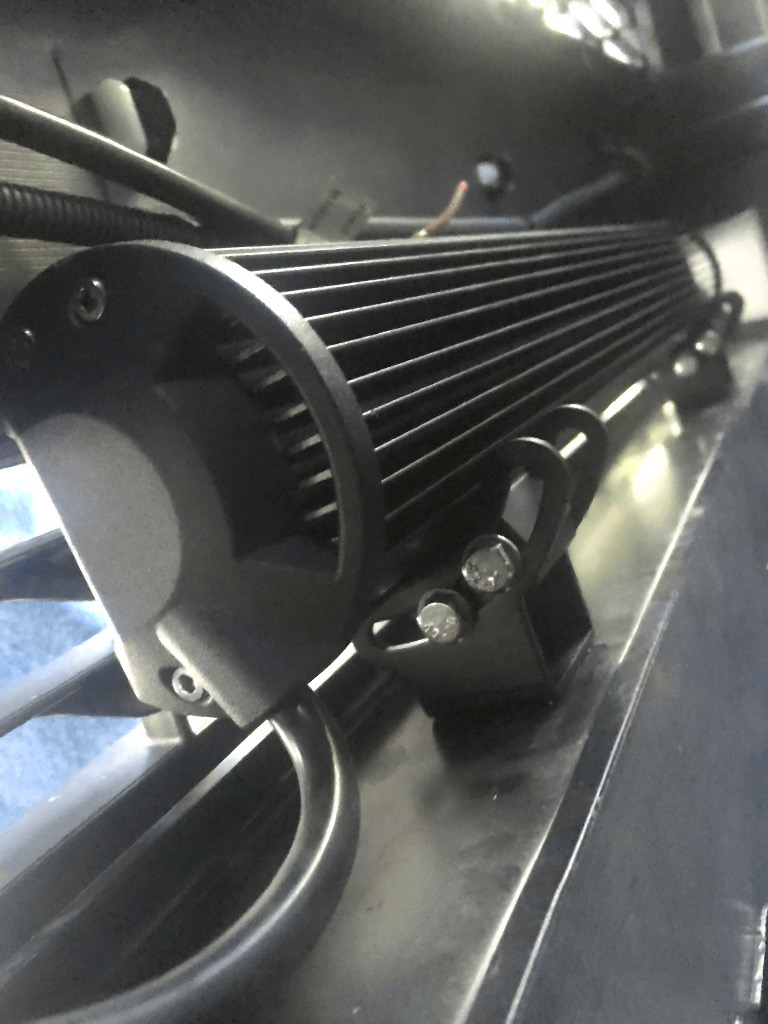

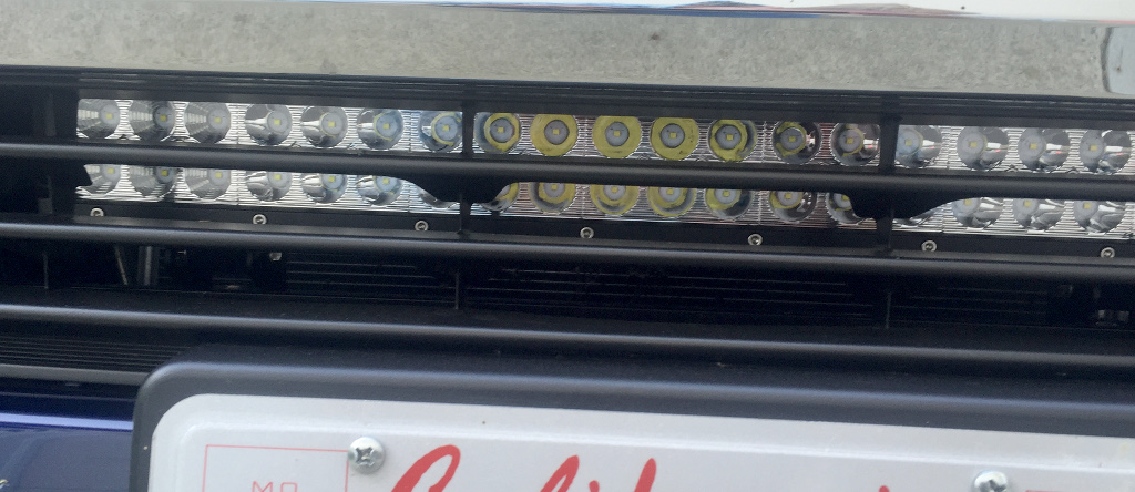

SiriusLED 20" lightbar
The reviews seemed good and the price is right. I decided to mount it behind the grill and it seemed to line up well when placed on the aluminum bumper.
Actually getting it mounted there was a bit challenging. The mounting brackets that it came with are designed to mount to through holes. Something where you can get underneath and tighten a nut on a bolt. I didn't really want to drill through holes the aluminum bumper and go buy extra long bolts so how hard could it be to drop it in there?
Getting to this point was like solving one of those bent nail puzzles. I started by drilling and taping two holes in the bumper to mount the brackets. The brackets mount to the light bar using a t-track in the housing. So I took off the endcaps from the housing and loosely attached the mounting block to the bracket and then the bracket to the bumper. I then could slide the housing back on to the mounting blocks, put the caps back on, and tighten everything down.

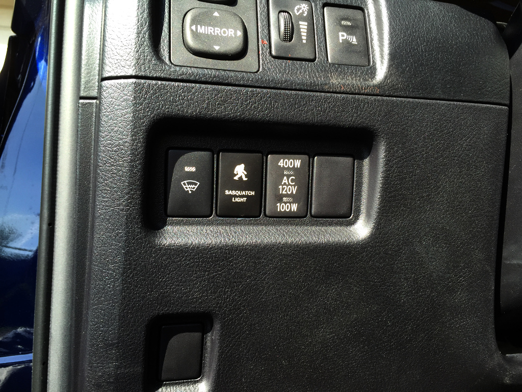

This switch was hooked up to an empty slot in the fuse box that had switched power using an add-a-circuit? so that the lightbar can only be turned on when the ignition is on, but it isn't wired to the high-beams. Since it will only be used off-road, this should work fine. Here's the add-a-circuit in the fuse box.
Does everyone just leave the fuse box cover off after using one of these? I did find another type of tap that should be much lower profile, but it doesn't add a new circuit. I may give that a try.

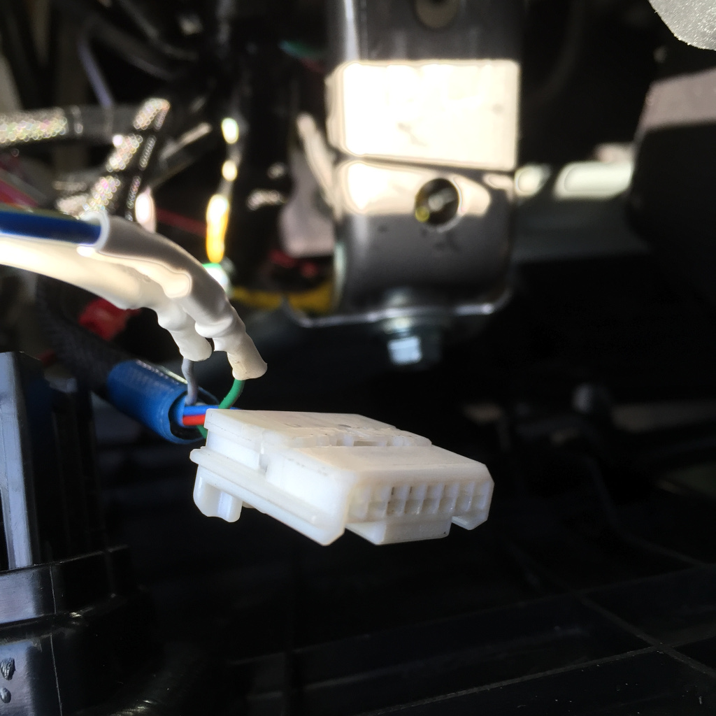

I took the green and gray wires from the empty white plug behind the dash and pulled them out of the plug. I simply wrapped the bare wire around the connector ends and covered with heat shrink. This seemed like a reasonable fully reversible way to get the dimmer circuit to the switch. It would be ideal if there was a connector with pigtails that could be plugged into the plug.
Here's the final results, I scraped my hand a bit while working on the wires back there but didn't realize how much blood I left on the dash until I saw the picture :)

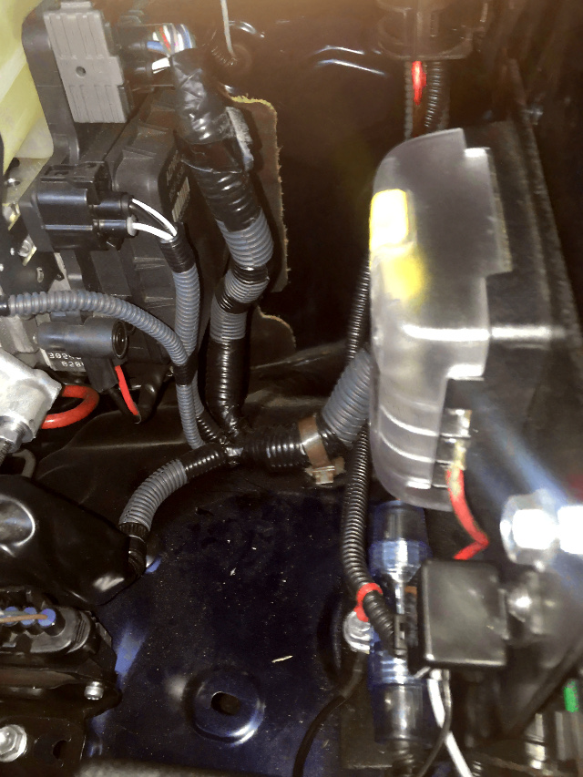

Here's some of the under hood wiring. Not too exciting. Relay mounted next to the fuse box. I replaced the small plug on the firewall with a grommet and ran the trigger wire through that.
The wires to the light bar run behind the battery following and under the radiator support following an existing bundle.

Looks Good! How did you connect the Green and Gray wires to the Sasquatch AOB switches to get the dimmer to work? I connected a green wire from another switch but the switch does not dim. Thanks!
I'm pretty sure it dims, but I'll double check to make sure I wasn't seeing things. EDIT: Yes, it dims. And I'll have to go check the the diagram to be sure, but I think it's wired like this: EDIT: It is.
switch blue/green -> green wire
switch black -> gray wire
Since the dimming is actually on the ground side, it's important to connect the switch light ground to the gray wire and not to ground.
I don't know what that unused connector behind the dash is for, but it seemed like a better place to access those wires than splicing into the existing switches. It was pretty easy to pop the cover off the connector and pull out the green & gray wires. I probably should have looked for a pin that would fit in the connector, but I was lazy and just stripped an inch or so off the switch leads and wrapped them around the connector.
