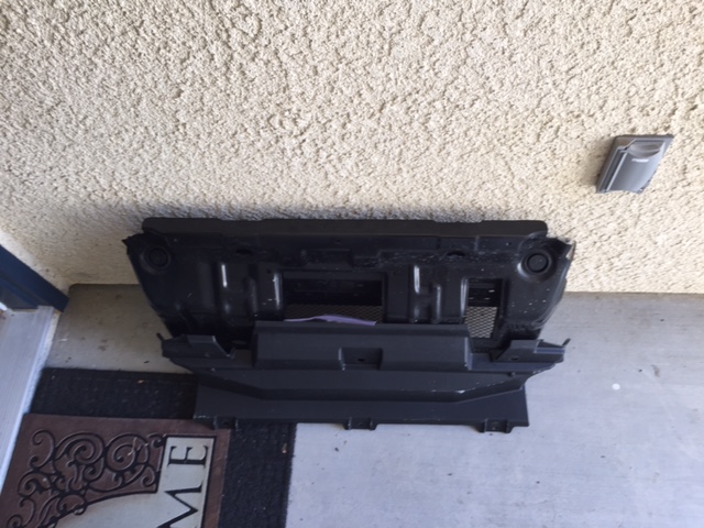

We just finished taking the 'runner on it's first long distance trip. All total, I think it was about 1300 miles. The main goal of the trip was to visit the Camelback Metal Gear shop and get a roof rack installed. Our first stop was Clovis to pick up a skid plate from [MENTION=53960]itsdchz[/MENTION] for [MENTION=106181]SoCal4Run[/MENTION]. Unfortunatlly, [MENTION=53960]itsdchz[/MENTION] wasn't around so we didn't get to meet. But he did leave the skid plate at the front door.

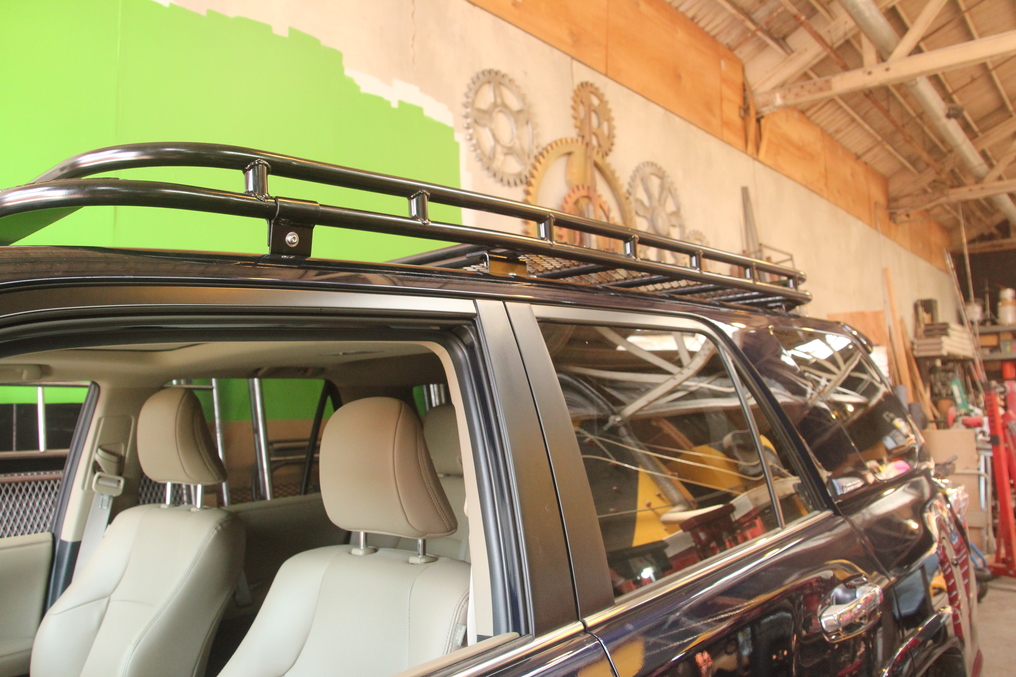

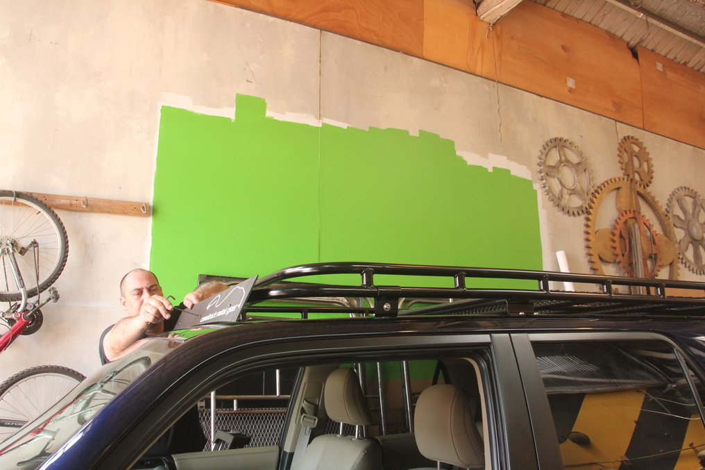

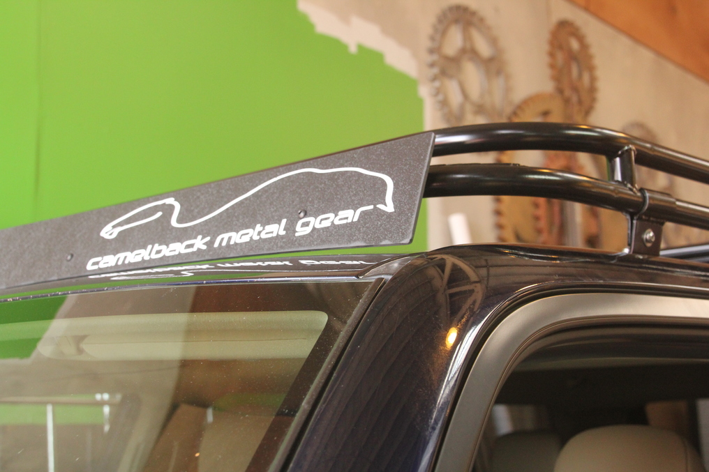

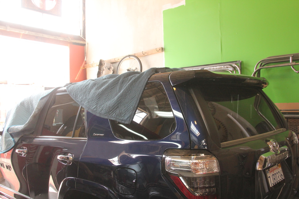

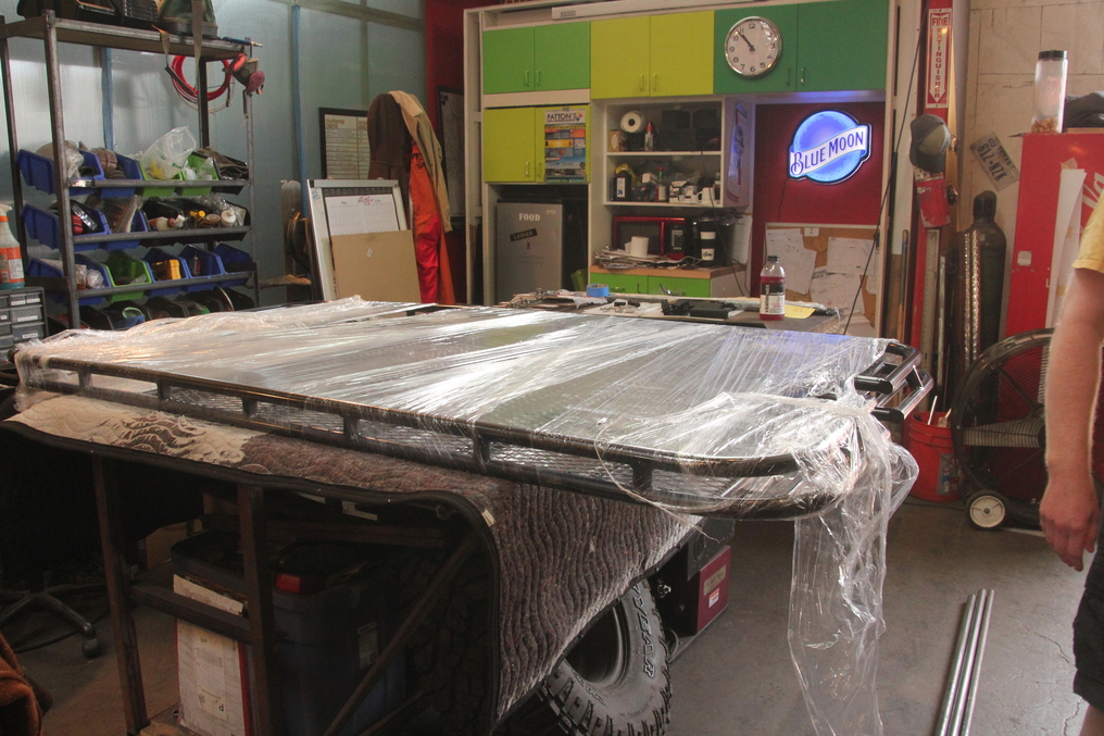

The next day we made our way to the Camelback Metal Gear shop and met Alex and his wife Manelle. They are both great people. Not only was the roof rack waiting and ready to install, but they had coffee and donuts. It was obvious that Alex really cares about providing a quality product.
Over the next couple of hours we installed the rack and chatted.
It was definitely worth the wait! I'm looking forward to the first chance I get to strap something up there and make use of it.

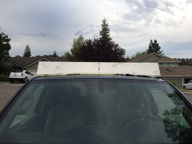

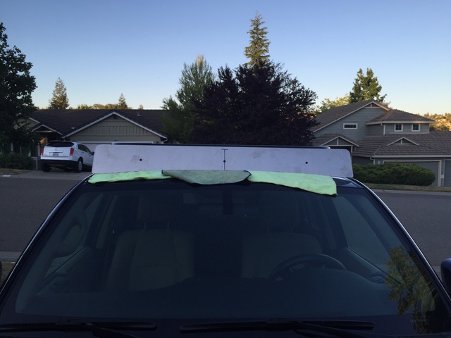

The original ABS fairing has had issues. It's slightly better with the fairing than without it but, it bangs and rattles a lot between about 35mph and 65mph. It has also started looking a bit snake like with some nice curves between the mounting points. So time to try something new.
I ordered a 12" x 48" sheet of 1/8" 5052 aluminum from an ebay seller. I was looking for the best price with the lowest shipping and it totaled about $46.
The first step was to cut the sheet in half on the table saw giving me two 5 15/16" x 48" pieces. I then drilled a hole in the center and mounted it up on the rack using just that one center mount.

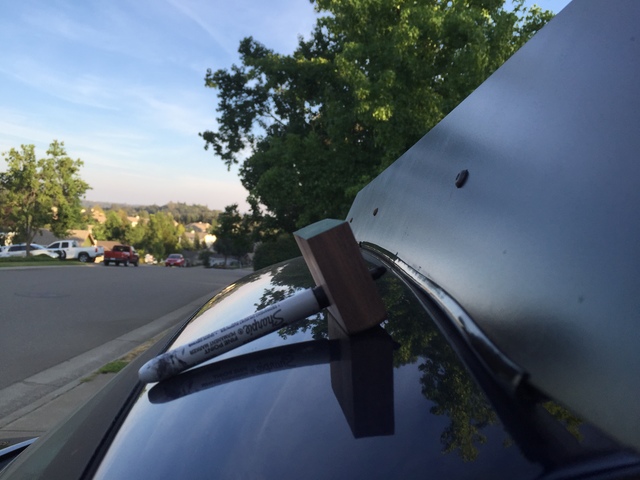

I then used a sharpie mounted to a block of wood to scribe the roof line. I cut the curve with a band saw and mounted it back up again.
My block wasn't tall enough to do this in one pass, so I made another scribe line and another pass with the band saw.
This looked pretty good so I also marked it for the other two mounting holes and started the finish work. I cut a 1" radius curve on the top corners and just knocked off the square corners on the bottom. This and smoothing out the bottom was done on an oscillating sander. I drilled out the other two mounting holes.
I then primed it and put one code of satin black engine enamel (I had a partial can of this sitting around, but only one coat's worth). I then added a couple of coats of plasti-dip to the front side. Here's the finished result.
I think I spent about 30 minutes on each step, so I probably have about 2 hours total into this. We took a trip down to Tiburon so we could bike around Angle Island and was able to test it out at all speeds up to about 80mph no more banging or rattling.

Here's a picture of the scribe block with sharpie. It's just a small block of wood with a hole that the sharpie press fits into. I did sand and wax the bottom of the block so it's nice and smooth. I don't trust that the clear coat is harder than walnut :)

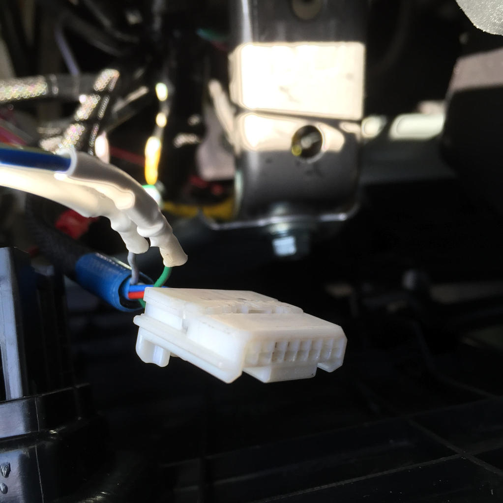

I like your solution for the wind deflector. Did you ever find out what this connector is for? I'm looking for ignition switched power for my new fuse block and was hoping to not have to add a fuse in the fuse box if possible.

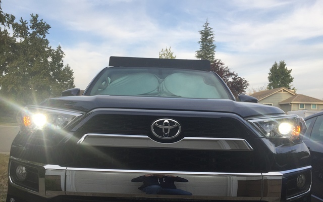

Do you have any night shots of the light bar output? I've got an LE 4X4 as well, and I'm really looking into getting a light bar in the same location.
No, but I guess I could try and get some. The location behind those slats in the grill do limit the output some and because it's set back like that, the bumper limits how much it can illuminate close to the front.
On the positive side, it's pretty easy to install one there. Access is pretty good.

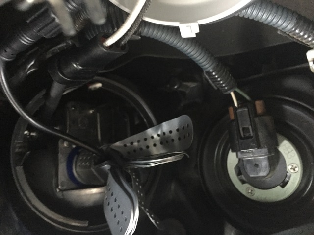

In fact, if you try, you can cram all the wires and driver box inside housing, but that doesn't leave much room for air/cooling and is not recommended. I ended up drilling a hole in the dust cover. The result is nice and clean.

How do you have the heat sink spread out in the actual housing?
I don't think mine look quite that pretty but I did try to spread them out pretty good. I didn't want to mess with them too much as I had already twisted them up some when I had the driver and wires all in there too. My technique was to fold them over into the housing and then fan them out kind of like playing cards.
I found this way pretty functional:

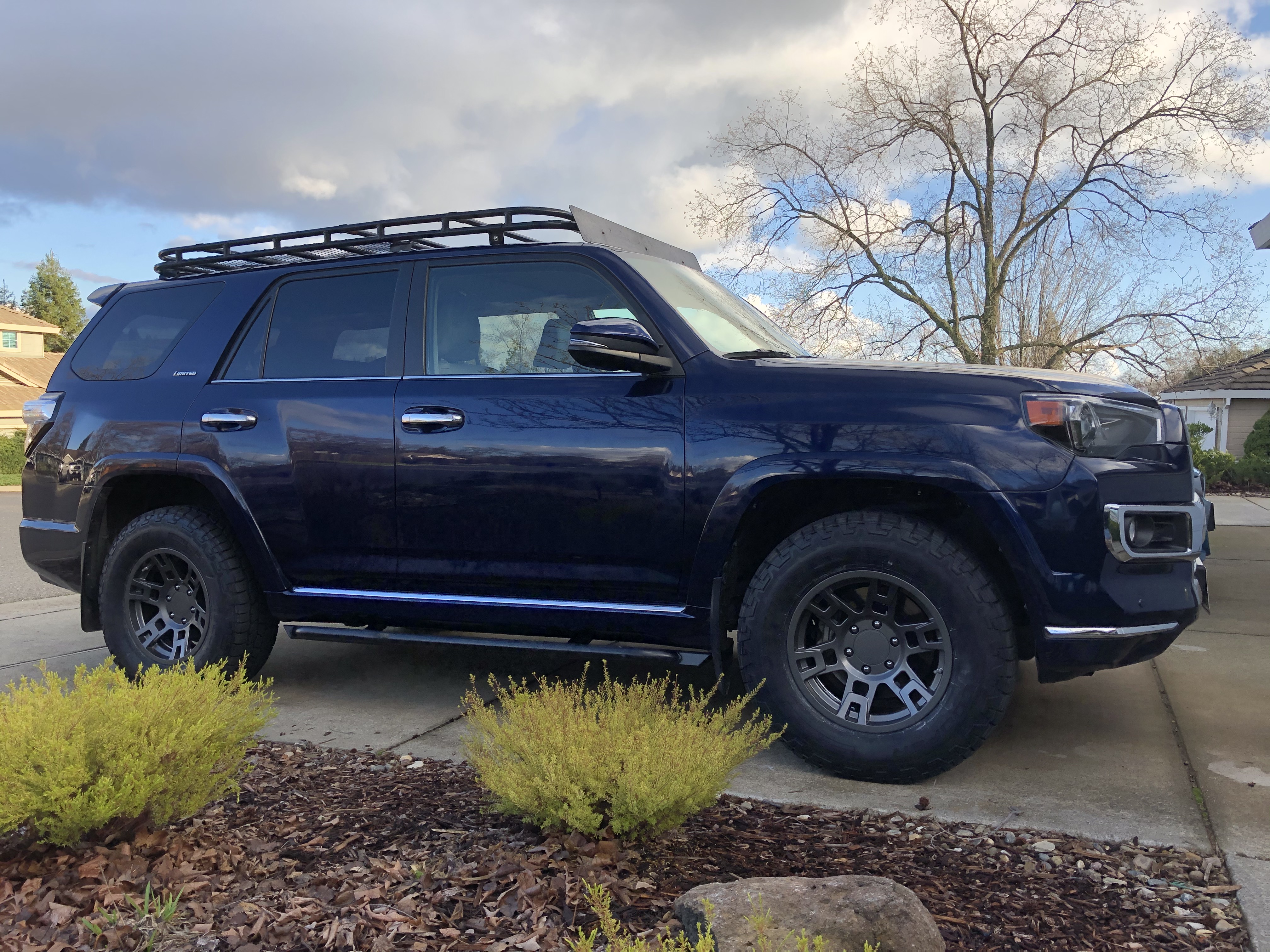

Thanks to FN Wheels and America's Tires I now have a set of f(x) Pro 17x8 medium graphite wheels and Cooper AT3 LT tires.
Much better look!
