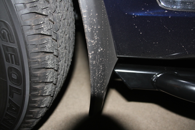

Attempted to install my OPOR sliders last night. Things could have gone better. One slider is installed, but I may be pulling it back off tonight.
The slider is currently pressing against the front mud flap and causing it to deform slightly. It looks like the slider needs to be about 1/2/" back. This is on the driver's side.
It is also not very level, but I think that can be adjusted but I did try.

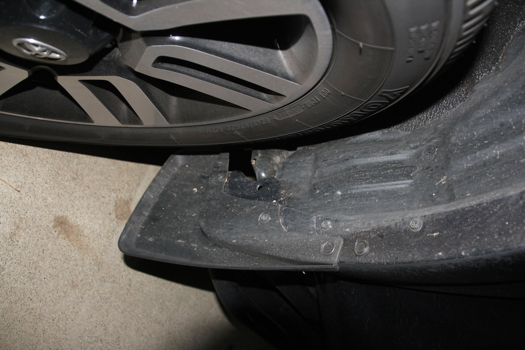

I bought OEM mudflaps for the LE but was trying to figure out how to install the front one in conjuction with the miniflaps that came with the LE ? Seems like there would be a gap in the well if I remove the miniflaps and only put on the mudflaps? Do you need to trim that miniflap or is there a better solution I am missing? Thanks!

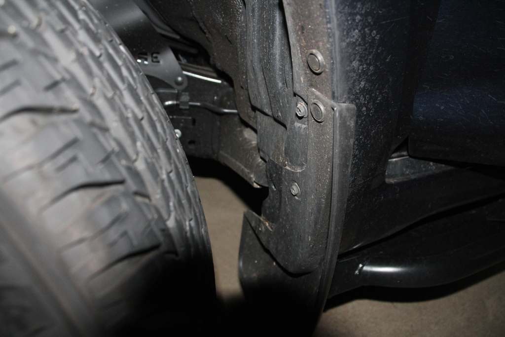

The dealer installed mine so I'm not sure. Just looking at my pictures from before/after it doesn't look like the miniflap is there anymore so I'd guess it has to be removed. Does this help any?
Mud flap install instructions
Can you get a picture of the gap?
I did not actually install the front mudflaps but I will recheck once I get the nasty stuff off the truck! The miniflap does not do much to keep snow off the running board. Can you take a pic of your frontmudguard and the wheel well? If I remember, the miniflap was attached higher than the front mudflap so if I thought if I removed it, there will be a gap behind it unless the mudflap was redesigned for 2014 Limited and I got the wrong one; I think I got one to fit 2010-2013 Limiteds at the time - I just assumed it would also fit the 2014.
Sure, I can take a picture or two tonight.
Here's a couple of shots of the driver's side front. It's about the best I can do at night and if you want/need access to the full size images let me know.
Thanks. That helps a lot. The gap does not look too bad without the miniflap over it. I guess they must have redesigned the well wheel for 2014.

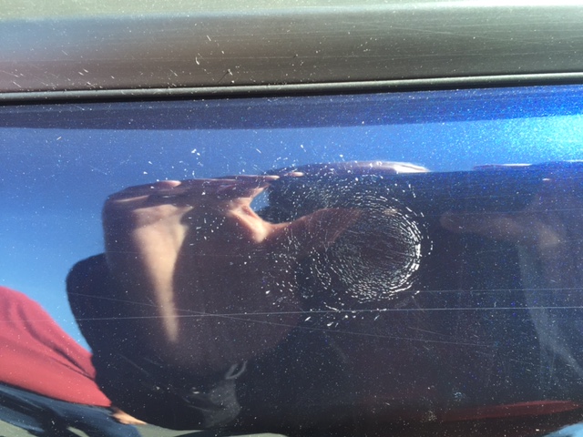

So, this happened sometime last night.
I noticed this after cleaning all the egg off the tailgate, window, spoiler, bumper. It's right below the window. I don't think it's going to just buff out.
There are also streaks still visible where the egg ran down the tailgate and bumper.

Damnit. It's hard to tell is that a dent, or the scratches visible in the pic? Either way that sucks. The scratches could easily buff and maybe a good PDR guy could get the centre part out?
Really enjoyed your build thread so far, just picked up a 15 LE two weeks ago and am following your experience with the OPOR sliders, kind of seems like they aren't really a direct fit, or do you think it was just a one-off issue with the mud flaps?
Bad news unfortunately- that will not buff out. The egg ate through the paint. Maybe your insurance will help cover it? Sorry!
