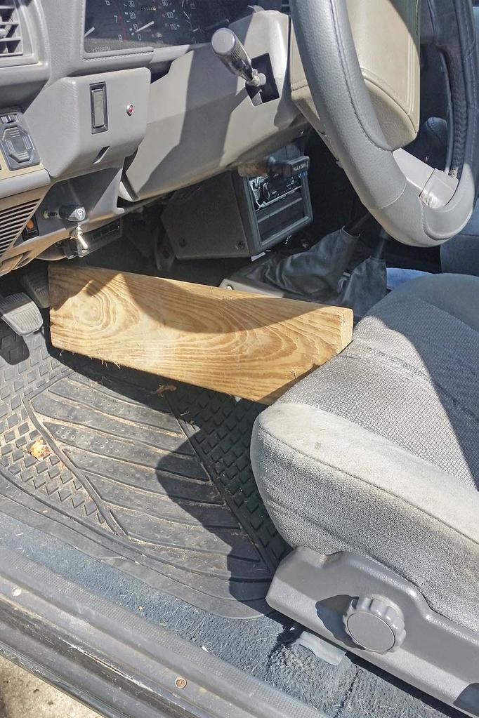

I had a leaking brake caliper and decided to put the replacement on last night. Everything went great until I had to bleed the brakes. Unfortunately I had to choose a time when my wife is out of town and neighbors aren't around to pump the pedal.. so I found a board to wedge in between the brake pedal and seat after pumping them myself.
LOL! That needs to be marketed! The New Brake Bleeder Board!
That's some McGuyvering done properly right there! You win the interwebs photo of the day today!!!:first:
Good call on that. im going to measure and cut board for my runner volvo and bmw. Thanks for the inspiration. I kept trying to wedge bricks when i didn't have anyone to press the peddle.
