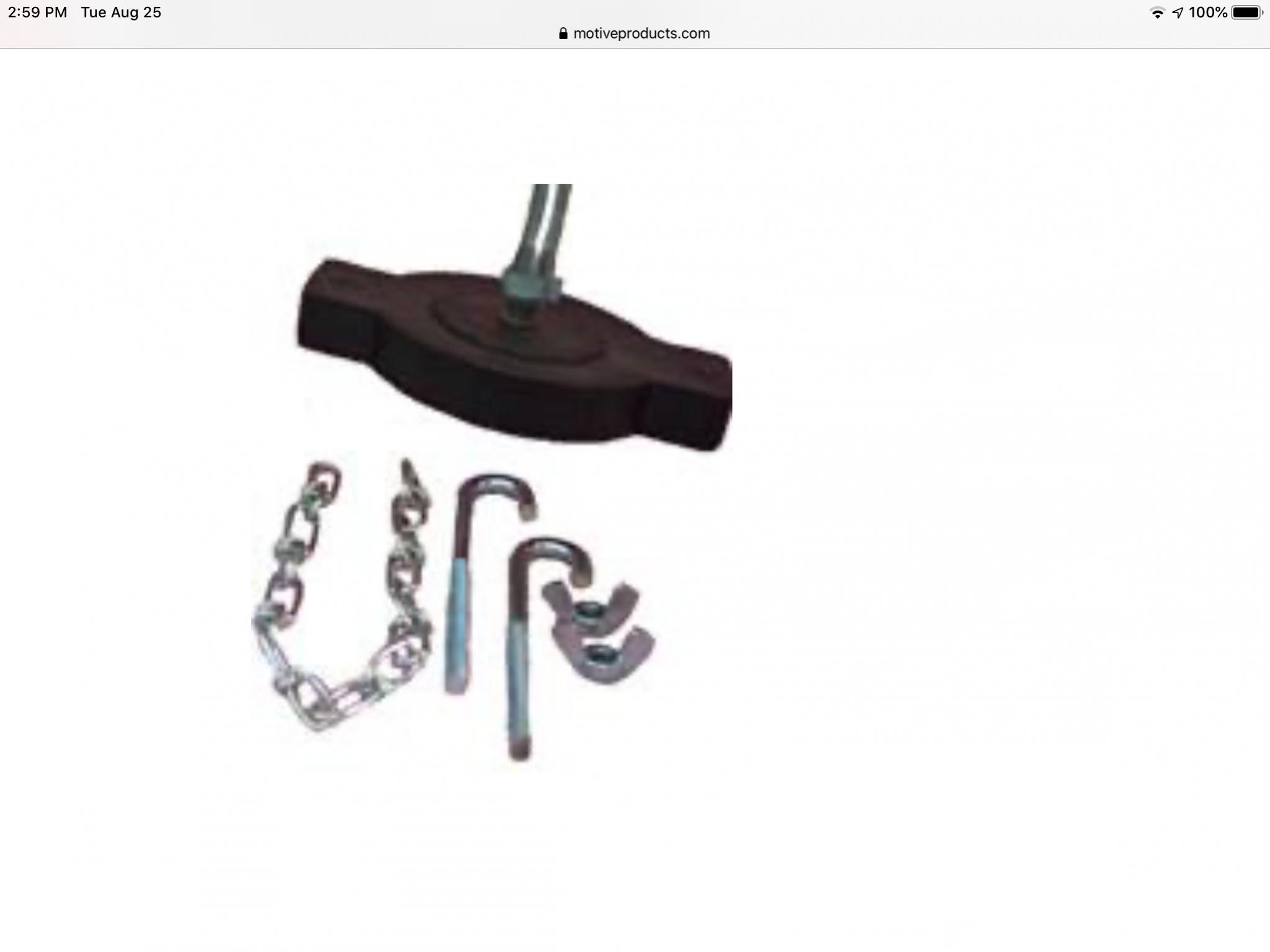

I got tired of pumping the brakes and finally bought a Motive universal bleeder kit which just has a res cap and hose with chains to secure it. I setup an adapter to connect to my air compressor. After topping off the reservoir, installing the bleeder cap, I turnred the air compressor on and set it for 14#. The starting from the rears and working forward, opened one bleeder screw at a time. Watch the fluid flow until no bubbles remain. Oh so much easier.
You dont need the pump bottle, just the adapter kit. $27
1101 - Round Universal Adapter - Motive Products
