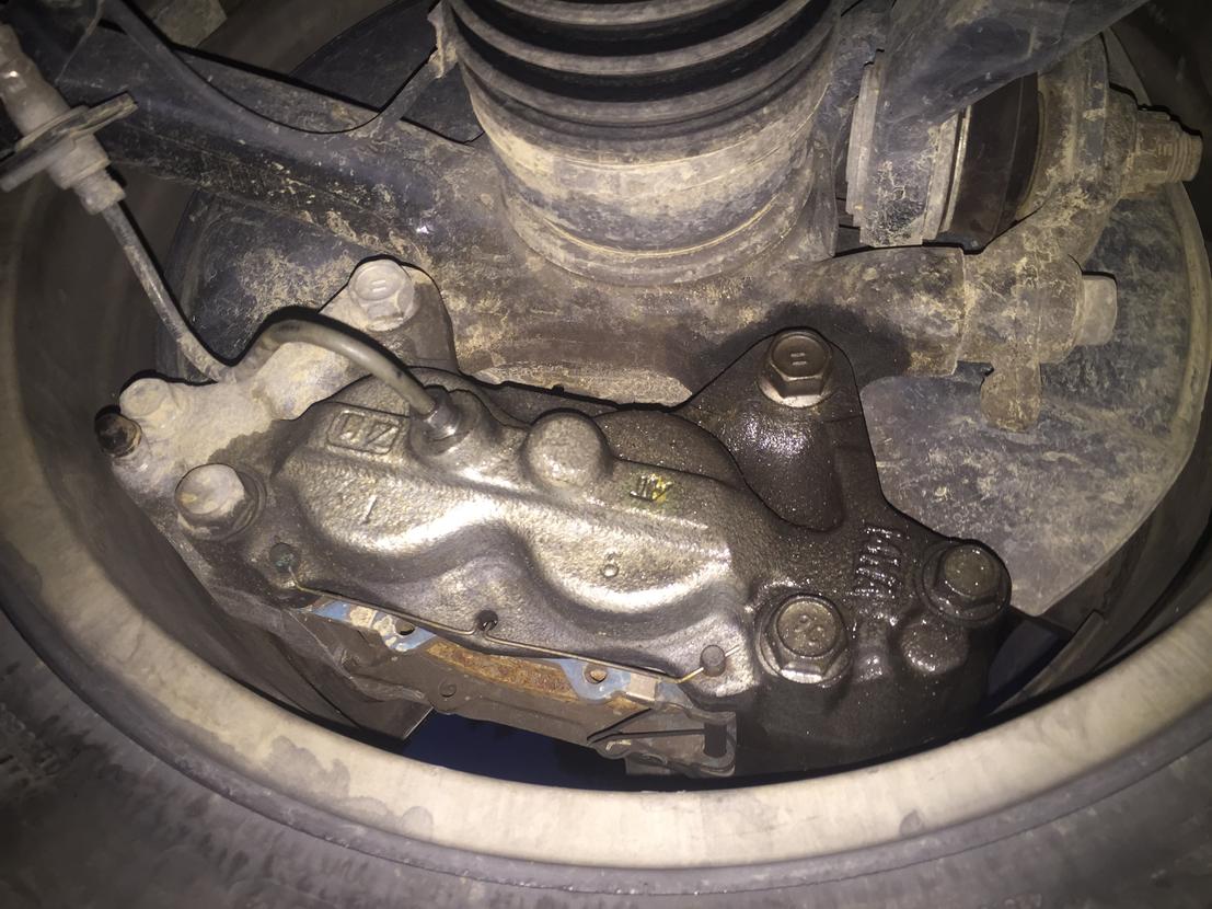

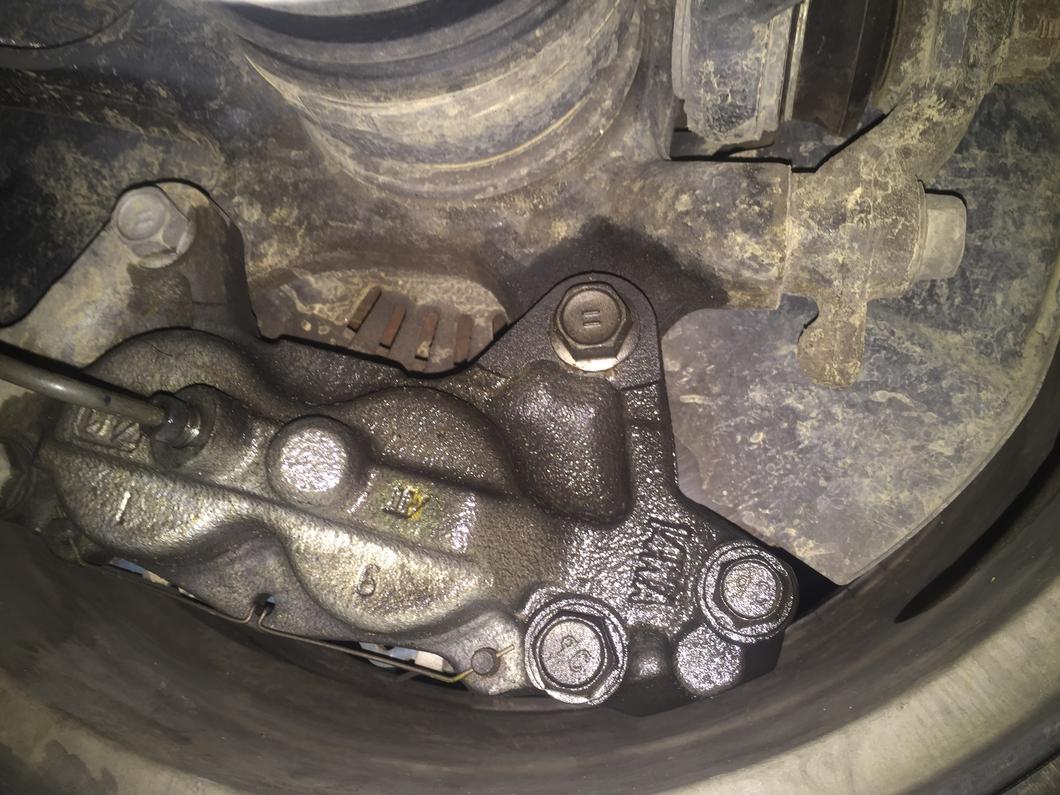

I think I found the source of the problem. Crawled under the vehicle tonight since we haven't had rain in several days and the front driver's side caliper is covered in fluid. I thought brake line might be loose coming into the caliper so I grabbed an open end wrench and tried to tighten it up....it moved a hair and thats it.....so I think the caliper seal is the problem. I cleaned the whole thing off with break cleaner and I'm going to check it each day for the next few days to see if I can replicate the caliper being covered in fluid. Tried to upload pics with my phone but the site keeps kicking me out when I try to do that.

So the brake line and bleeder screws are tight? Is the rotor covered in fluid and/or shows signs of overheating/slipping? I'm curious where it's leaking from. If you can get us some good pictures that'd be nice; I'd try to take a look when the wheel is off if you can.

Here are the two photos that I was able to take last night rather quickly.

Are you sure it's the caliper that's leaking? From the photos I'd guess the leak was more likely to be coming from the compression nut on the hardline.
I honestly don't know. I did tighten the nut on the hard line last night and it did move a bit when I tried to tighten it. I stood on the brakes this afternoon several times and crawled underneath to look and haven't seen any fluid nor could I feel any.
I think I am going to keep checking it every few days to see if it comes back. If not I will call it the hard line but if it continues I'm pulling the caliper and replacing it.
