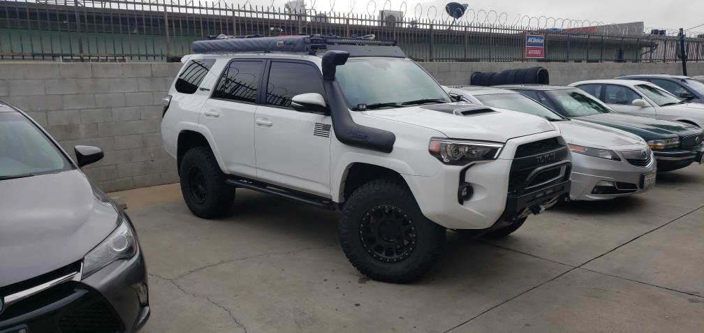

5 gen 4 runner with 295x70x17
Icon stage 7 kit
My brake padel travels down a lot befor brakes are on, I went to the dealer they said it's normal
I replace the rotors and pads with ebc green stuff and slotted rotors
Also had the dealer flushed brake fluid and replaced with race fluid
Still no change.
Anyone know of a brake upgrade kit with bigeer calipers?

I do realize that using a bigger tire would take away from my breaking a little bit however I've had that problem even when the car had stock tires

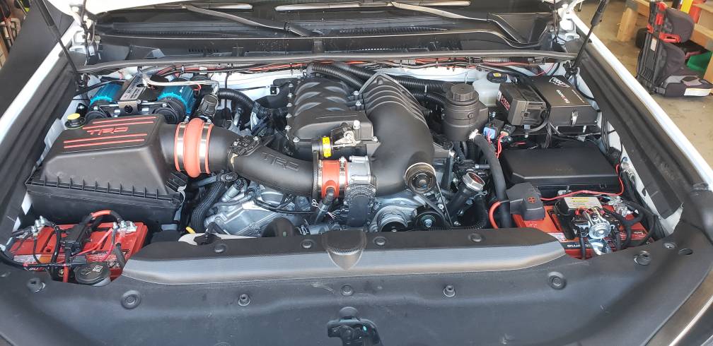

Edit: just saw your pic with Supercharger. This can add to heat soak problems. Especially with Stop/go traffic. How much do you weigh with all of the mods? Have you upgraded the cooling system?
6000 lb
Have not upgraded cooling system
