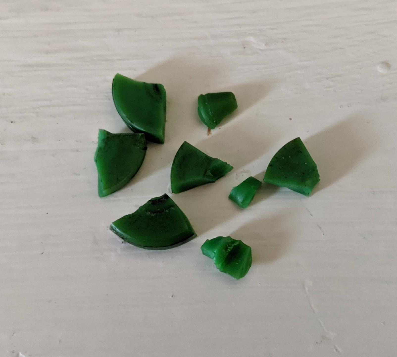

There is small brake light relay switch behind the brake pedal, underneath that is a bracket that houses a small green plastic stop Which the relay hits when the pedal is compressed. Well after several thousand compressions they brake, I found little green pcs on my floor mats just after I noticed the lights were stuck on. I simply super glued a neoprene washer to the bracket, WaLa lights off, you can find them at any Hardware store.
