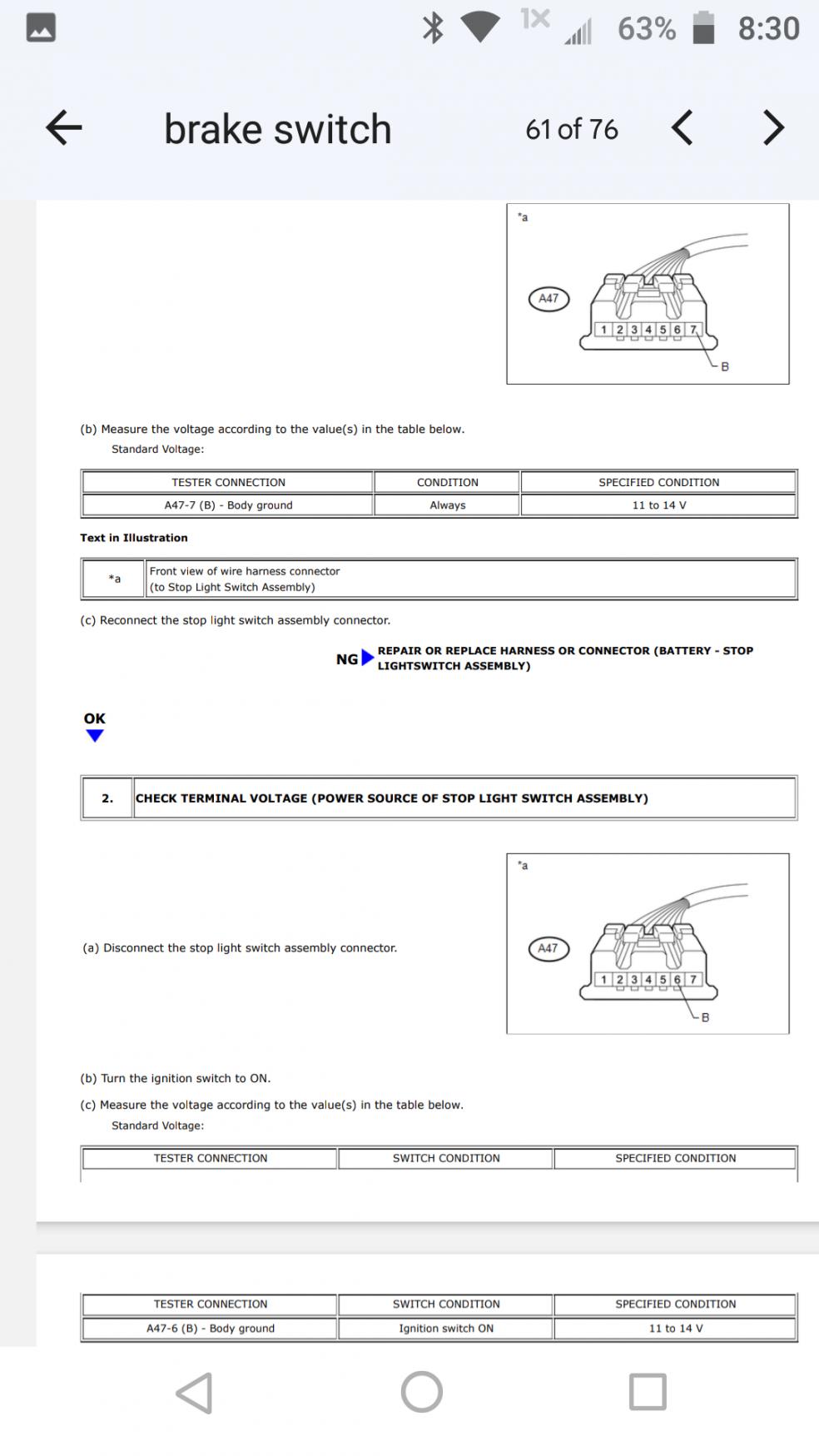

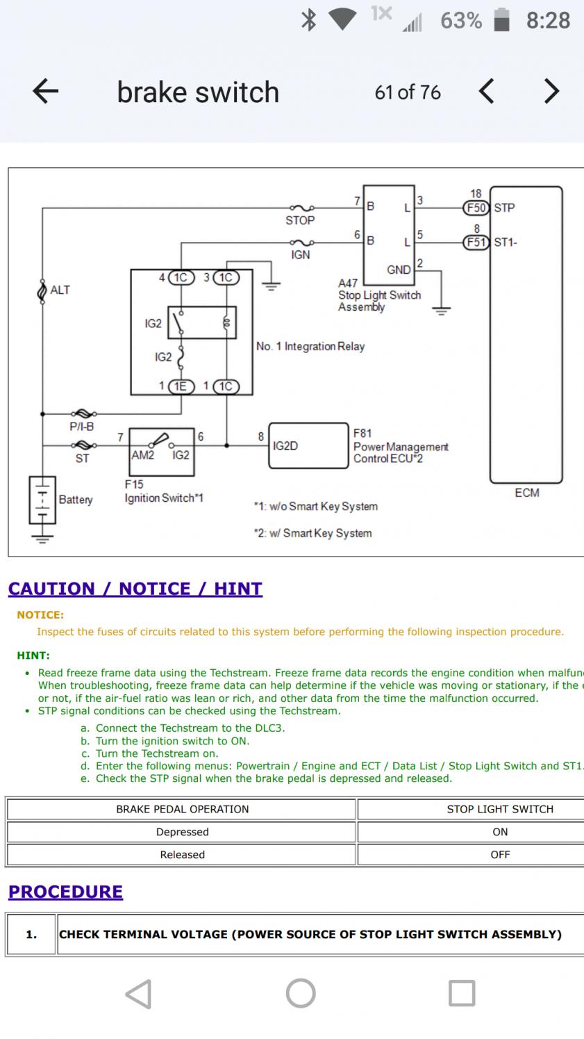

Do you understand the diagram of the circuit the switch is on that I posted? It tells you everything you need to know. I would have told you it probably wasn't the switch since it was actually working but kind of in reverse. It literally takes a couple minutes to test it for continuity while pressed and depressed that would have saved time and you buying parts. Notice the circuit includes a relay that interacts with the stop switch when the ignition is turned!! Do you have a multimeter and a test light. They cost less than parts and you can diagnose pretty much anything with 15$ in simple tools. Most the time it's not even the part but something simple within the circuit.

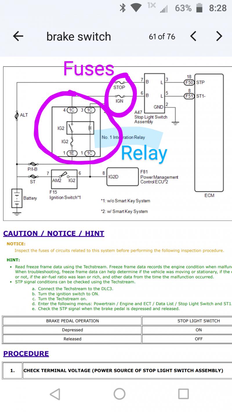

I understand. I learned the first time also. It pays off big time! First check the fuses I circled visually. There is a relay that I suspect is the issue circled. You can test it with the tools I mentioned if you like. Do you hear a click with the ignition on but not started when you touch the pedal? That's the sound of an energized relay. That doesn't mean its not bad but you can test it further like I said. Use a test light or multimeter to check for battery voltage at the stop switch and check your ground there also with test light. Power to ground. Use the diagram to find the proper terminals to test. Hollar back young one!

ok, so you suspect the relay is the fault, not the switch. is this relay highly visible and easy to access/exchange? would this also trigger VSC dash lights?

Well, I’m going to retract what I said earlier. It is very odd that it happen when the ignition is on but not when it is off
If the wire diagram someone posted above is correct, you have power coming from the battery and from the ignition. Makes me wander if something has broke inside the switch which the power from the ignition going into the switch is completing the circuit.

you may have missed the update, but i did buy a new switch, same result. the suggestion is the relay is bad, so i suppose with the ignition on, but brake pedal not engaged, electricity is flowing to the brake lights.
i believe with the ignition off, the brake lights get their electricity directly from the battery. with ignition on, they get their power through that system.
