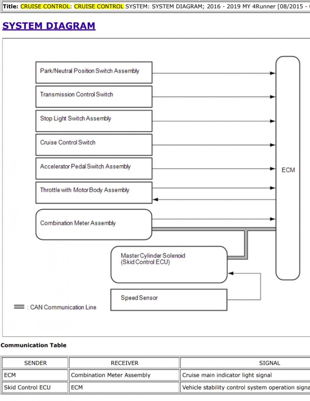

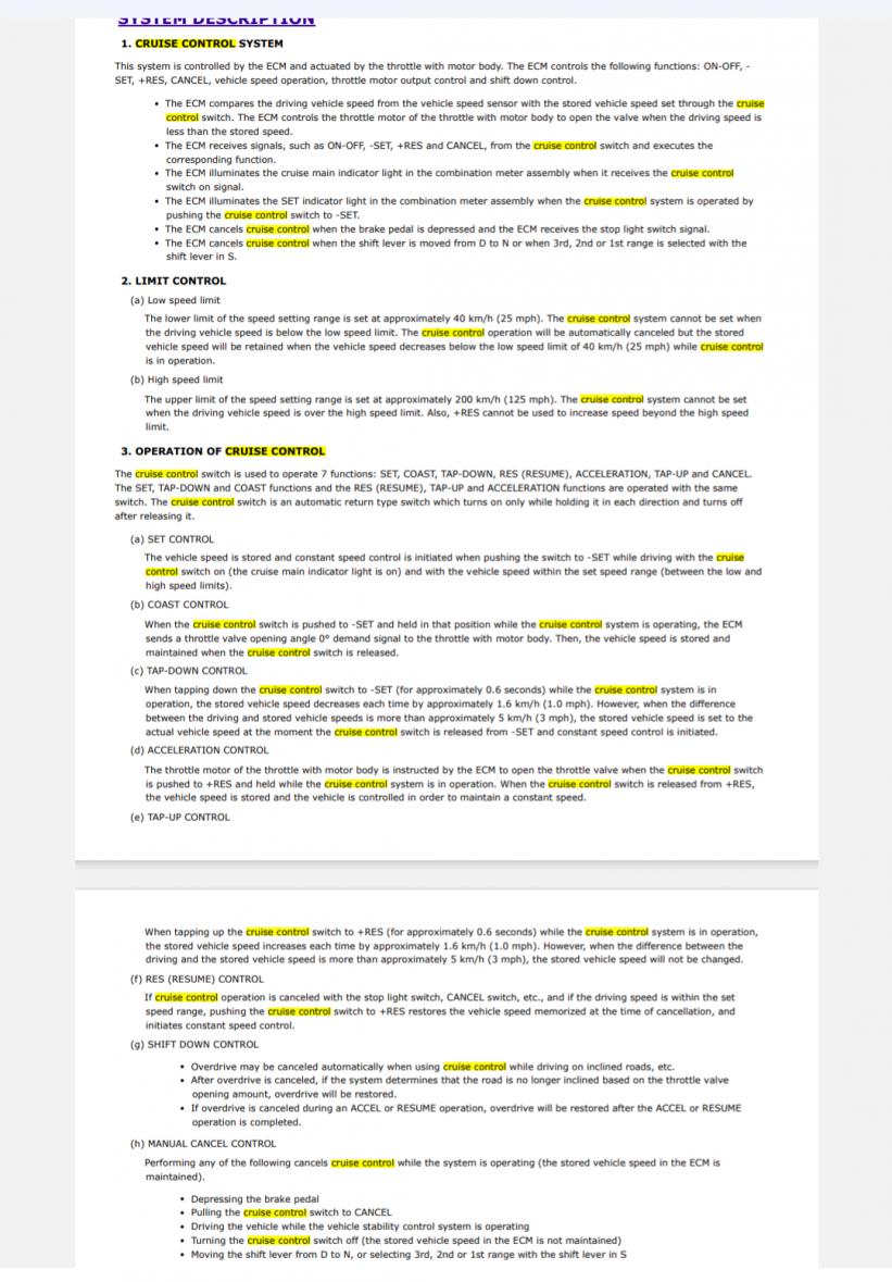

Really weird your cruise control is working properly because it works through several sensors including the stop lamp switch received by the skid control ECU. Cruise control should be cancelled when the skid ECU receives brake stop signal.. I think the dealer just confused this sh1t even more and should have provided you with all the DTC codes not just the few on one circuit. F_ckery..
This information below should help you understand much better what you may be dealing with. All your issues seem to be related to the skid ECU. When you pull all the codes hopefully you will find one that is a single simple input to fix all your problems in one go and not need the new ECU.. this is all free.. private message me if you need procedure help..
