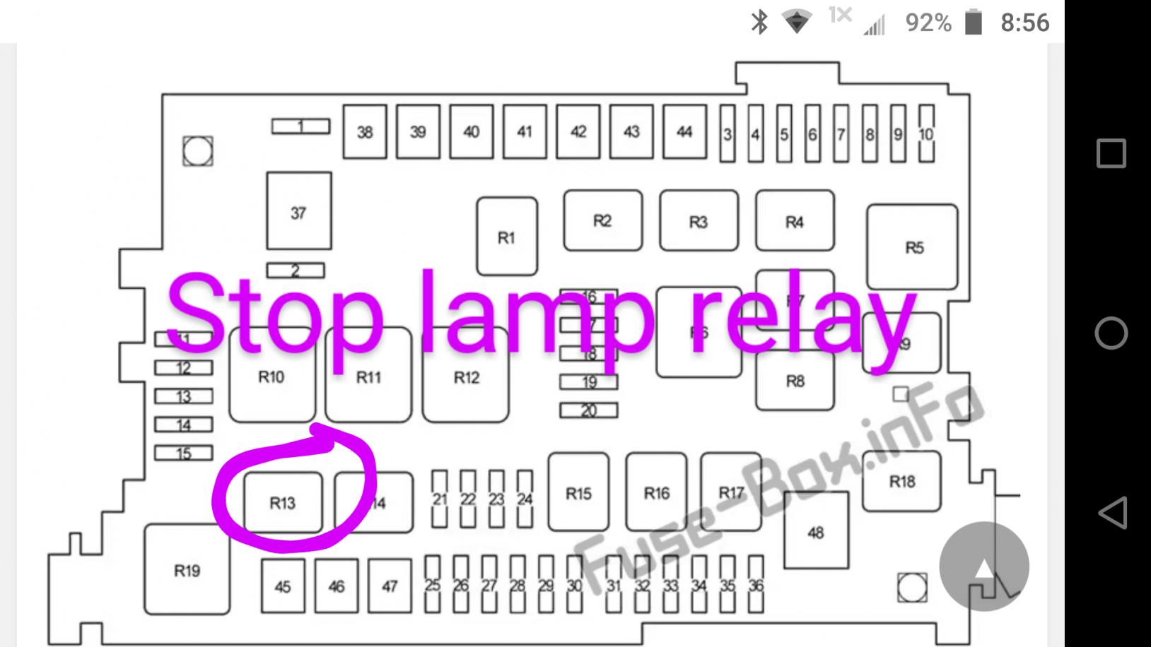

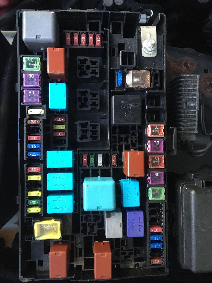

One last post tonite: ran outside, took a pic. I believe the relay you mention is the brown one (can’t download from my phone!)
My 5th gen is a little different so I'm not sure about color but your diagram should match. Unplug it and test it in the warmth. On the right track!
ok, pulled the R13 relay. brake lights inoperable, as well as VSC dash lights did not return upon start up. suppose only option is to source a replacement?

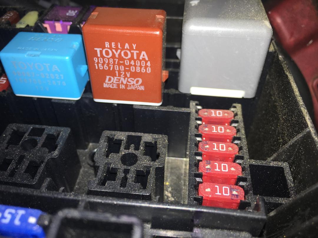

for reference: superseded part number for that relay is 90084-98032. about $45 discounted. it isa denso part, maybe direct buy?
jumped on ebay, ordered a used superceded relay with a 1 yr warranty and tested for $10 shipped. better than gambling on a $50 part.
Well you need the relay plugged in for the stop lights to work. It's a switch. That doesn't tell you if it's good or bad. You need to test it before you buy another part dang it. Hopefully that's the problem though.
