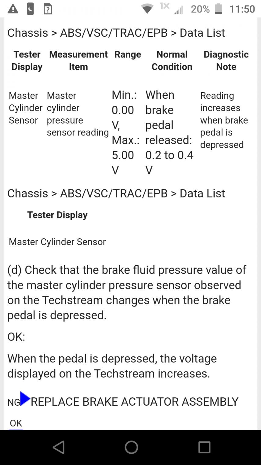

Your diagnostic shows a C1246 code. Should the tech not have performed this diagnostic?? To determine or verify communication from PCM/ECU to skid control/abs module...
C1223 is an ABS Control System Malfunction and the C1246 is the Master Cylinder Pressure Sensor Malfunction.
I would manually pull ALL the codes also to get a better idea of what's going on. There may be more DTC codes related to your skid/abs modules inputs/sensors than just the brake lamp switch with can cause it to disable your abs related functions.. Like I mentioned earlier he only followed the flow chart for the stop lamp switch..

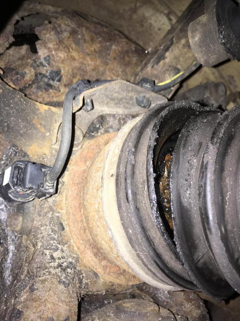

and, i just found another flaw in the visit. i was under the car looking at the speed sensors. at the front, looking at the right (passenger) side, i see a bad complete tear in the outer CV boot! i go back to the multi-point inspection page, and the drive/cv shaft is checked GREEN! how did he miss that?? same person doing the diagnostic? broken plastic cover? confidence is going down, not up.
i bring this up because it shakes my confidence in the $300 diagnosis and finding.

C1223 is literally "Hey, I have an issue in the ABS/VSC/TRAC system" much in the same way the ABS module sets a C1201- Engine Control Malfunction when the check engine light sets, regardless of what actual problem the ECM has. It's a DTC that directs you to the trouble module, the FSM literally just has you go"Is there a C1223? Check ABS System for other ABS/VSC/TRAC DTCs and diagnose those first." It's slightly more useful that the P1604-Startability Malfunction that every damn Toyota sets and literally means nothing and almost every car has it stored.
So you'd basically just disregard the C1223 in this case because we already know the issue is in the ABS/VSC/TRAC system, so you'd just look at the C1246-Master Cylinder Pressure Sensor Malfunction issue. If you look at the troubleshooting tree for that DTC you'll see that listed as possible problem areas are: Master cylinder pressure sensor, Master cylinder pressure sensor circuit, Stop light switch circuit, Master cylinder solenoid.
Something to note is that the reason the Stop Light Switch Circuit is a possible trouble area is because the Skid Control ECU is using the brake switch signal fed to it via the STP pin to verify that pressure changes match what it should see against it's internal table when the pedal is pressed; if the circuit is faulty the Skid Control ECU doesn't know that the pedal is being pressed and thus cannot be sure that the pressures and/or sensor are accurate to what it should see.
That coupled with the customer's original concern regarding the brake lights always being on would mean the best place to start and rule things out is the brake light circuit which is what the technician appears to have done. In the course of that diagnostics they determined that the Skid Control ECU is faulty per their checks.

Ouch, hope you're ready for new CV's too. I replaced mine at 100,000
just checked my repair records (i write a quick check summary as well). that axle was replaced by a local independent at 199k miles with aftermarket. original lasted 199k. gonna have to check on warranty, only good thing about aftermarket is sometimes long warranty.

Not to be the bearer of more bad news but it also looks like there’s a decent sized rust hole in the frame.

thats not a rust hole in the frame, it is a rusty hole in the brake dust cover! thx for scaring me...
That’s a lot better than the frame! Couldn’t tell from the angle.
I thought the same thing for a second when I first saw the photo, but then I realized what I was looking at with the CV boot there and then it either had to be big rust hole in the brake dust shield or it was a big rust hole in the front differential which would be worst then it being the frame. LOL

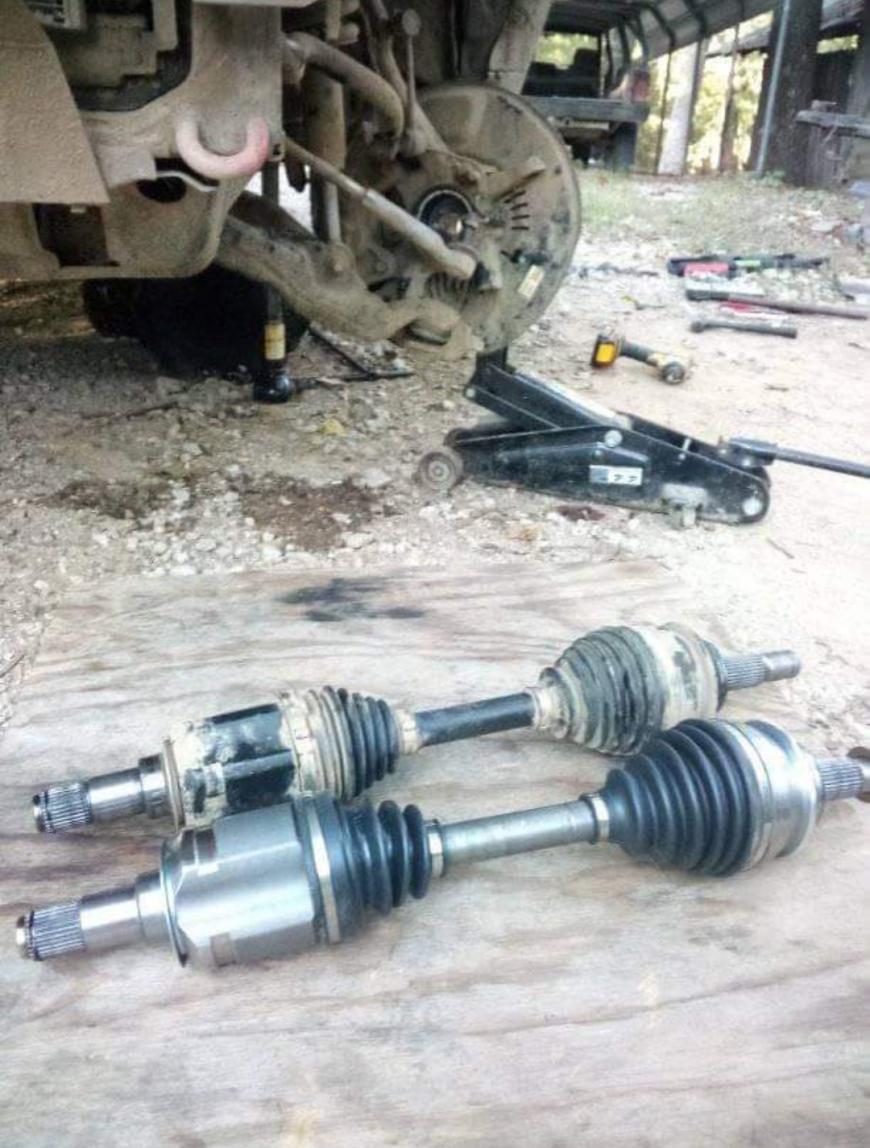

OEM prices are f$cking stupid. Boot replacement, looks a little late for that. Did mine myself for $120 in an afternoon (both sides). A1 Cardone axles. Same boot material and boots secured with method exactly the same as OEM.. figured I can buy ten sets of these for the price of one OEM set.. off roading the f_ck out of them for a year now, no problems.. kept my OEMs for trail back ups and extra boots just in case. DIY
i see lots of mud/dirt there, rather than rust possibilities from 15 years up north. looks like you need to detach some suspension components. mine was done in 2018/30k, so perhaps that would make it easier.
i think mine was cardone. shop said they are remans, with 1 year warranty. can't see how they compare the OE's, which lasted at least 150k under same conditions. indie says they now use another supplier with non-remaned with a lifetime part warranty.
