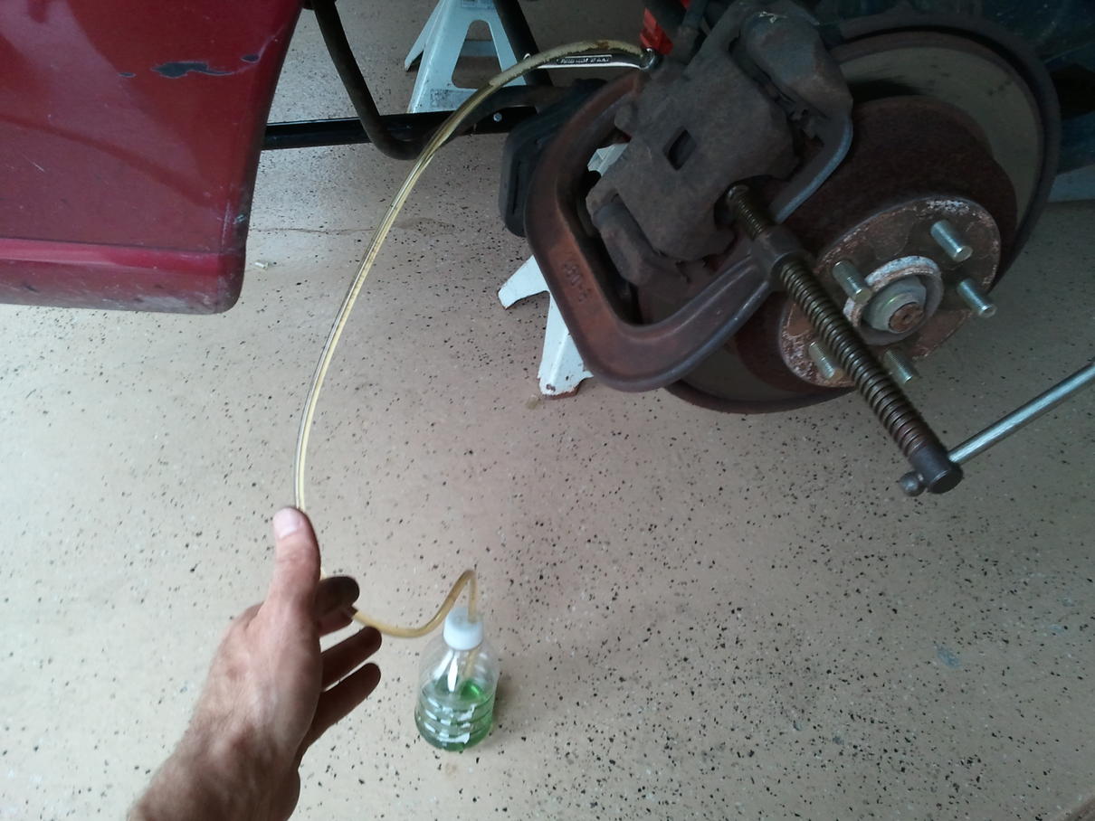

I use a bottle and clear tubing that fits tight over my bleed screw. I always get a bit of air and dark fluid, the fluid in the caliper gets funky over time, I don't like sending it back into the ABS valving. Good to get it out of the system.
The green in the bottle is Pentosin 7 from my mountain bike brakes.
I'm not sure what size this hose is, .170" ID I think. I have another bottle set up with 1/4" hose that works on bigger bleed screws. The tubing is from a hardware store, I picked up a few feet of various sizes to have around for stuff like this, kids projects, fish tanks, whatever. The bottle cap is drilled to fit the hose tight, with a tiny air hole next to the hose. That keeps it from spilling when it falls over.
I've done my rear brakes, planning on doing the fronts on the 4R for the first time over the holidays. This pic is from my son's Impreza, you can see the bubbles coming out.

Brake fluid does pick up moisture over time and this will lead to a spongy pedal and reduced response. The fluid in the caliper will pick up the most dirt, and moisture, so it is good to get that stuff out of the caliper if possible. Just remember if you crack the bleeder, it is good practice to bleed the corner that you are working with before you finish.
That said brake fluid should be fully flushed periodically anyway, so if you are up on your maintenence, it is not a big deal to push the fluid back up into the system without cracking the bleeder. If the fluid is cloudy in the reservoir, it is probably time to flush the entire system anyway.
