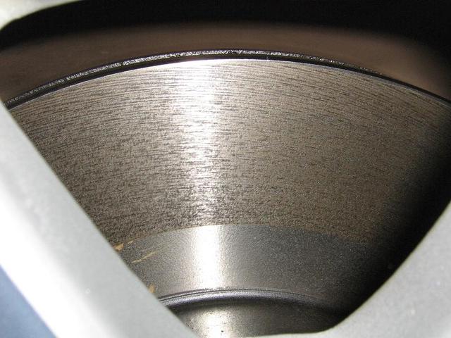

PS: Here's a picture of a nicely bedded rotor, about a month into use, which shows no pad imprints. I think you may recognize the source of this picture. :)
