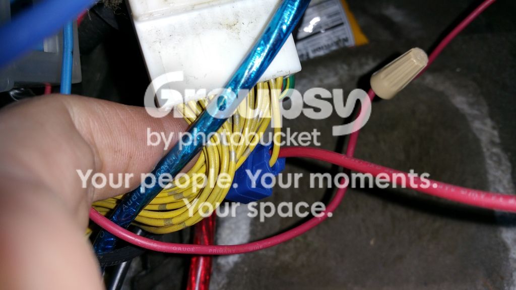

Ok...so I was using the picture of the kick panel calimobber posted and even read the link that was provided. The problem is my 2001 looks a lot different than the 97 4R. In fact, here is what mine looks like:
upload_-1

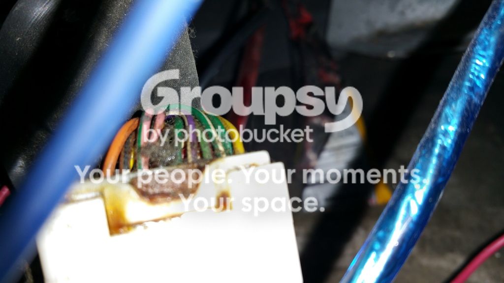

But if you notice, I was able to track down the green and white brake wire.
upload_-1
It was still a tight fit on top side of that connector but the bottom side the yellow wires had plenty of slack so I used the one that matched up with the green and white.
upload_-1
Truth is it took longer to find the green/white wire than it did to wire it up. Hopefully this helps any 01-02 4R drivers out there trying to wire up their brake controllers.
Got it hooked up today. Thanks for the idea of hooking it to the corresponding yellow wire. Much easier.

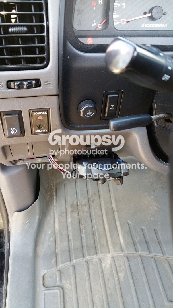

Some more pics for people.
The green and white was the second from the right.

I plan on mounting my controller on the other side of the steering wheel. I banged my knees enough times when I mounted the controller in the same place you did too many times when getting in the truck.
