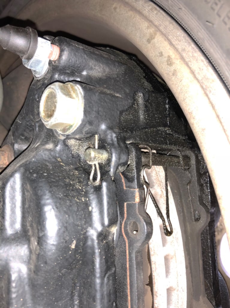

I have noticed a very small amount of brake fluid at the seam of both sets of Left 231 calipers like it’s forcing its way out the top of the caliper on the one side. Tightened and re-bled with no change.
