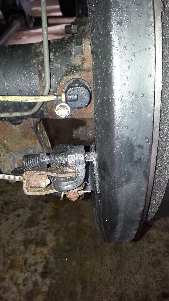

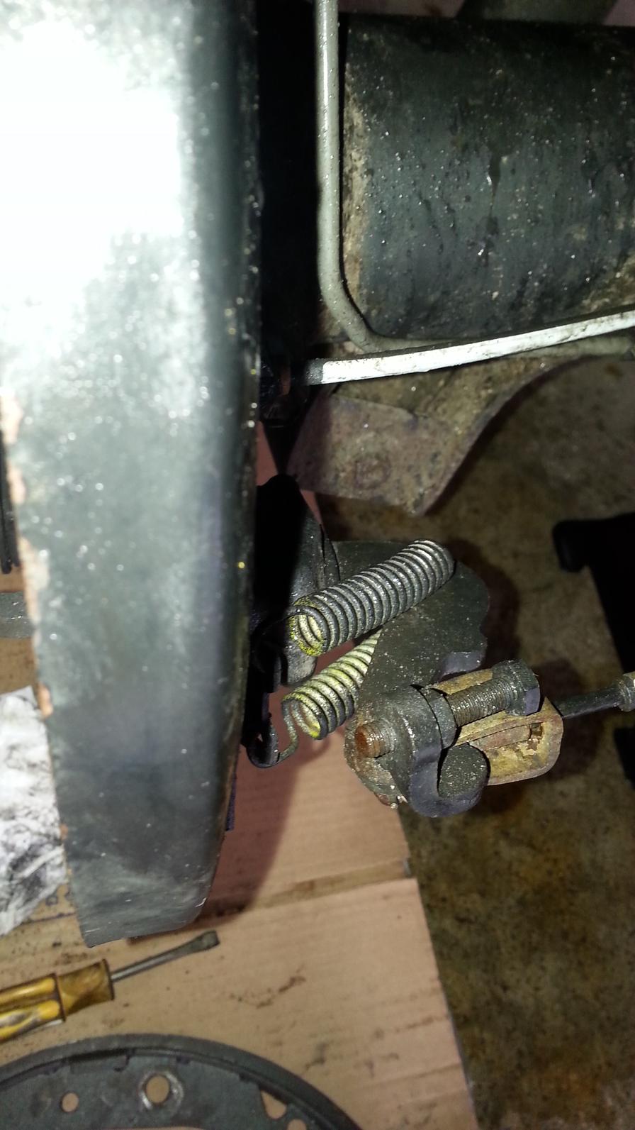

Here to pics of my rear bell cranks, one seems to seized, the other one seems to go back to rest correctly.
Do you think I should remove and repair both, or just the one which is not returning to rest ?

So -
I disassembled one bell crank, holding the assembly in my hand, - the bell crank arm with the boot still on it, no parts are able to move. Meaning, there is not pivot or any motion at all.
I assume this is not right ? meaning, should I be able to move the arm left/right ?
It should be free to pivot. I would lube both of them starting with the good one. Look closely how it should work then re-lube it and reassemble.
Now when you pull off the seized one, you will know how it should work and be able to determine pivot points that no longer pivot.
I'm not sure how to go about this and get any longevity.
Both mine are seized but it's an auto and I don't use the hand/parking brake.
I do have to do my rear shoes and I think I'm going to pull them out and then take off all the rust I can with a wire wheel and then use some anti-seize compound on the pivot surfaces when I re-assemble.
I've heard it said to fill the boot with grease but petroleum based grease will cause the rubbers to deteriorate over time so it should be a silicone based grease or perhaps something completely different?
Just not sure yet !
