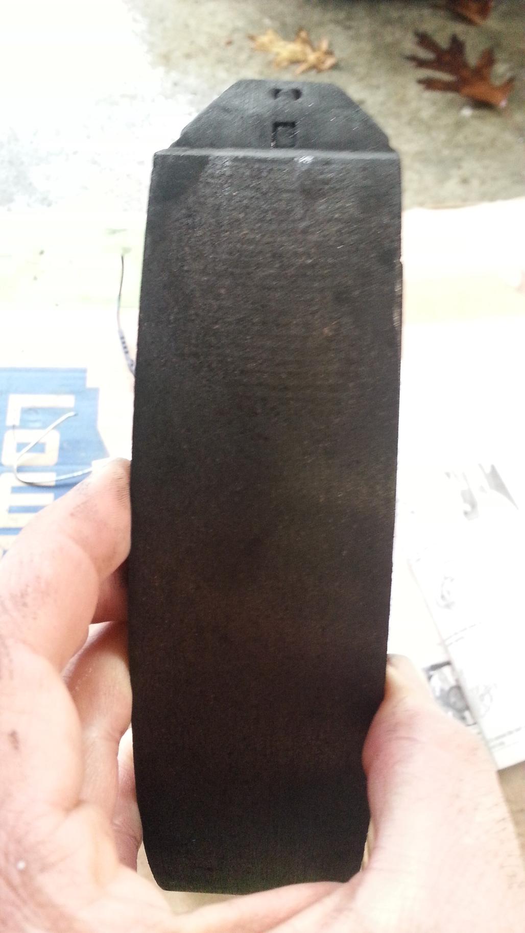

Follow up question here:
As you know, the shoes were 'stuck' onto the drums, and had some excessive wear, both drums and shoes are new (less than 300 miles on them). - Both rear .
I noticed this wear on the top part of one of the shoes, I assume it's nothing to worry about - just making sure that the 'grit' showing on the upper side of the shoe in not excessive wear which may prematurely hurt the drums.
Thank you.

That uneven wear on the shoe wont damage your drum if they are not functioning properly. If you paid that shop with a credit card, your best bet would to open a dispute with the cc company.
