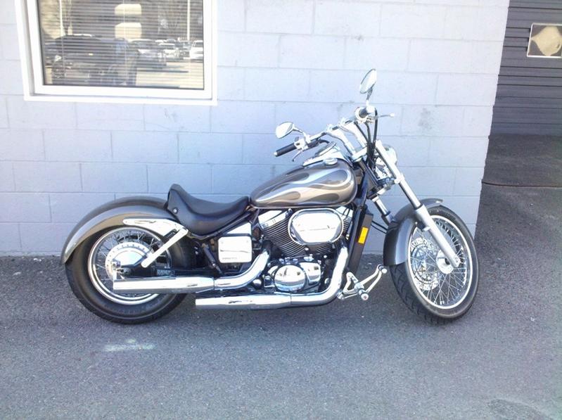

If you are serious about getting a bike, sign up for the Motorcycle Safety Course. It gives you the basics of riding, lets you drop someone else's bike before you practice on your own, and lets you get your full license upon completion. My wife did hers at Thomas Nelson in Hampton, but they probably have a course down there too.
That sounds good. I know the DMV near me does the motorcycle safety course. I know you don't have to worry about the permit. I will look into that. My girlfriend was worried about me getting hurt on a street bike but as long as your a defensive driver, your odds are as good as anyone else.
The DMV doesn't actually do the class, they are put on by private organizations. They administer the road test if you have not taken the class. I can't seem to find anyone offering the class in VA Beach, so here is a link to the class in Hampton.
