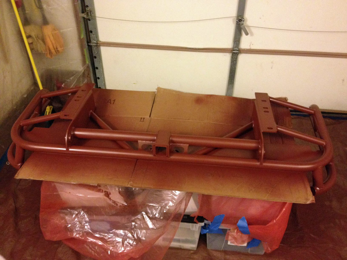

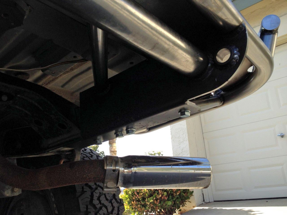

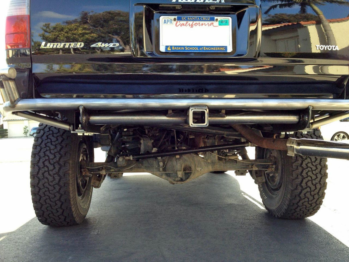

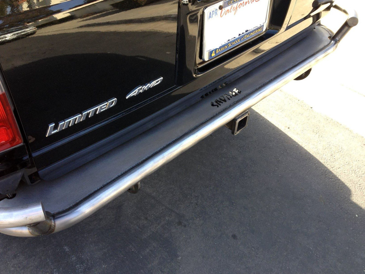

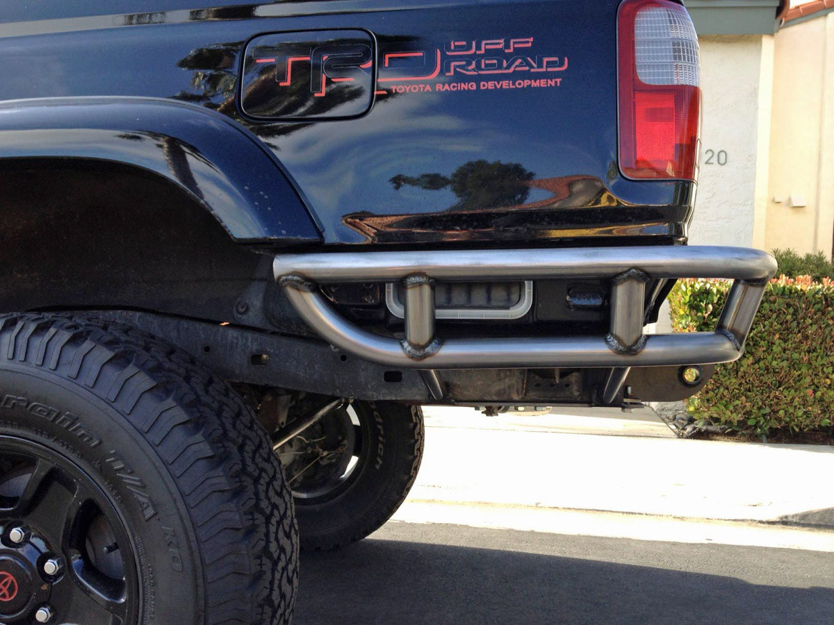

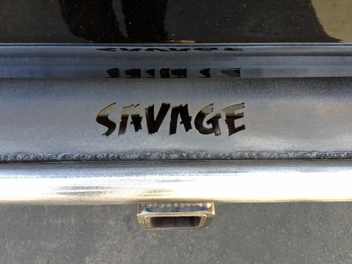

I picked up my Savage Offroad rear bumper today in Riverside. The owner was very nice, installed it for free and I was glad to see that it fit perfectly. Now it only needs to be painted.
Gas mileage back from Riverside on Cruise Control @ 70 MPH = 19.4 MPG!
Time to paint it
I setup my garage for painting (this actually took a few hours) by tarping the floor and walls. Then I put on the first two coats of primer on the bottom side.
I bought 3 cans of Home Depot metal primer and 3 cans of Satin black.
I will also be buying 3 cans of SEM Trim Paint - Satin Black tomorrow, assuming TCP Paints is open in on the Holiday.
My plan is to finish primer coat on the top side tomorrow morning; then put on a coat of the cheap satin Black; let it dry; lightly rough up the surface; followed by coats of the(much more expensive) TRIM Satin Black; let it sit overnight to dry before installing after work on Monday.
Pics to follow.....

So I'm a little disappointed though... You can't say you got the bumper installed, then NOT post pictures.
WTF? :nono:
WTF?
LoL ... I was waiting for them to come through my gmail. I took the pics on my iPhone since it is just a simple update...
Thanks for the eLocker advise btw! I need to do that. Mine stopped working about 6 months ago I haven't given it much thought.
:thanks:
I see pictures, and I am happy now. Looks great so far man, I'm looking forward to seeing some overall shots once it's fully painted & installed. I've always liked that bumper.

well i'm curious of how it will turn out. I know for a fact I will like the tube bumper look..even more if it had a swing out. u can always sell the arb and get the AoR bumper for not to much more! awaiting final pics though
Nice moves Brian. Good luck on the E-Locker fix when you get around to it.... with the help from this forum you should be able to fix it no problem.
Nice work on the bumper! I've been waiting for this specific post after I heard you were going with the savage. I was close to going this route as well, I really like the tube and simplicity of that rear bumper. I think it will look good in combo with the ARB.While your doing the lower ARB chop, maybe do some custom/crazy light hoops and hack the old ones off just to incorporate the tube design? I dunno..... just spit balling.
