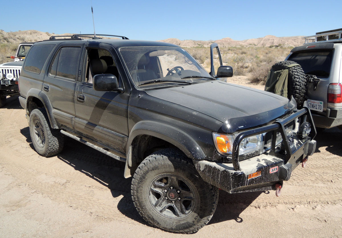

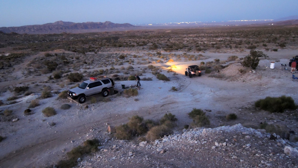

Just got back from Anza-Borrego weekend trip with TriumpthDog (Nathan) and some people from the San Diego Tierra Del Sol 4WD club.
Here is spliced the video!
Pics to follow.

Anza-Borrego April TDS Trip Pictures
/ *** Testing out my new 16 MP Nikon F1.8, 24mm point-n-shoot camera *** /
:lookout:
Pretty cool pics. I love the dusk photos where you see the amber color from the vehicles. How long was that trail ride?

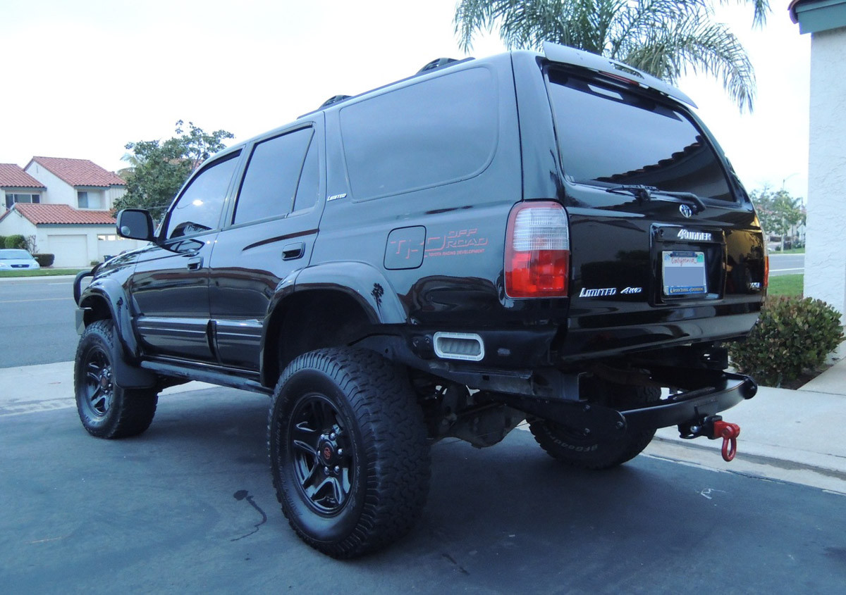

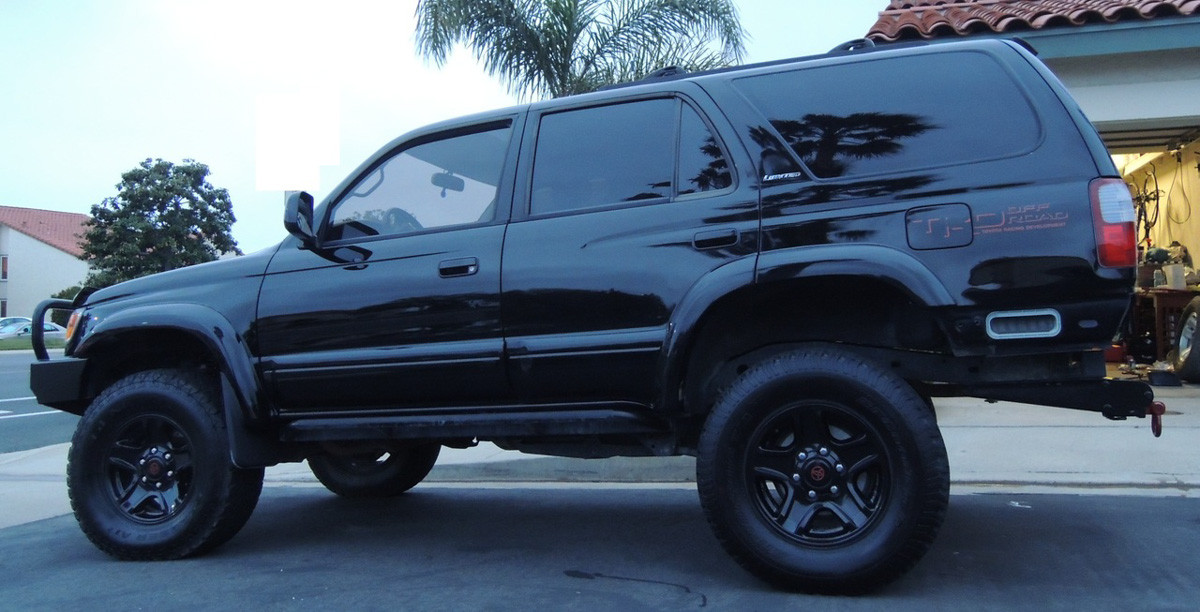

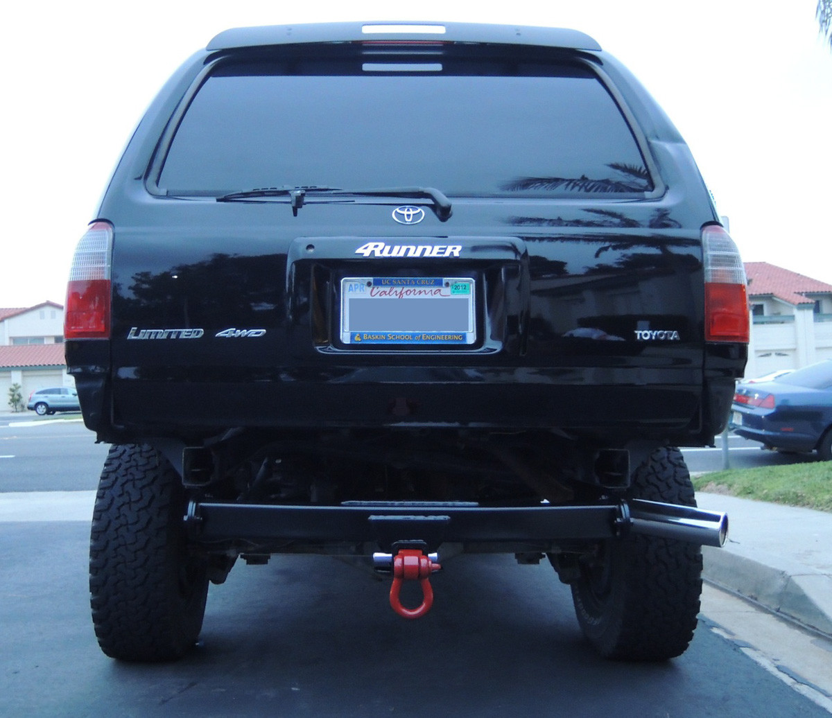

Update:
I removed the following today
* rear tow hitch (which I painted and then put back on)
* rear bumper, all pieces
* Bud Built front skit plate
* Spare tire
I sanded, primed and painted the tow hitch satin black and then put it back on as a quasi-bumper.
I am still waiting for the Savage bumper to be finished and I won't be driving the 4Runner very much until then.
Although not particularly interesting, here are some pics of the truck with a bit less weight...
:hatsoff:
Dang it feels almost like looking at my own 4runner...since we both went all black with ARB.
That's a sweet sweet camera as well and it shows quality in those beautiful photos.
You have one of the cleanest 3rd gen 4Runners I have ever seen! All the small paint projects, the meticulous washing and waxing, and attention to detail make all the difference in the world. Very nice truck!
