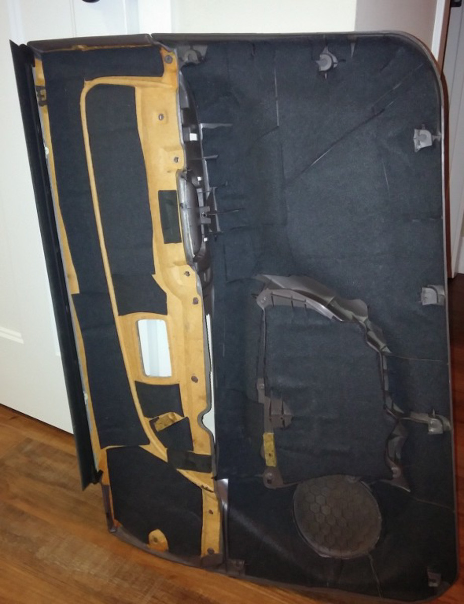

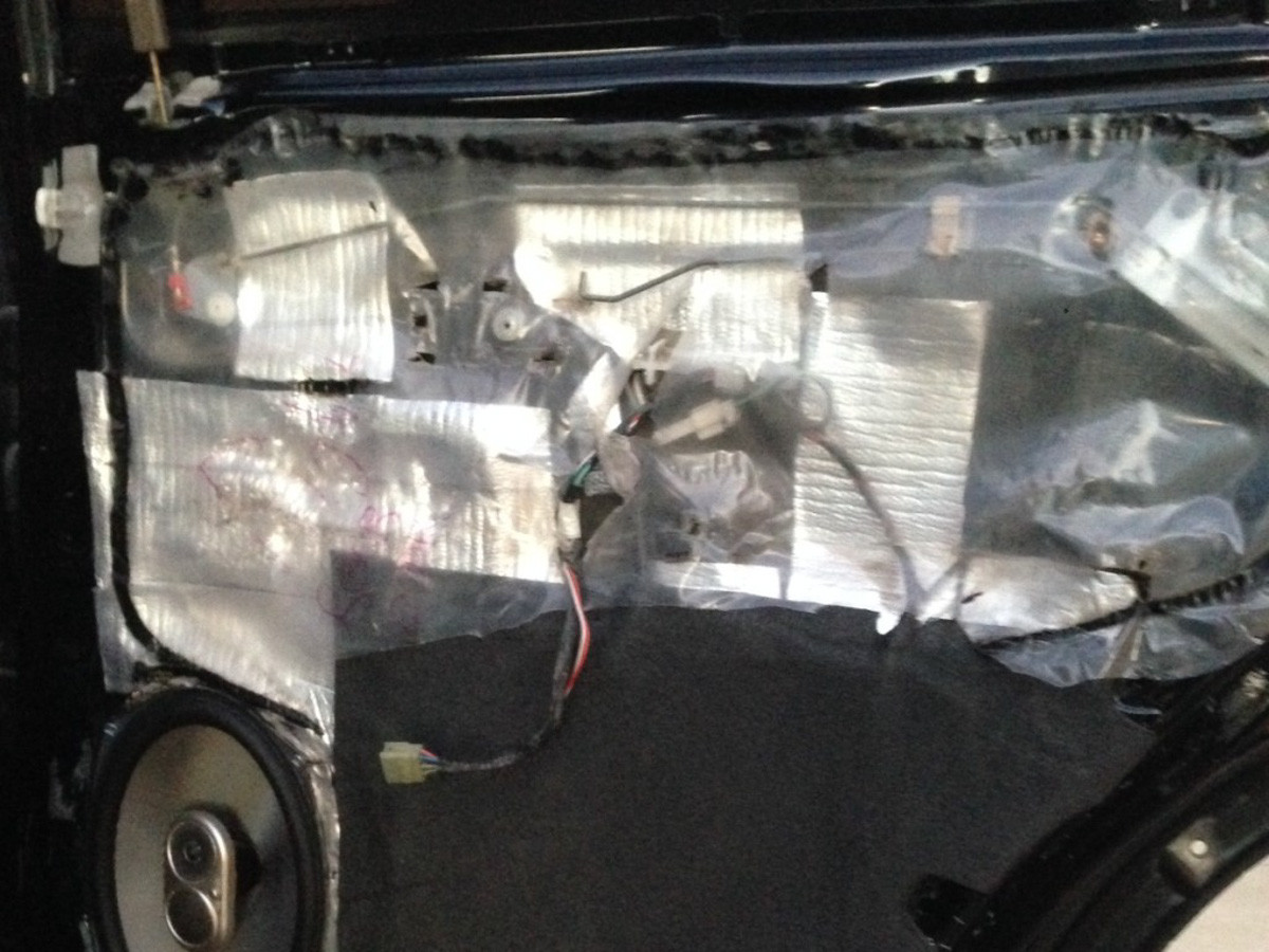

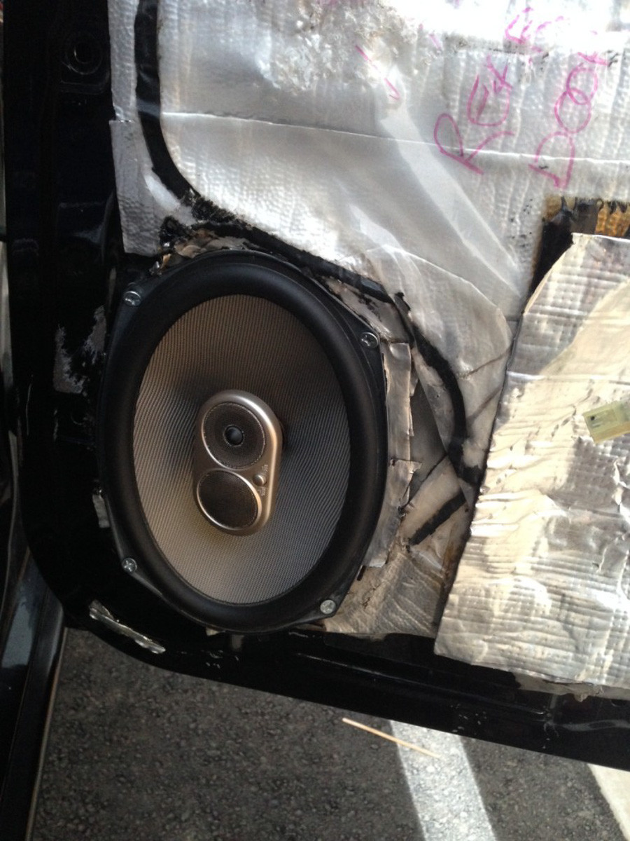

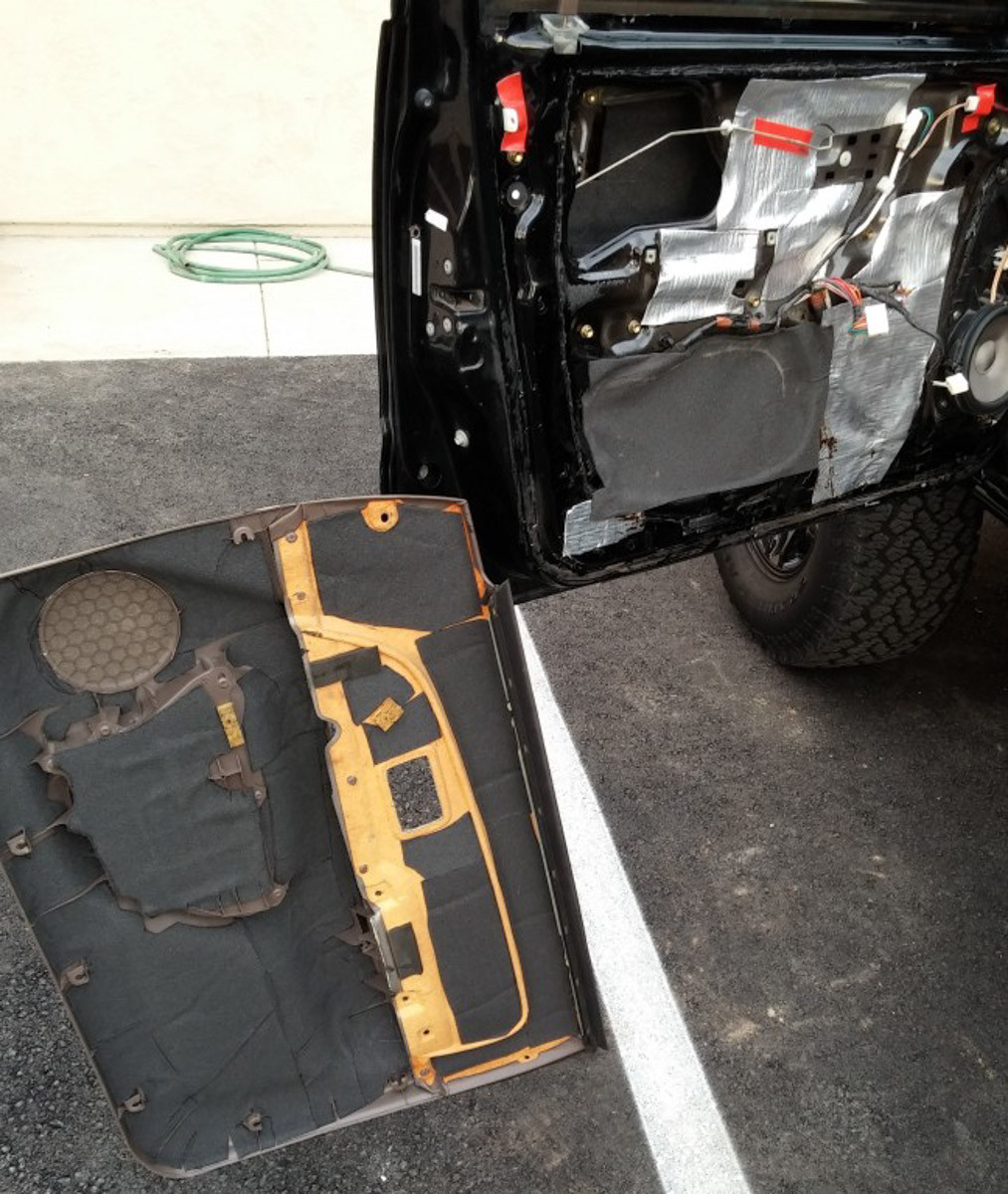

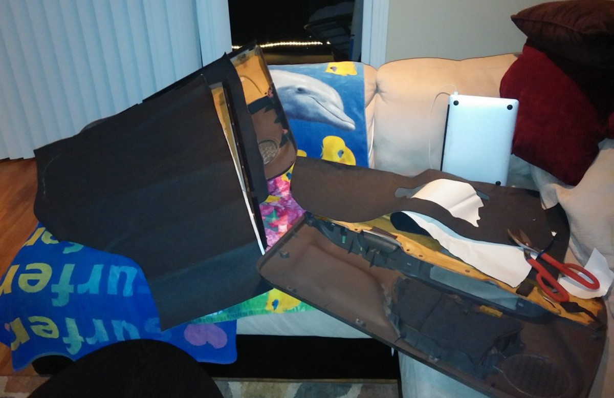

Installed 2nd Layer of Soundproofing Material in all 4 Doors
The foam is sticky on one side so its easy to install. The part that takes forever is cutting each piece to fit into the door crevices. I ended up bringing the panels inside and doing most of the cutting in my living room. 4 hours later all doors were done.
Pictures .....
Notice the 6x9s installed into my rear door!
:humble:
Is that ensolite foam? I would be curious to know the effects. I was planning on doing the same thing when the cold winter months are done here in WI. Planning on putting it on all my interior plastic panels.
Yes it is ensolite foam @ $20 yard. I bought 2 yards and it was enough for all 4 doors.
It is a bit quieter than before although I haven't driven on the freeway yet.

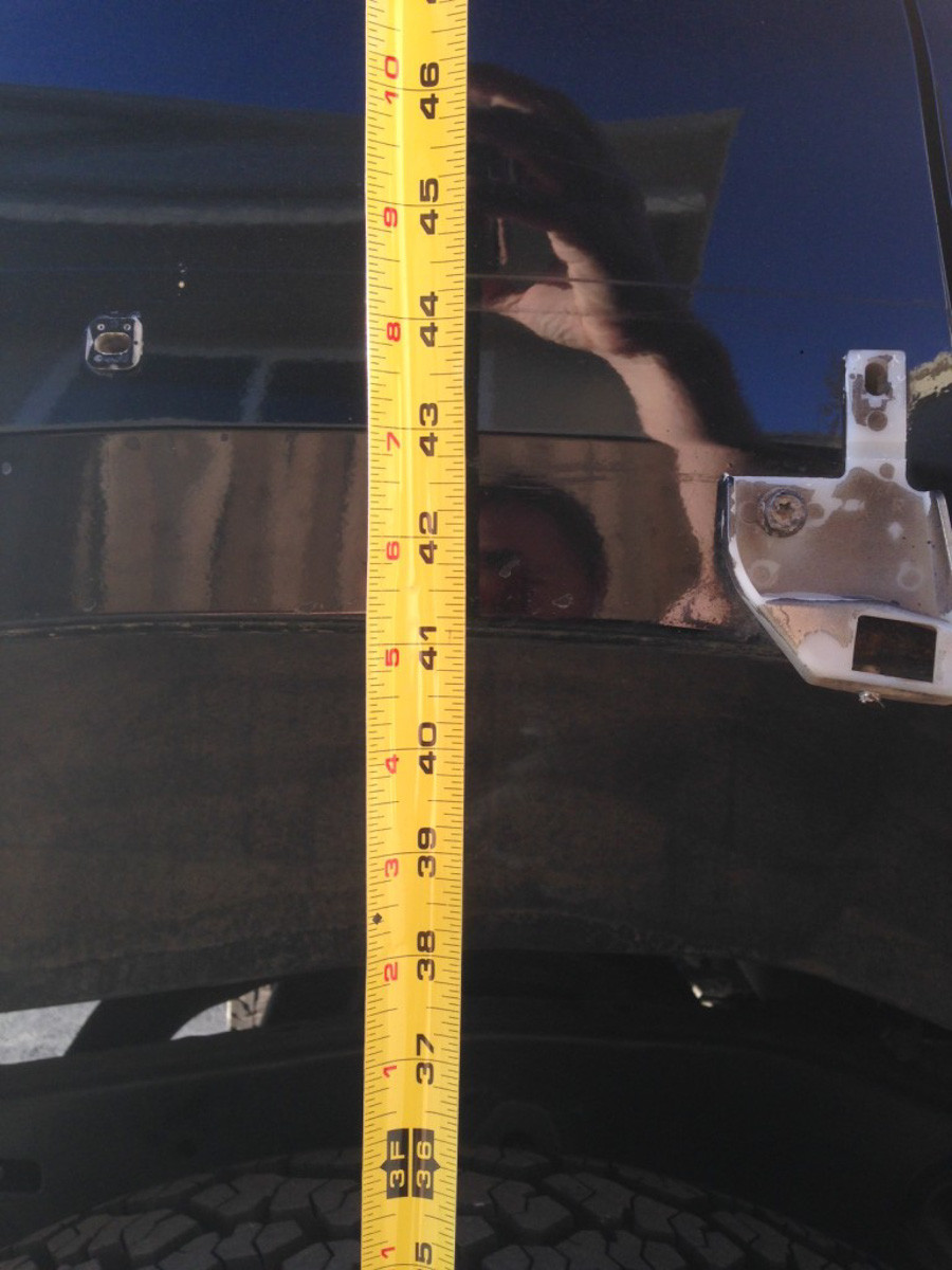

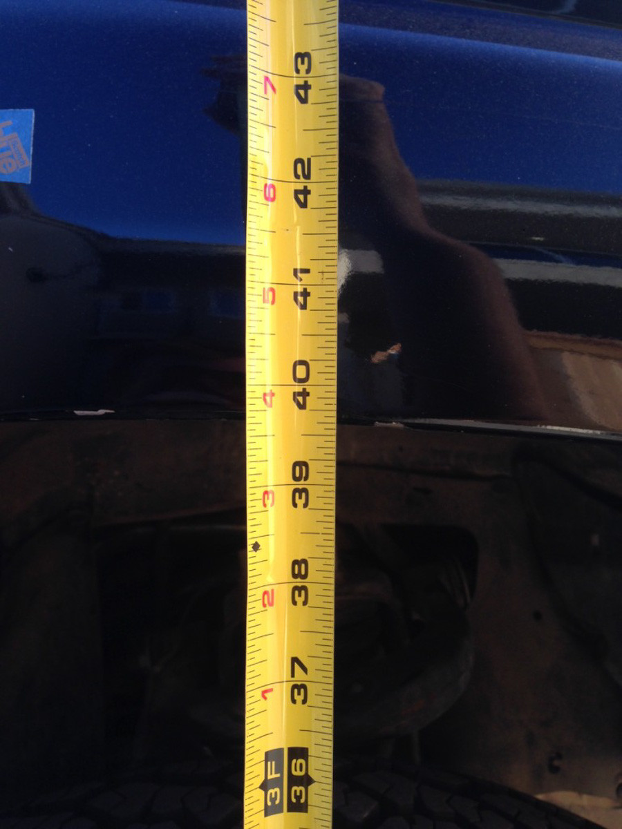

Here are my new post body lift measurements :)
This is without sliders and no front skid plate installed.
Sonoran Steel 1.2A Lift (w/ extra notch) + 1" BL
Front 39 & 5/8"
Rear 41 & 1/4"
:bat:
The ride is mostly the same. The poly body mounts are a slight bit stiffer but the BL does not change the suspension so no real change there.

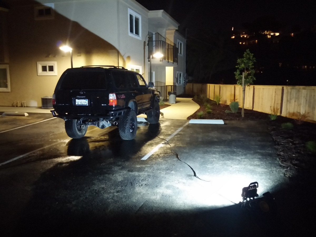

******* 02-14-14 | LED Floodlight Pictures *******

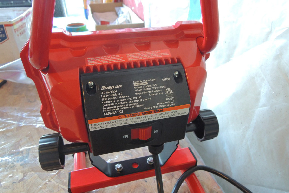

My truck can power its own floodlight for hours and hours and hours now.

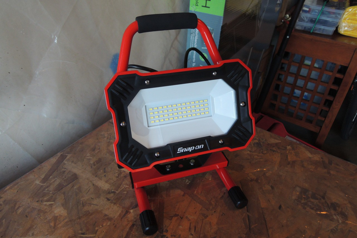

So I was at Costco the other day and they had this cool looking SnapOn LED Powered Floodlight for only $25-ish. It only requires 30W to run. Just 30W !!!!!
Here it is powered by my 175W Pocket Sized 12V to 120V Inverter.

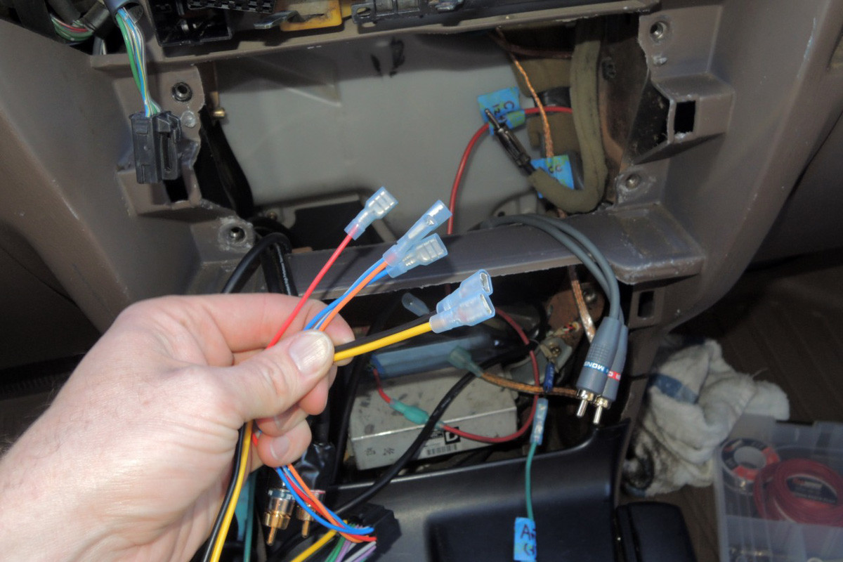

******* 02-14-14 New Stereo Installed *******

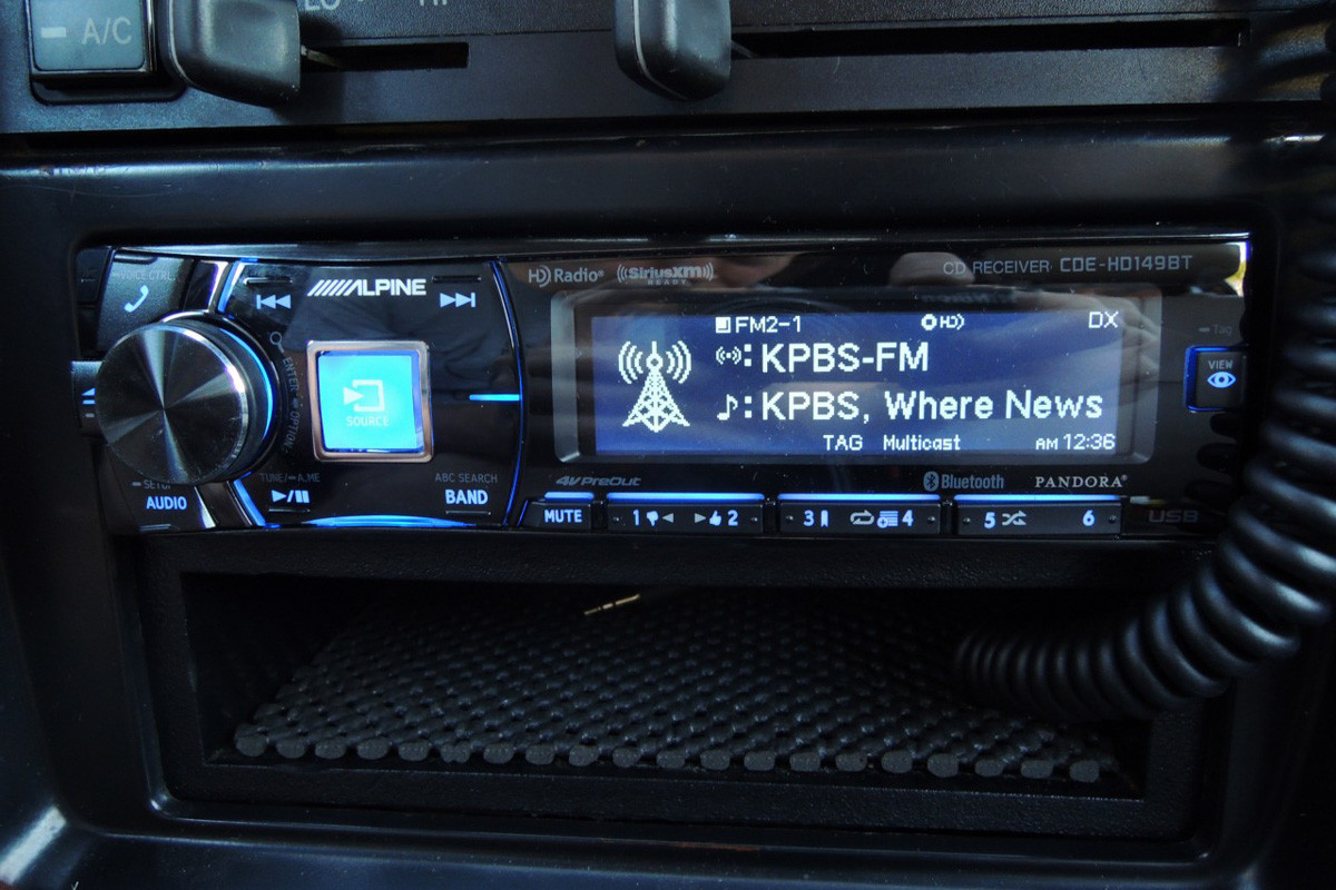

Wow. I just installed a new stereo, details below, and it is awesome. Particularly the bluetooth audio which actually sounds surprisingly great.
Pictures - Alpine CDE-HD149BT Stereo Installed
This one:
Alpine Electronics of America, Inc.
I paid $230 on EBAY for a brand new one with 1 year warranty.
*4V Pre-outs (x6)
* No tilt :(
* Decent screen
* HD Radio Tuning Built In (sounds great!)
* High Quality (2013 version) BlueTooth Audio
The BlueTooth audio really surprised me because I thought it would sound like crap. This newer equipment when paired with a new Android Device like my Nexus 7 (v2) is awesome. The head unit knows the song and you can still control everything from the Android Device which I have mounted over the clock.

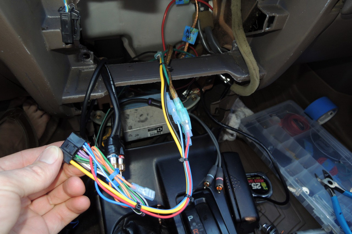

Pictures of the install. I am of course using a 4 channel amplified so I have no need for the stereo wires - just cap those off. I used spades to connect the various power and antenna wires. I don't prefer to solder the wires because it is unnecessary and makes changing the stereo a pain.

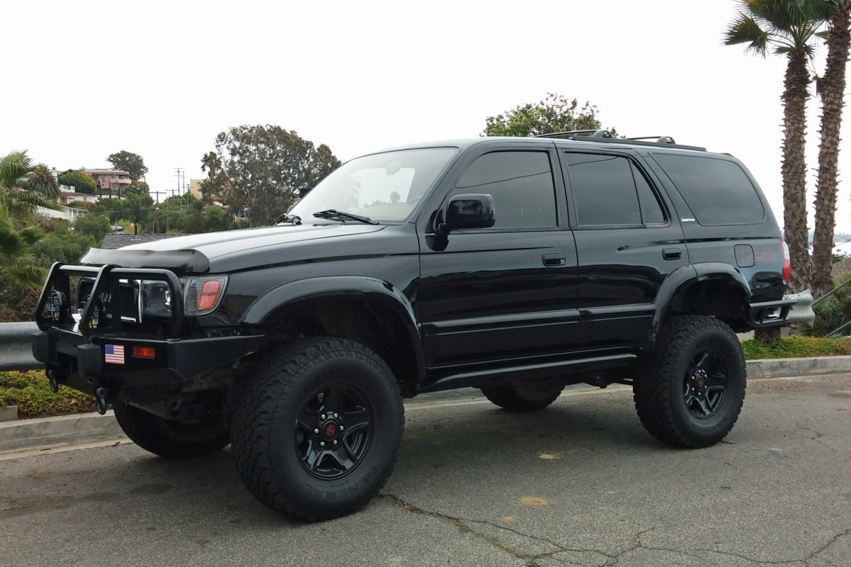

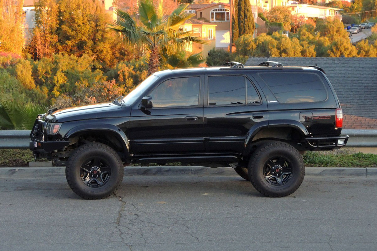

02-14-14 | Finally! Pictures of my Body Lift Installed & Flares & newly modded Sliders
You can also see it installed with the full lift in the night picture a few posts above.
I finished the body lift a few weeks ago but haven't really posted that many pictures. Here are a few with more to come after this weekends trip.
