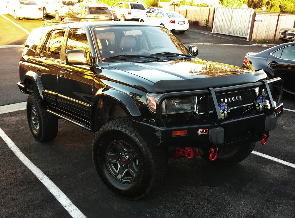

Pic - Washed for the great weekend weather.

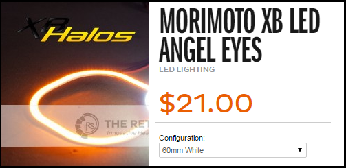

2. Since I am taking my retrofit apart anyways .... I plan to add a 2nd Amber Halo set but this time facing rearward into the housing. This should give the light a mean Amber glow. I am getting these 90mm Amber on clearance from TRS for $33 shipped so it is isn't setting me back that bad. If it doesn't look right I will just leave them epoxied in place but not powered up. Hopefully it looks cool!

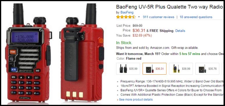

3. I bought a cheapo HAM radio from Amazon for Moab and future camping trips. I aspire to get my license on day so that is on the horizon. In the mean time we will stick to "throw away, non-repeater channels" and also it will be kept for emergencies. I plan to save all the local emergency channels for each area I travel to just in case I need them.

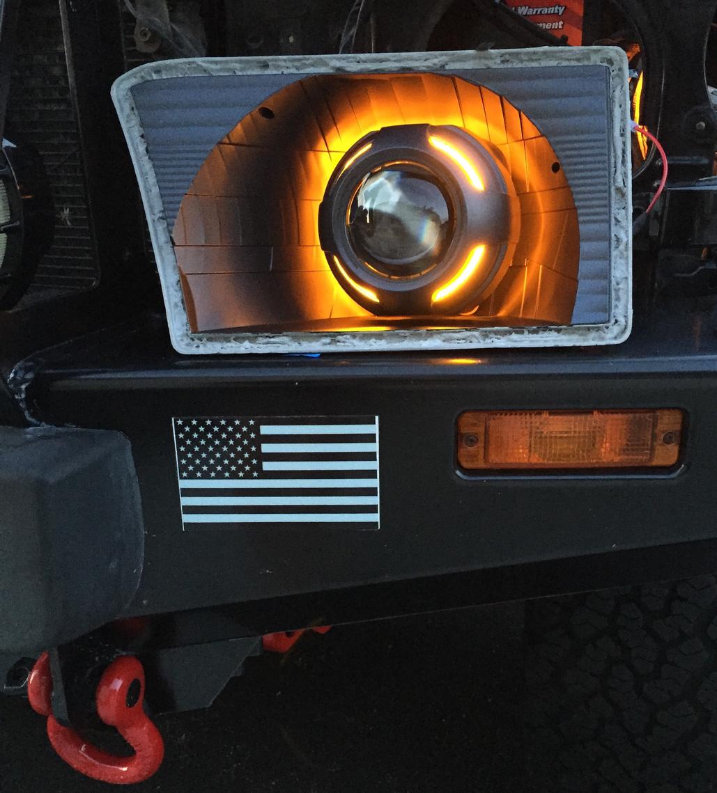

speaking of lights ... here is the first pic of my updated retrofit project. I worked most of Sunday on these lights. It took a surprising amount of work to take everything apart, do the wiring, test it, clean it, glue it, put it back together and seal it up.
Behold .... a dual (fwd & rev) Amber halo retrofit.

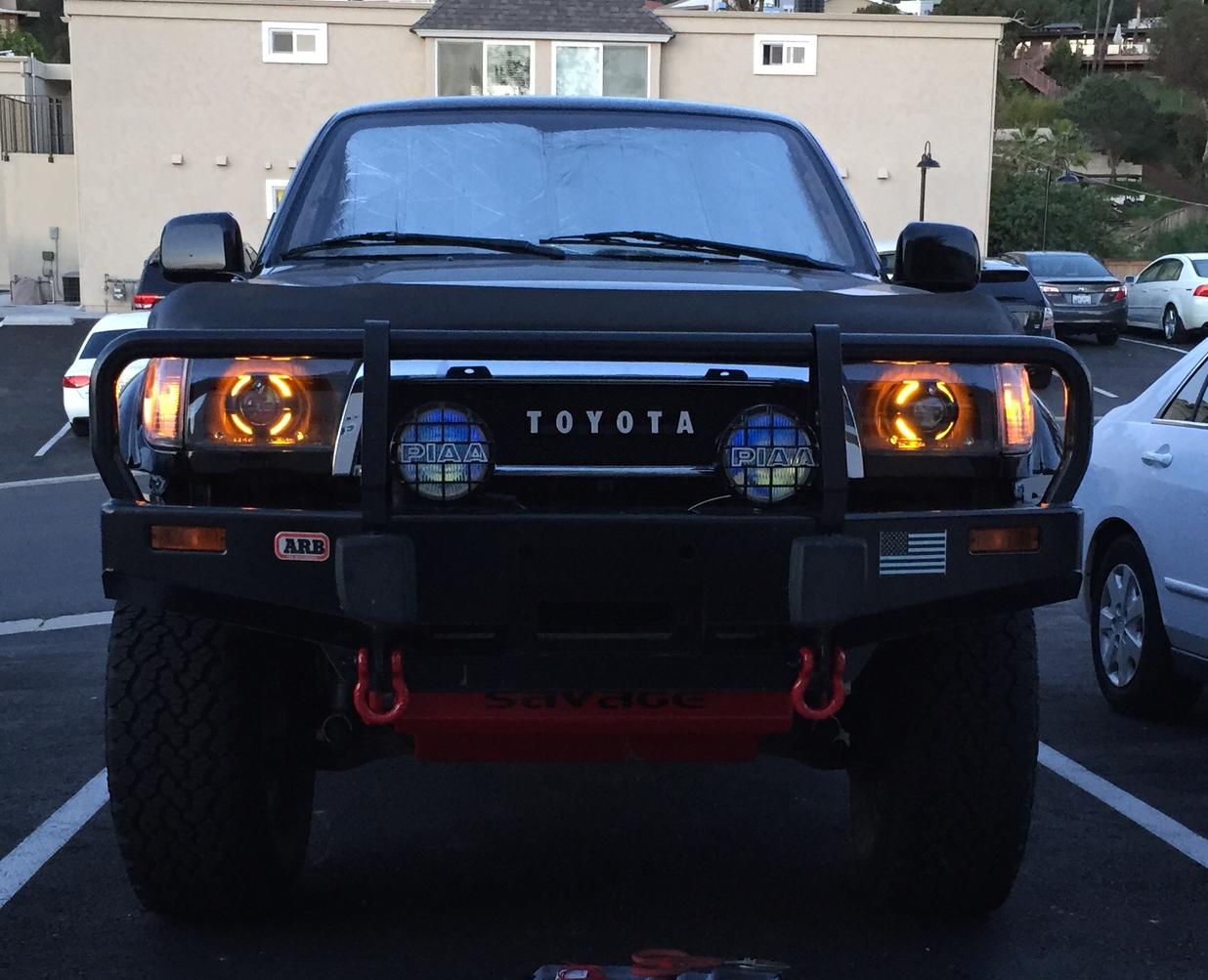

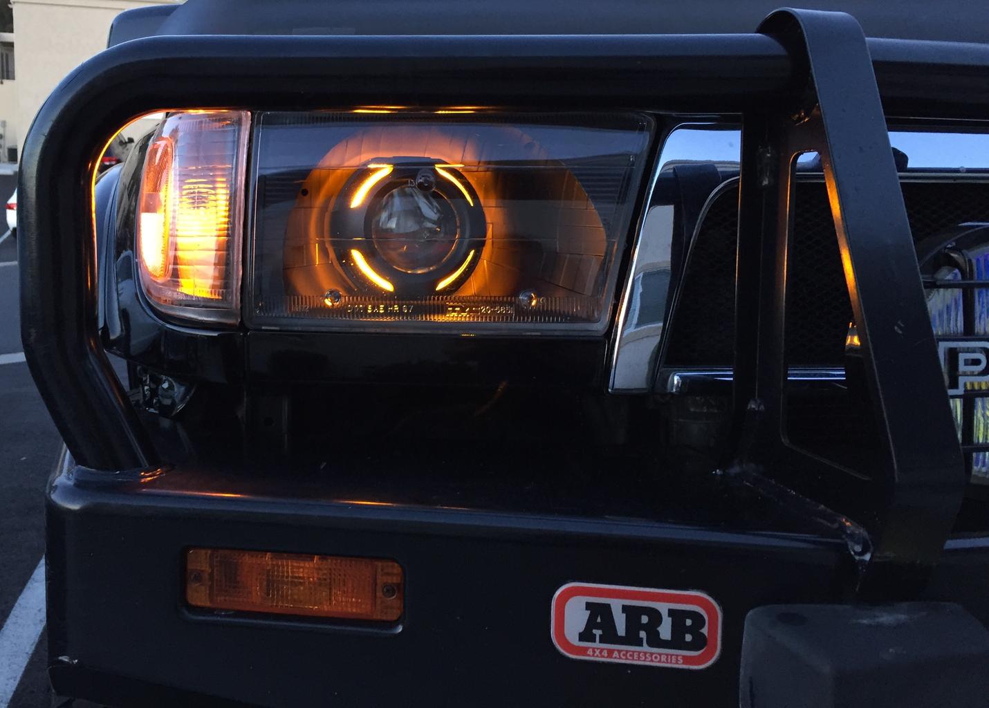

Pictured here is the next step on my Retrofit, now installed.
What has changed in this picture?
Two things:
1) put Amber led bulbs in the corner lights. These are 6 way LED bulbs but I blacked out the front facing bulb so it doesn't shine straight ahead.
http://www.vleds.com/6-a.html
2) In the retrofit I installed rear facing Amber halos to complement the front facing halos. Also I trimmed the shroud a bunch more so it would let out more orange light.
