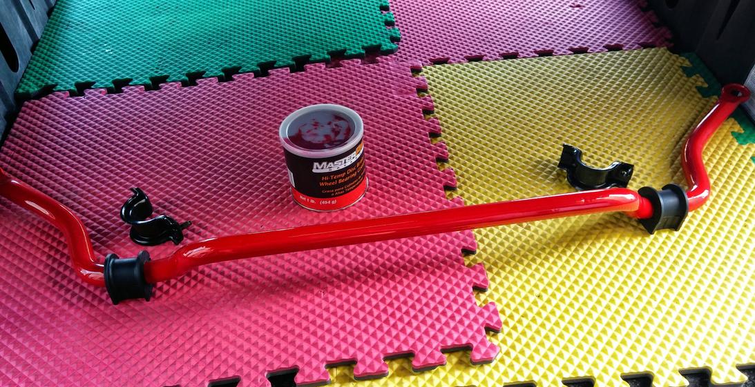

At some point while driving around Joshua Tree one of my sway bar brackets broke. I ended up removing the front sway bar just so it would stop clanking.
I plan to get that fixed ASAP.

Dropped off the front sway bar and my two Lotus Rear LCA skids off at the PowderCoating place to get PC-d.
I wanted to go with PC this time because both times I've painted these parts it comes apart super easy after a few trail runs and I need something more durable.

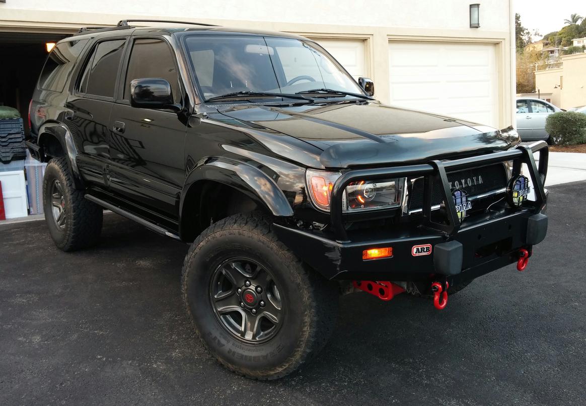

Washed and waxed !
Nice truck! I've been thinking about painting my 5 stars that color too. Right now just my center caps are and I like it.
Are you still happy with your Brembo set up on the stock calipers? Does it do a good job of stopping your truck with all the armor and bigger tires? Any warping? I'm stuck deciding if I want to do the 231 Tundra brake upgrade, or just go with the Brembo rotors and good pads on the stock calipers like you have.
I'm very happy and it's been about 5 years I've had these brakes on. So far so good. 2nd set of pads and yes I had the rotors turned once after trailering a Uhaul. The warped feeling wasnt actual warp but rather composit build up on the rotors and after being turned they were fine.
