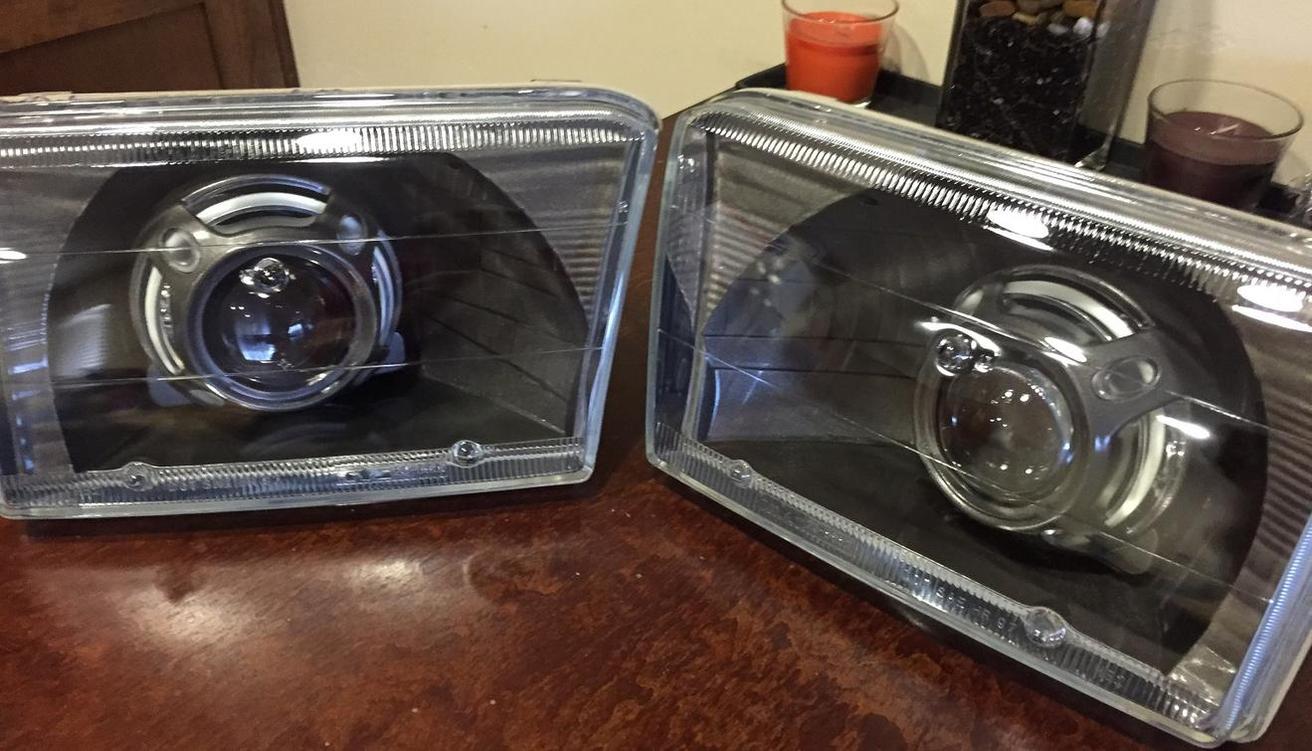

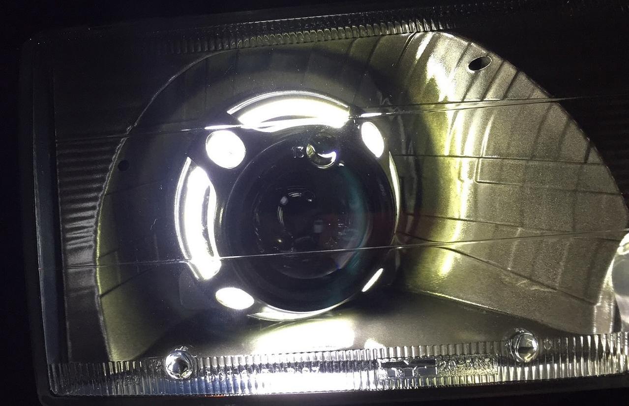

Officially finished my #2 How To thread for doing a projector retrofit.
Just FYI - these were sold for the asking price of $650. They constituted about $450 in parts and took over a weekend to make so I think the price was fair.
I won't be making any of these in the near future because it takes way too much time and I've got a lot of other stuff to focus on.

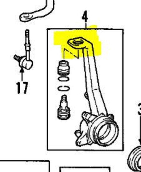

My drivers side Knuckle / Hub broke where it meets the upper ball joint. The Toyota part failed. I’m not sure what happened. It could have been stress fractures, metal fatigue, hitting a rock that was too large etc. It just happened.

Current status - truck is at the shop awaiting new Spindle & wheel bearing install.
