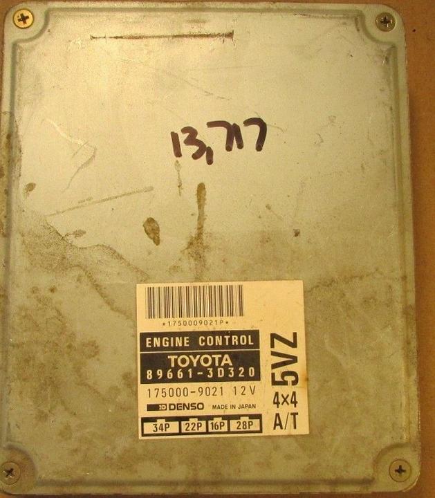

Picked up a new (used) ECU from Ebay for $50. Going to install it next week before my trip to Sedona, AZ. I'm still getting these random misfire codes once in a while and everything else has checked out. The mechanic suggests swapping the computer since it is low cost. He didn't have a used one in stock so I ordered one on Ebay. It has a 30 day guarantee.

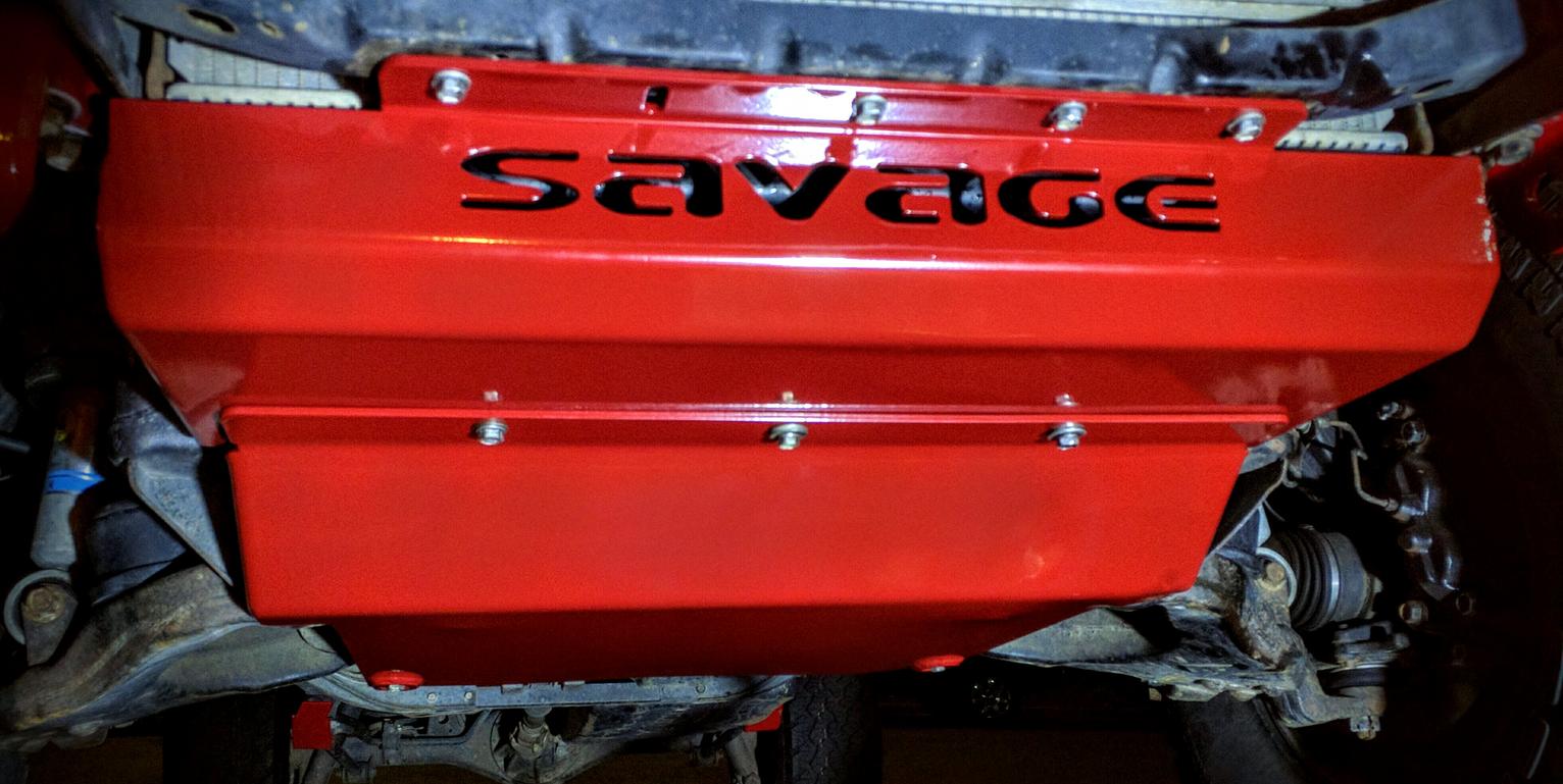

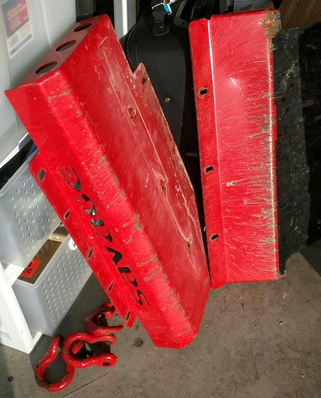

Also I dropped off my beat to sh$t skid plates to be powder-coated. Do you even offroad bro?

Freshly powder coated skid plate installed.

ECU been replaced with the same exact model, purchased off EBAY. If you are going to do an ECU swap know that the part can be bought for as little as $50. When searching EBAY be sure to look for a listing with a Hollinder number. These listings are post of national database for used parts sales. I believe the more legit guys use this system. Cost to swap ECU: $40. So far it is running strong. Wish me luck!
