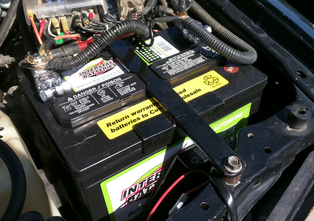

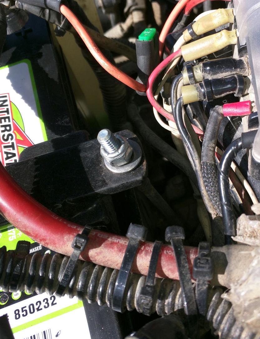

[MENTION=110387]jstim[/MENTION] I also replaced the top part of my battery box (pictured) with a new metal cover that closely emulates the factory way of bracing the battery. I suggest others who want to install a battery box do the same. For about two years now I've had the battery box welded to the inside of the engine bay and while it was stable at first it would Rock loose over time and creek. This is because the battery weighs a lot and the metal in the engine bay is thin. Moral of the story is you should try to preserve as much of the factory mounting setup as possible. Btw, my battery box is from Ballistic Fabrication. Great workmanship but there is no clear install method besides welding and doing what I did.
Here it is with the modified setup, with a battery box and also a custom mount.

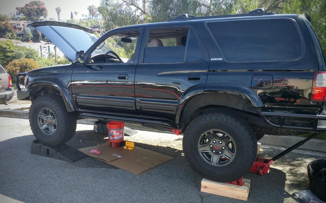

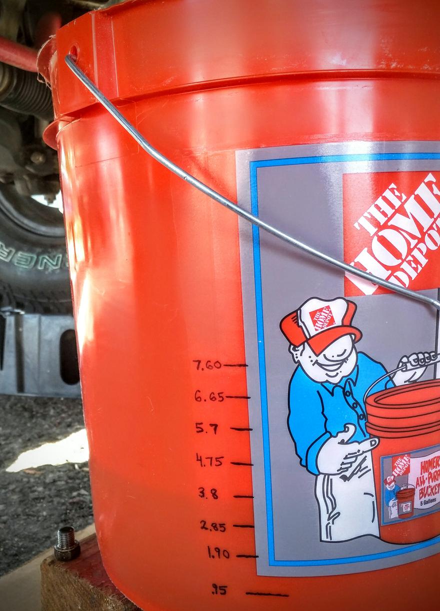

Drained and filled the transmission fluid. 4 quarts drained out. I'm not sure why so many postings indicated 2 quarts.
3.8 L, 4 quarts.
Anyways, filled her back up again. I plan to do one more cycle after I put some miles on it.
I used Toyota ATF from the dealer. It is ~$9 MSRP but my local stealership tried to charge me $13.
