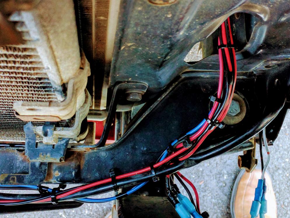

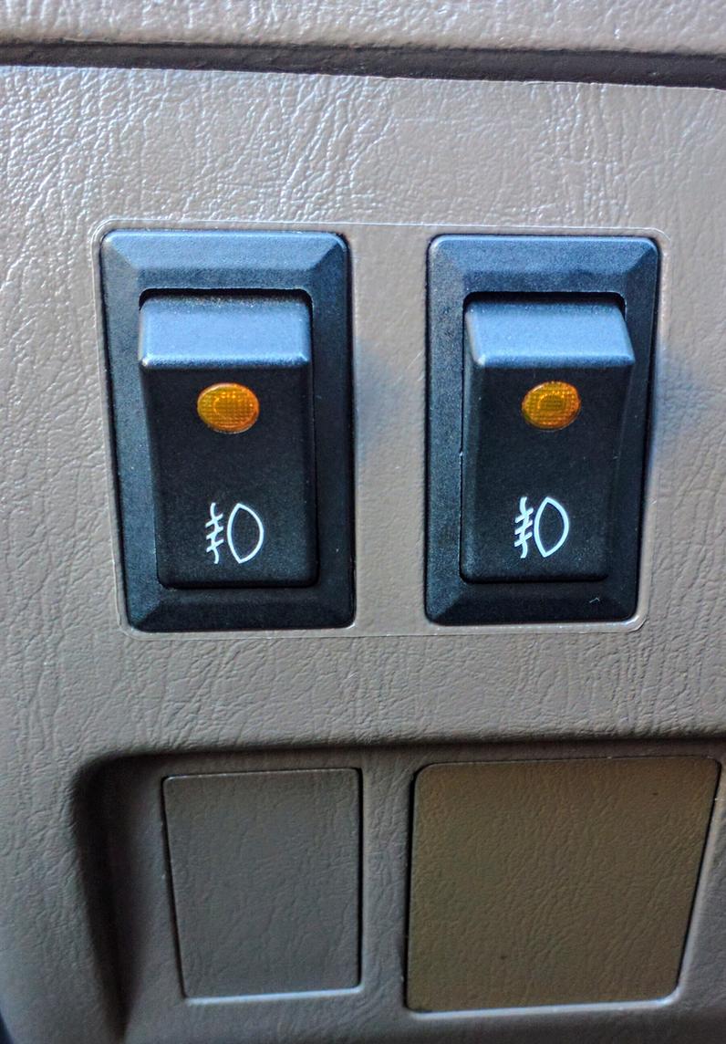

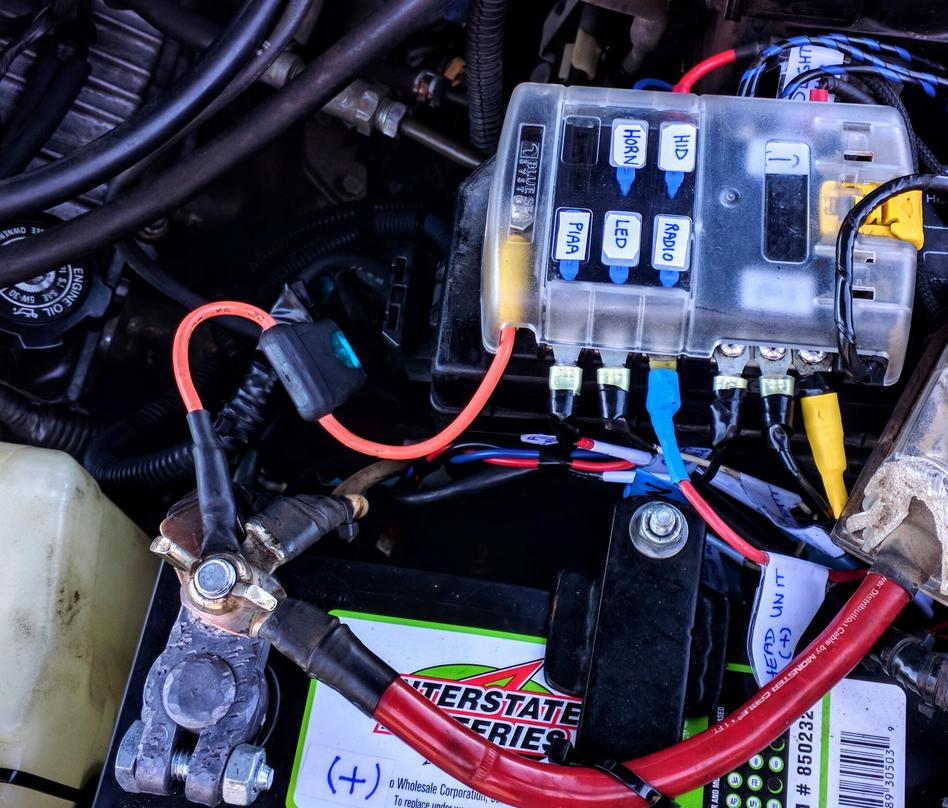

Update: I added some pictures below showing the new wiring run and the OEM switches for FOG and LEDs.

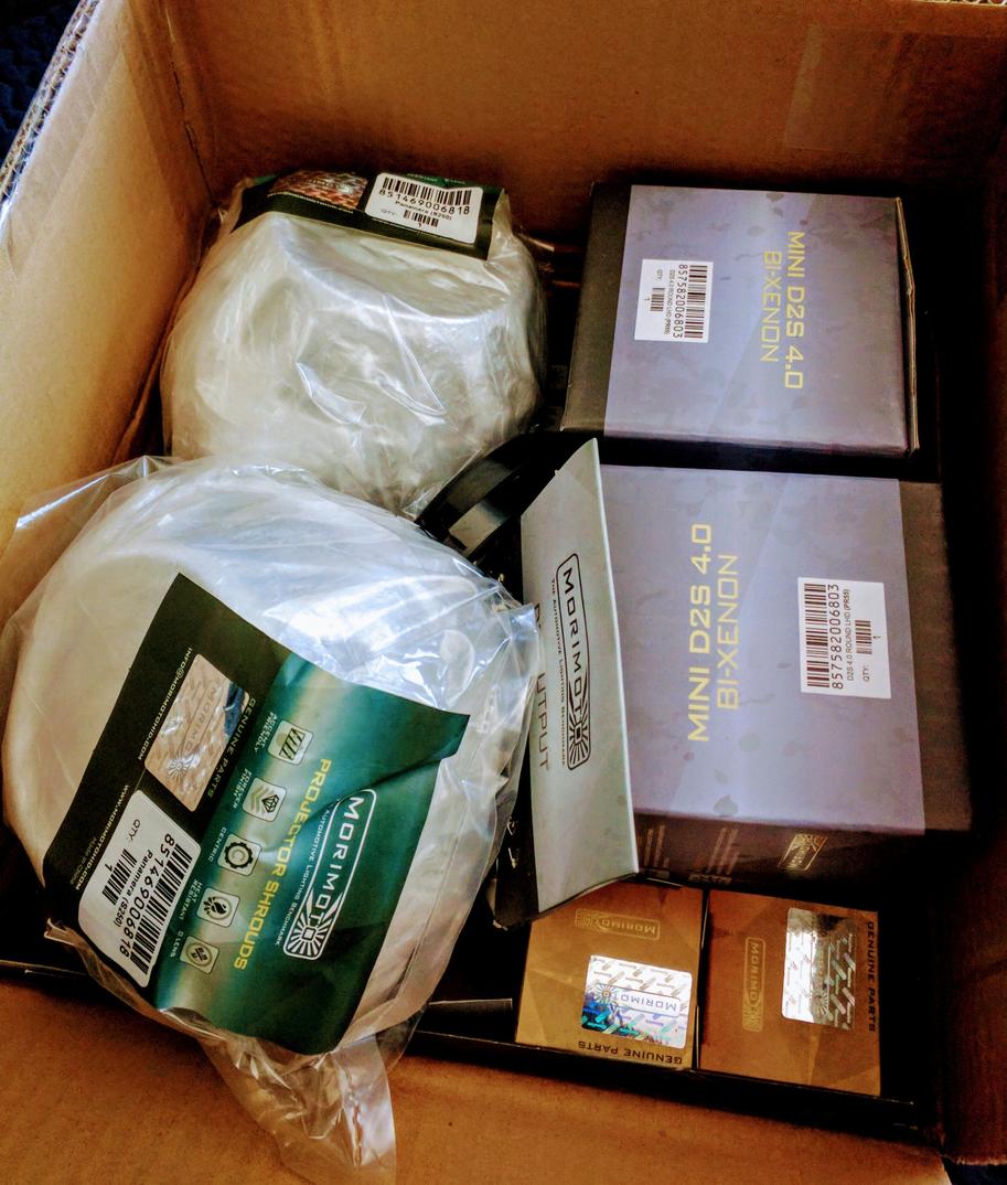

Unboxing ....
Mini D2S 4.0 components. I guess that means it's time for another retrofit.

Also, you'll love the 4.0s. I just did a set for a forum member down the road and they blow my FX-Rs out of the water. I also really like that the plug for the hi/low function is on the back now.
I LOVE the high beam pattern.

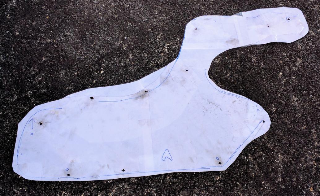

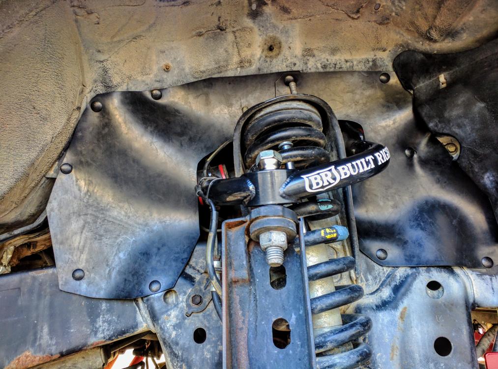

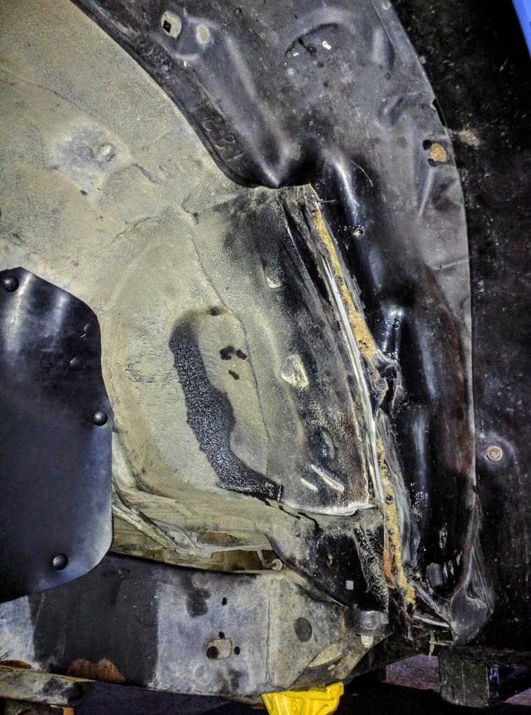

Finished the Splash Guard Mod. Thanks Conner [MENTION=114863]4RunningDaily[/MENTION] for the idea.
Buy one of these - $10 (25) count pack
Toyota Dash & Fender Apron Seal Retainers 90467-10186
Diagram
https://parts.camelbacktoyota.com/p...siteid=214329&vehicleid=68842&diagram=8414135
Rubber 1/16" x 36", buy quantity 2
Neoprene Rubber Sheet 1/16" Thick x 36" wide x 12" long
By rubbersheetwarehouse
Neoprene Rubber Sheet 1/16" Thick x 36" wide x 12" long FREE SHIPPING | eBay

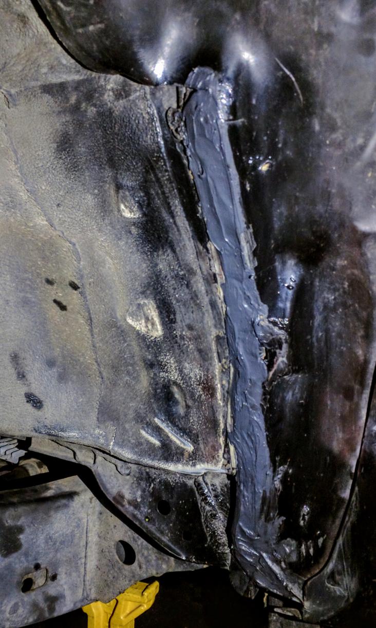

Frankly this was more of a PIA than I thought it would be. Much easier with the tires off though. While I was working on the wheel well I also decided to close up the gaps I had from trimming the inner shield. Patched it up with black silicone, although it looks grey in the pic.

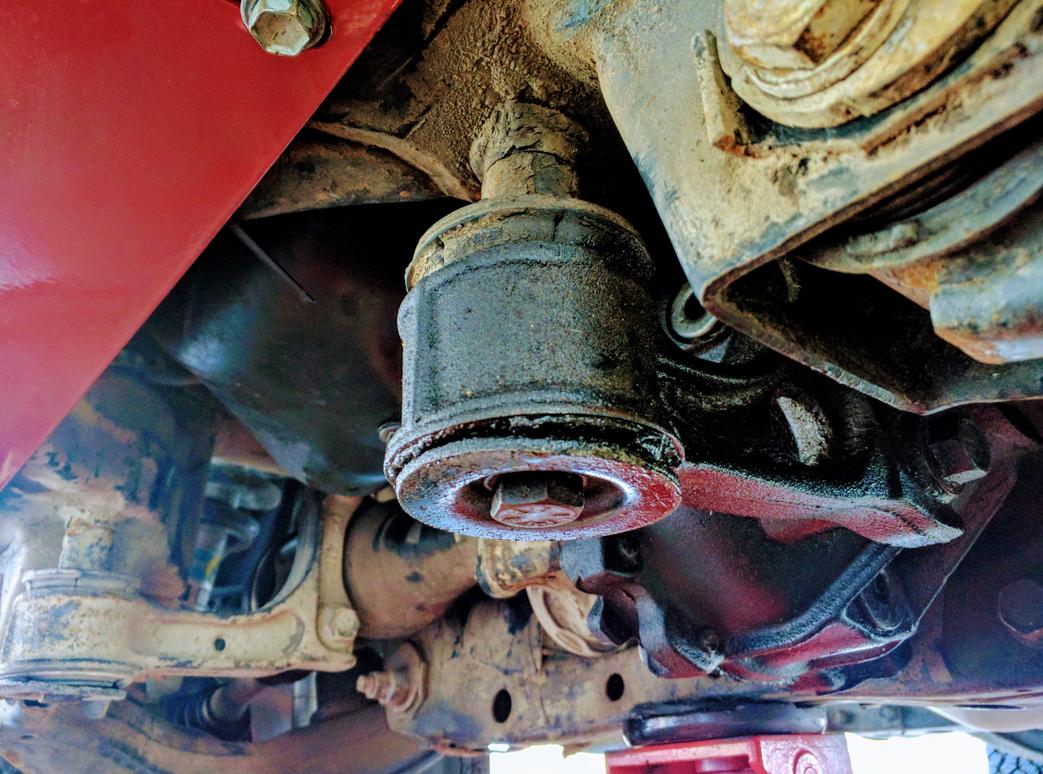

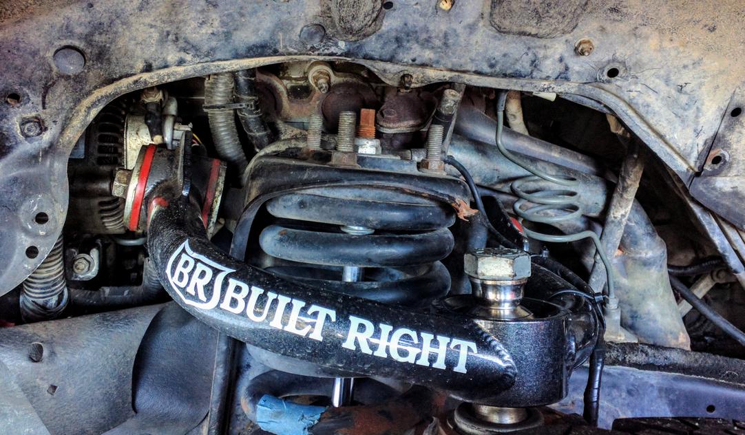

White I was exploring under the truck and tightening my sway bar links I saw this. Not sure what to make of it but it looks worn out.
Yep, worn but maybe not worn out. Easy repair should only take 10 mins. I just replaced mine for the second time 3 years. I notice that the rubber part of the bushing in the lower starts to fray and deteriorate. When you remove them it will be evident where and how they are worn. They don't press in, super simple. But what's with all the filth and where's your skid plate?
Hope your doing good buddy.
Thanks man. Before the engine swap it was leaking oil. I'm pretty sure this is what remains of the past oil leak.
About the skid plate, the second part of my savage skid is going back on later today.
