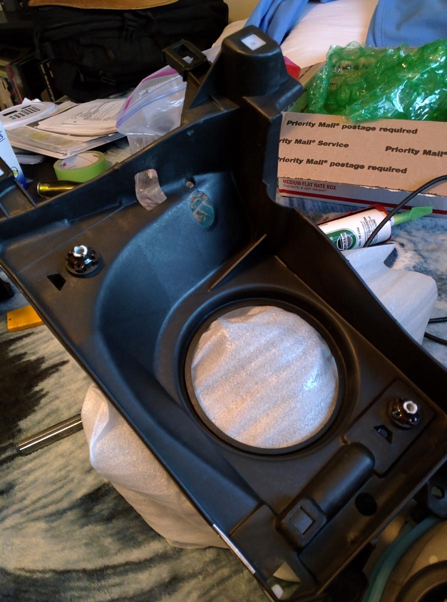

* Disassembled the housings
* Baked the lights then took them apart

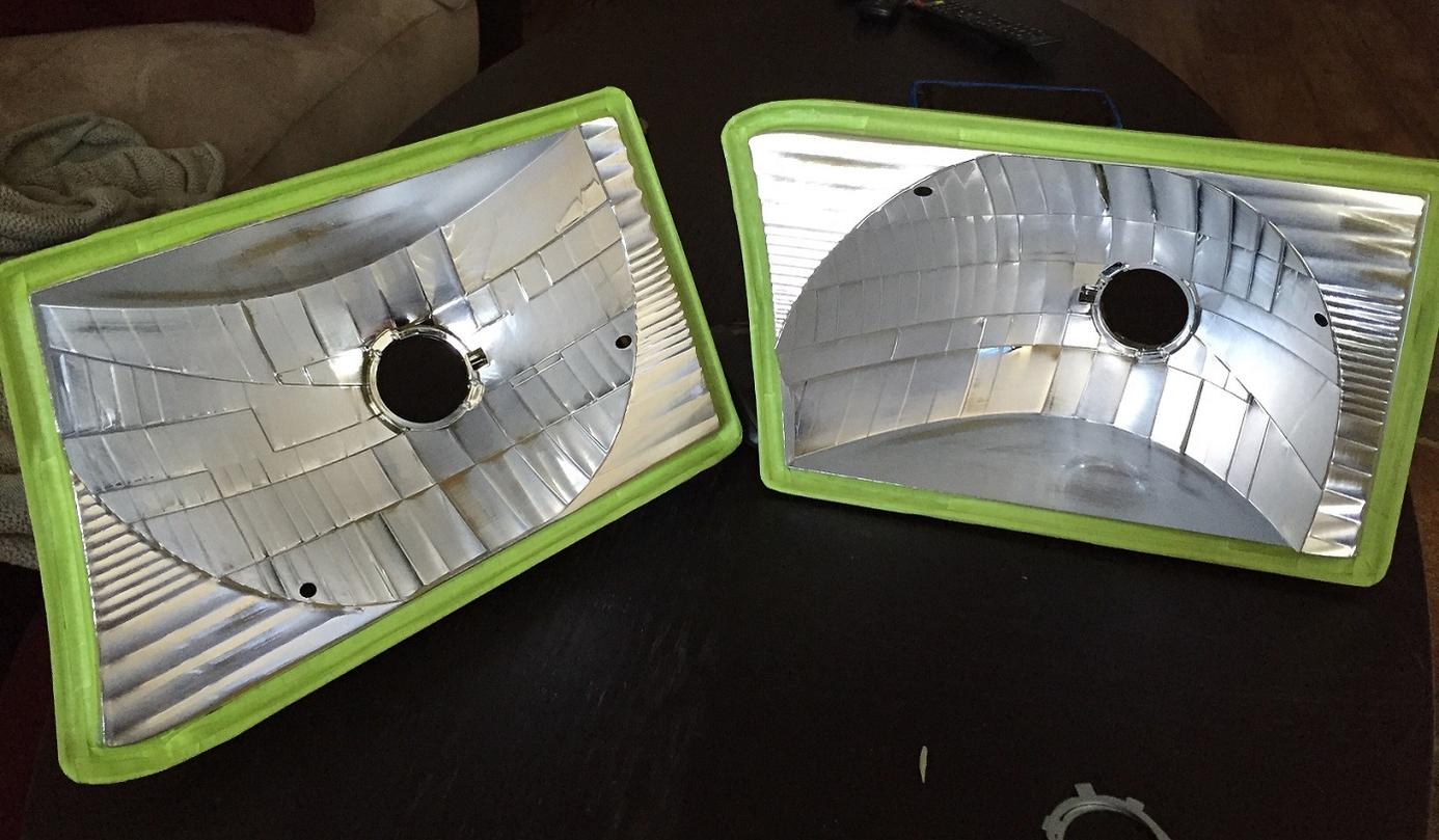

* Wet scratch pad scuffed up the housings then the Panorama Shrouds
* Taped up the housings, covering up the glue so it isn't painted

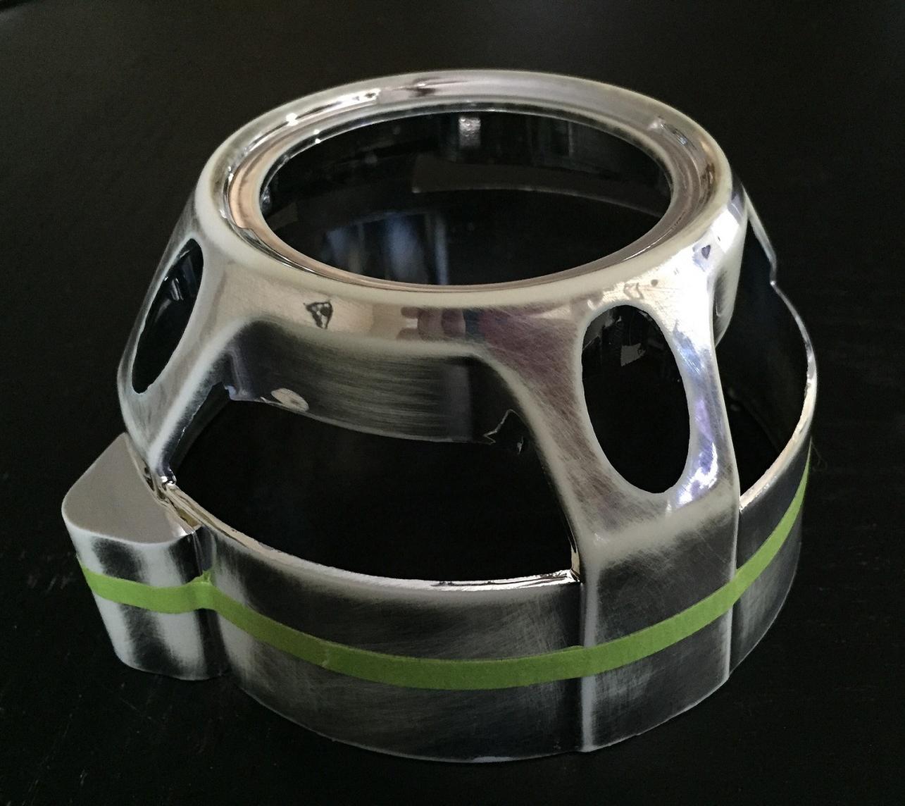

* Taped the shrouds, marking them to be cut

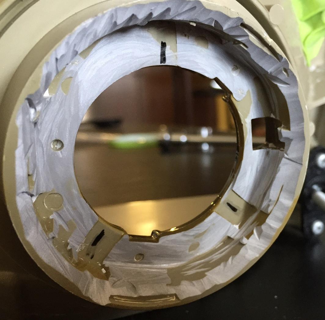

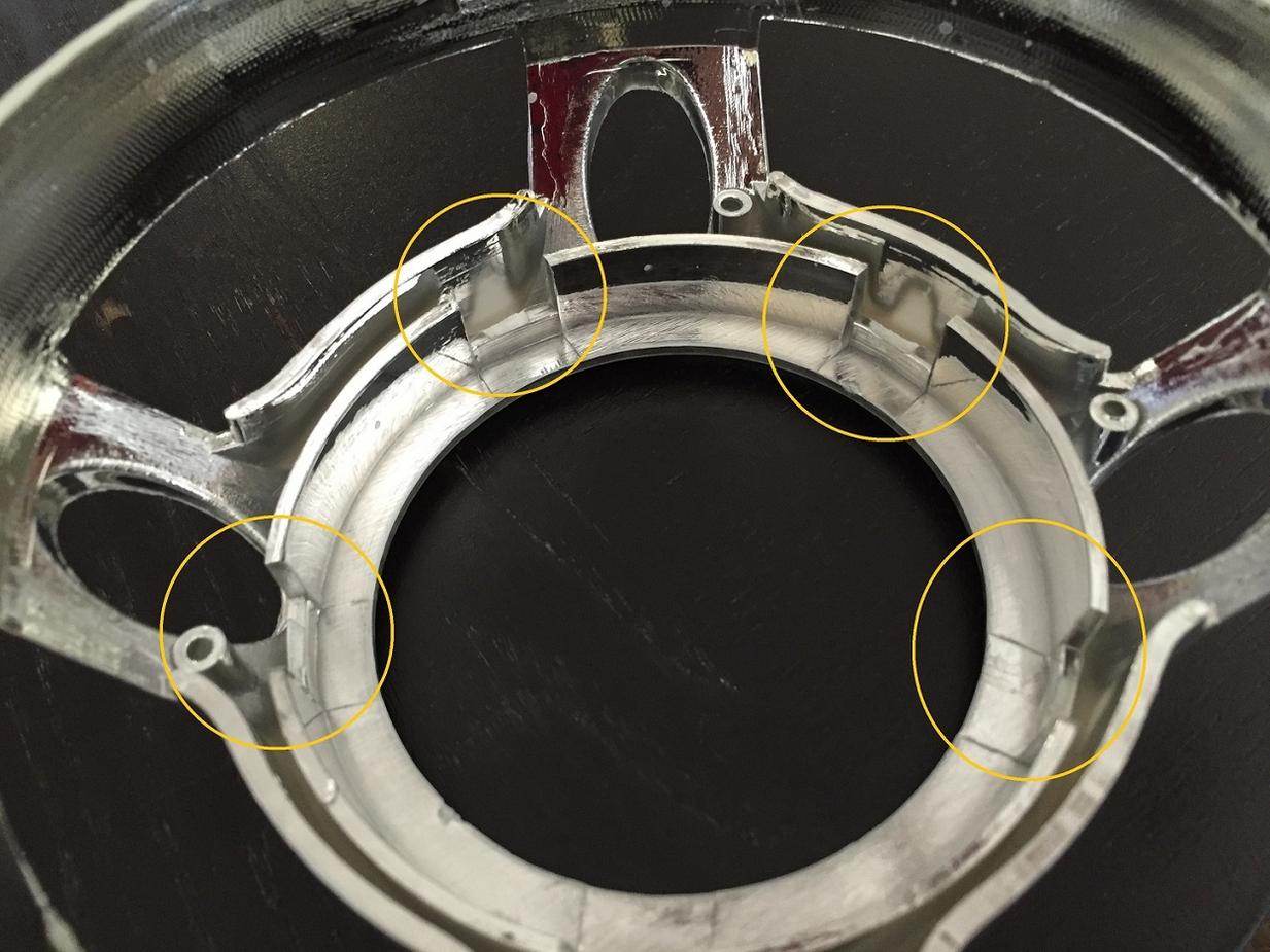

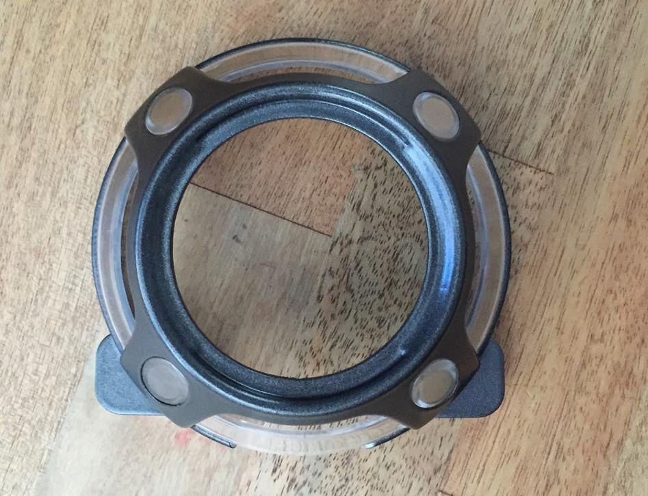

* Broke off the alignment tabs on the Panorama shrouds, they don't fully engage and they let light out. 3M tape will be more than good enough.

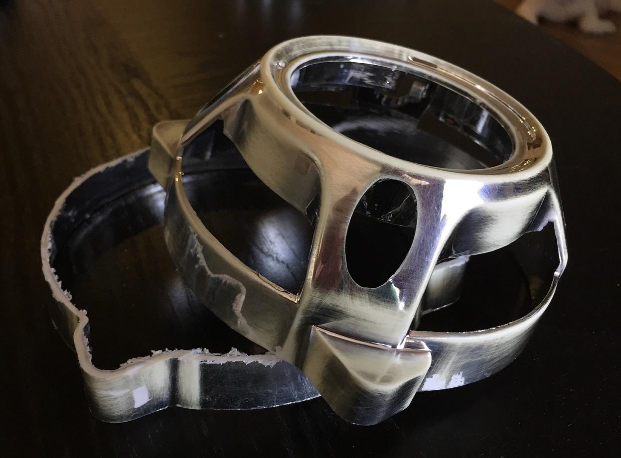

* Used my dremel to cut the Panorma shrouds along the tape line

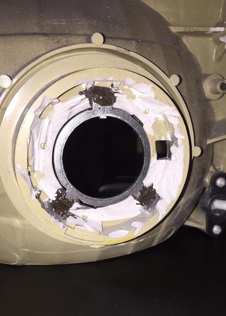

* Used my dremel to cut the light housings as shown

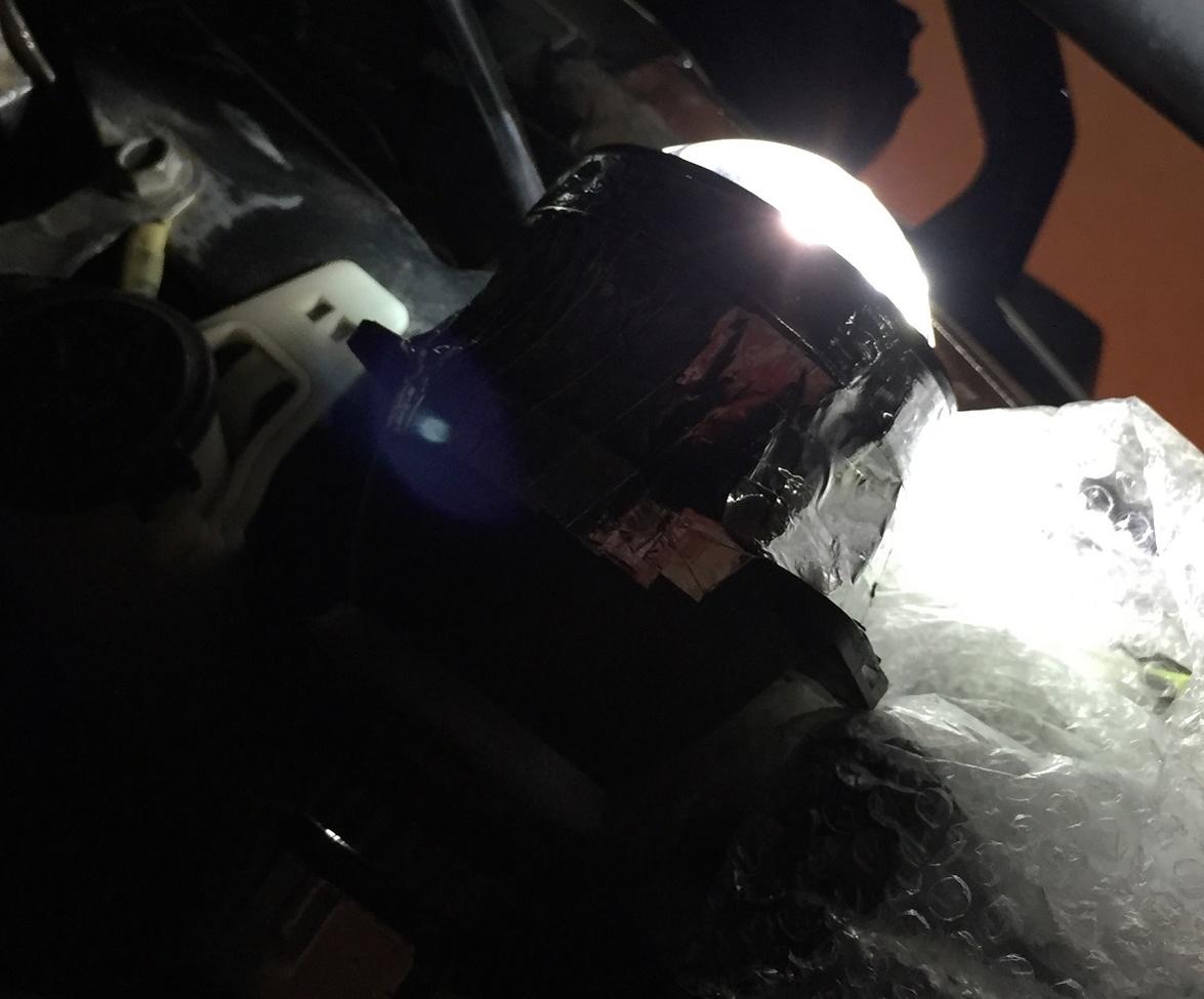

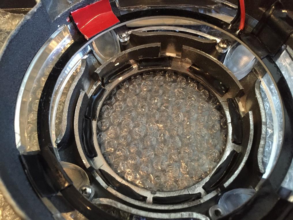

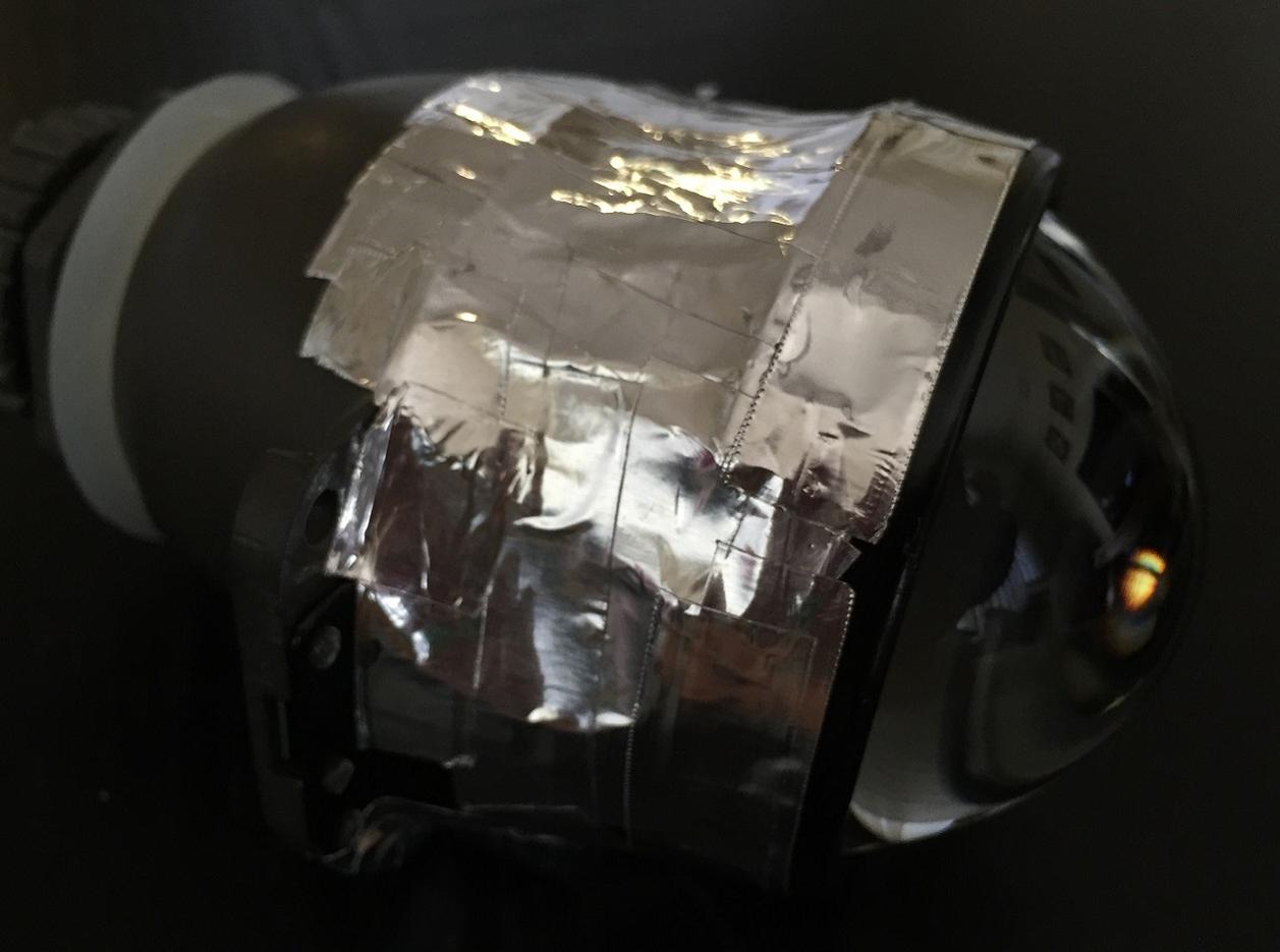

* Sealed up each Mini D2S 3.0 projector with metal tape to remove all light pollution (this took an hour for both BTW)
* Installed bulbs and op tested the projectors with the ballasts on my truck

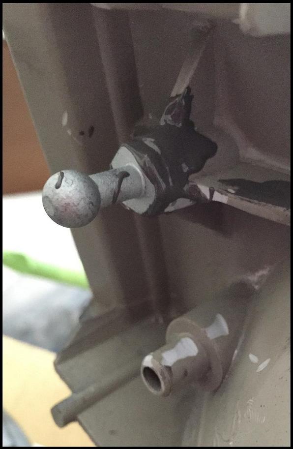

* JB Welded the metal alignment key into the light housing, let it sit for 30 mins then tape over it

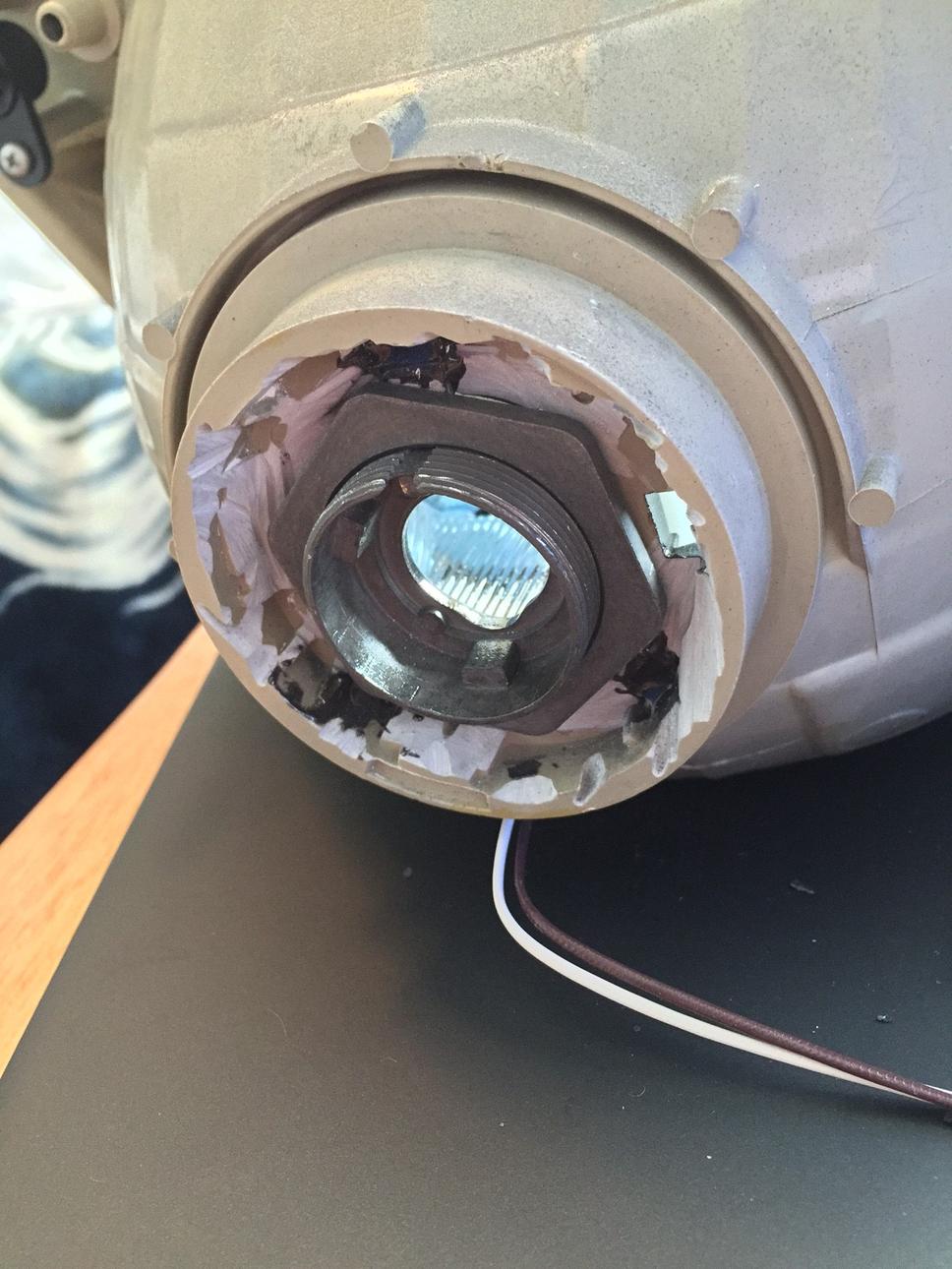

* Drilled additional hole in the light housing to run the wires through. Will seal this with silicone later on.

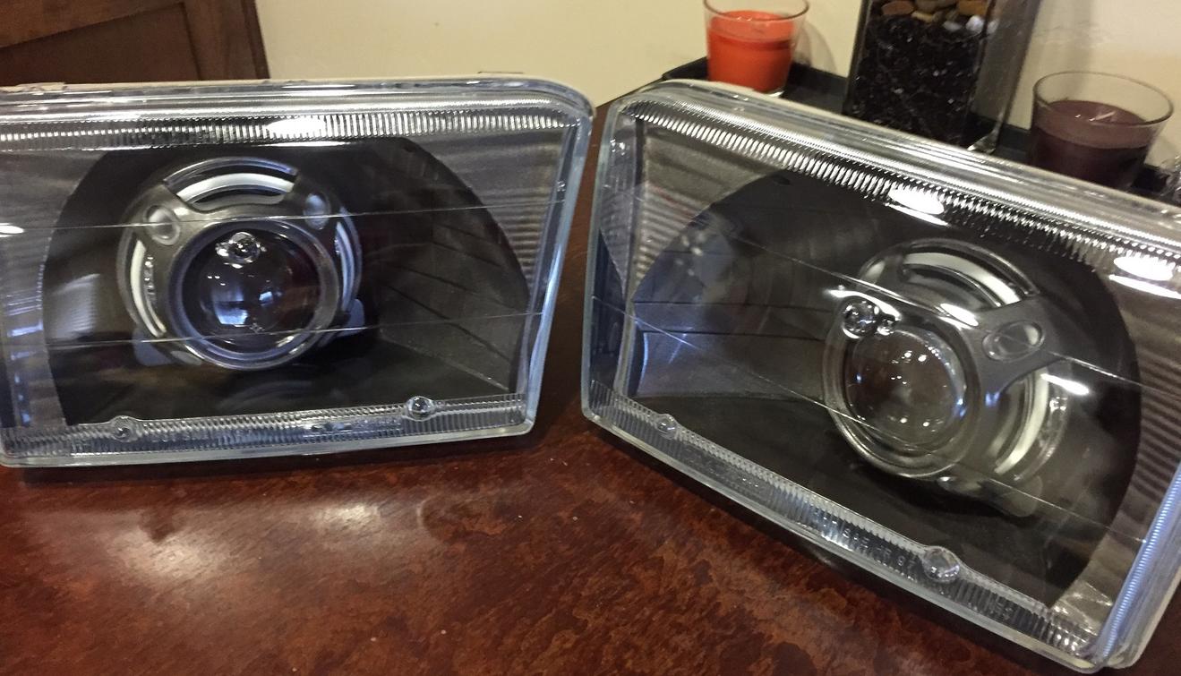

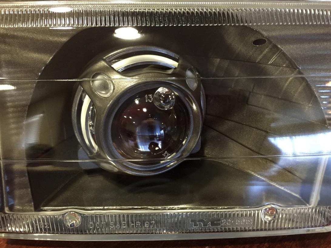

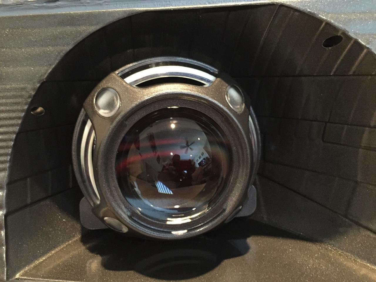

* Assembled the housings by mounting the projector and screwing it together
* Look at the projector in the housing. Align it left/right so that the bottom looks as horizontal/flat with the housing as possible. If you do both lights properly they it will be aligned
* Place small dabs of JB-Weld onto the outside back of the assembled housing so that the big nut stays in place and then on the main projector threads to hold it in place.
* Installed the bulbs (be sure to clean them with an alcohol pad)
* Let the JB-Weld sit at least an hour
* Re-check that the projector is properly aligned one more time, it should be very very tight but you can still move it slightly clockwise/counter which is why we align it and then set the JB-Weld

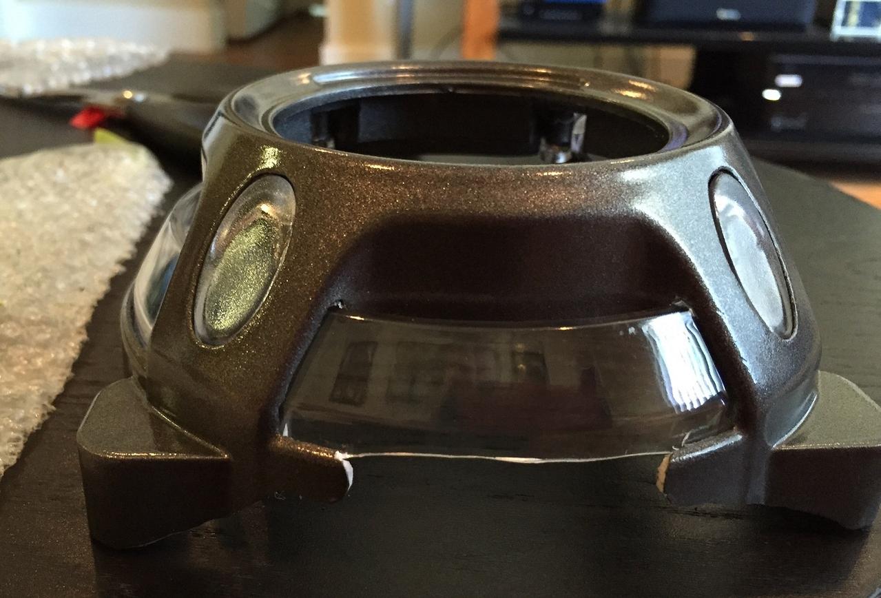

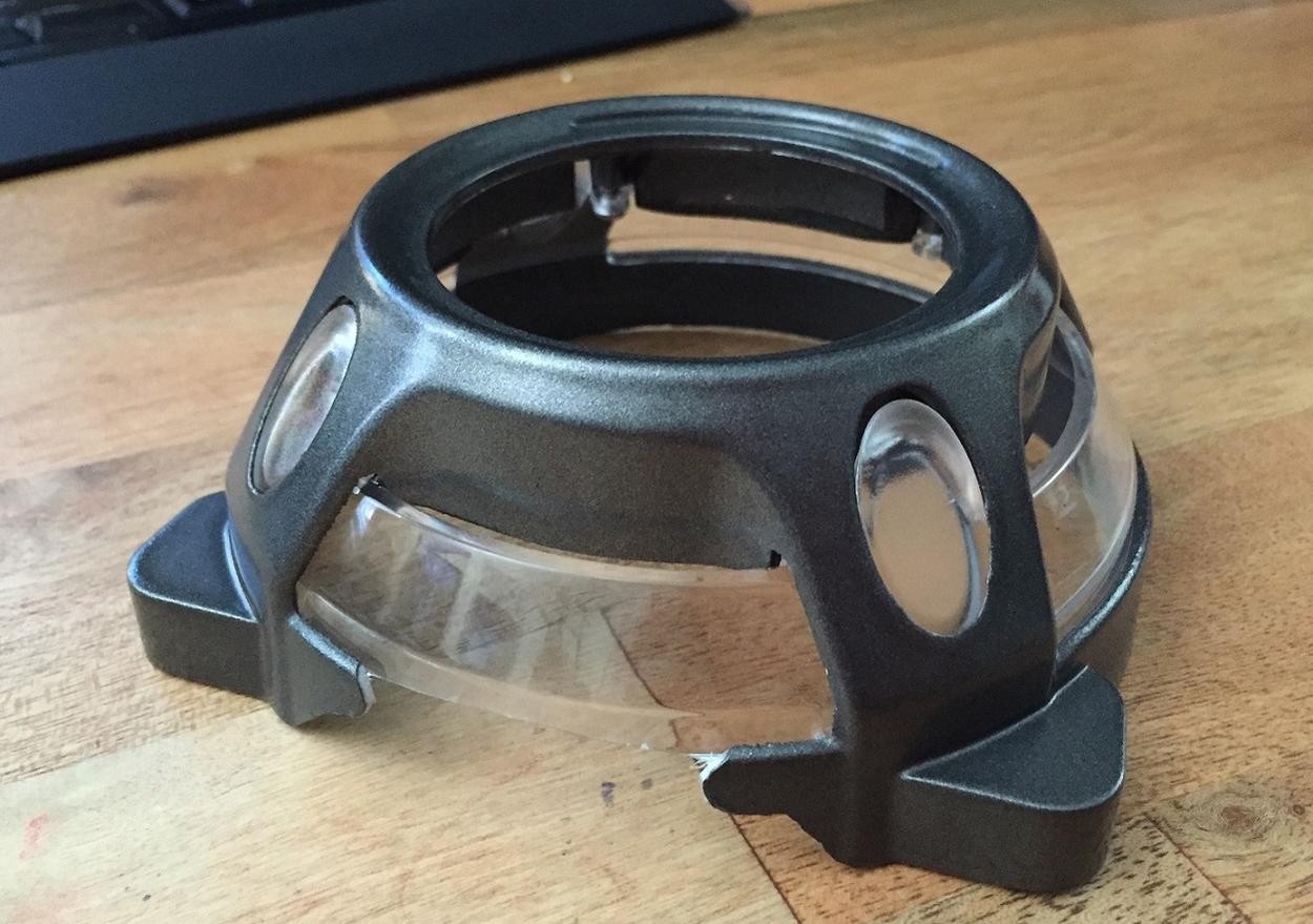

* Trimmed the shrouds with the dremel tool. The Panorama must have the bottom cut as pictured
* Installed (screwed in) the Panorama clear plastic
* Trimmed the clear plastic at the bottom using an exacto knife so doesn't touch the bottom of the light housing

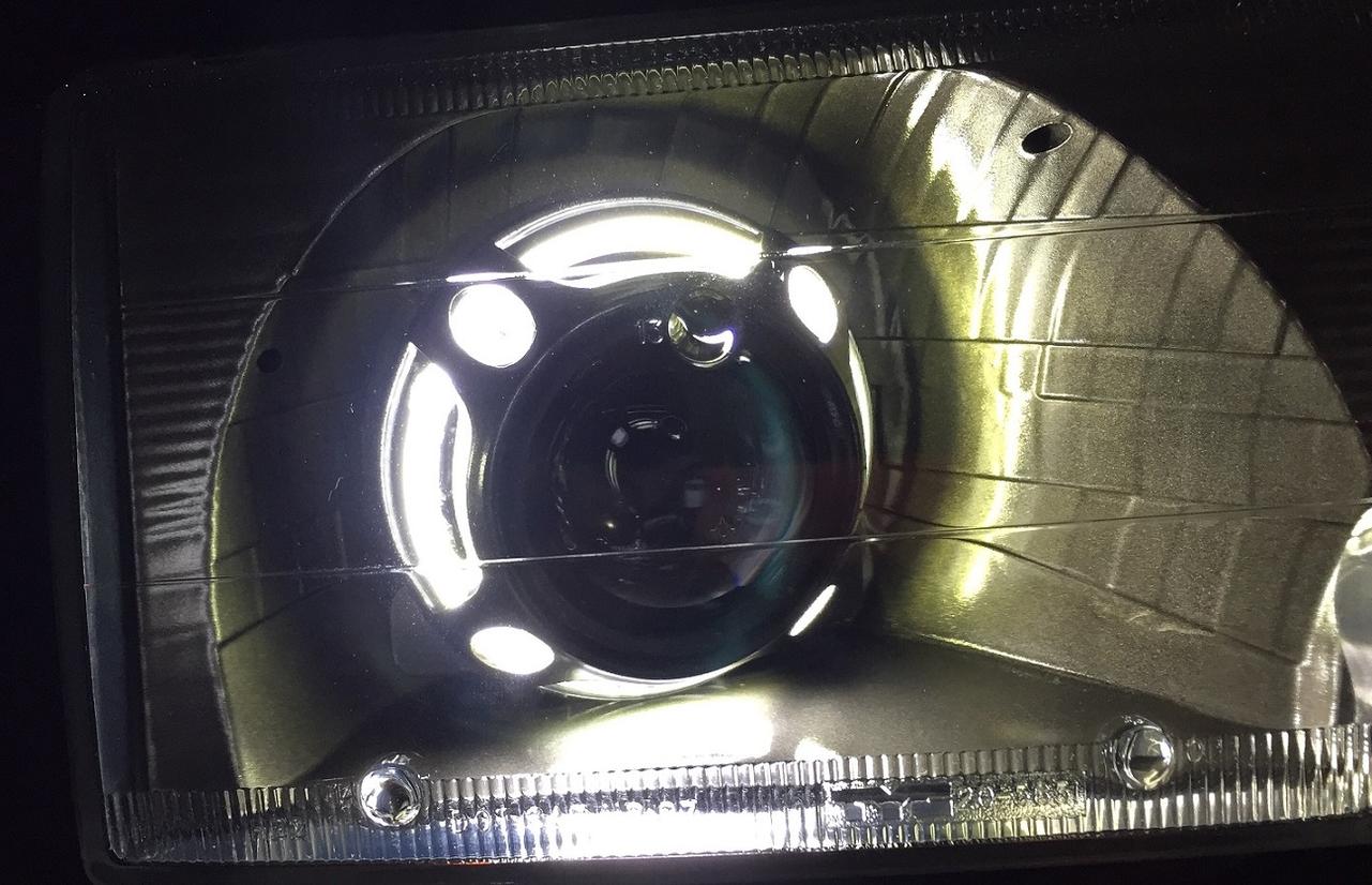

* Installed the LED Halo using 3M mounting tape to hold it in place. You could use epoxy but I've found it will eventually break due to the vibrations vs. mounting tape which holds up and is flexible.
* Ran the wires for the hi-beams and the halo through the extra drilled hole

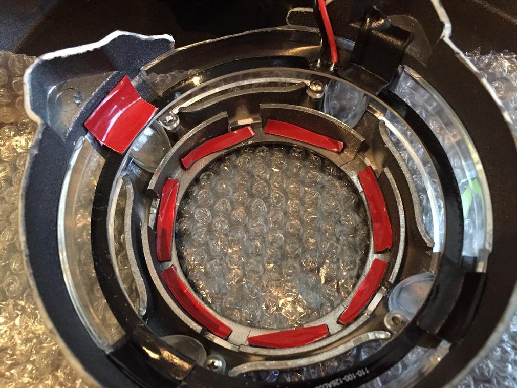

* Placed 3M mounting tape in small strips on the inside of the panorama shroud now that it is put back together and also trimmed
* Installed the shroud over the projector, the 3M tape will hold it in place
* Clean the lens one last time, clean the inside of the TYC glass
* Put the glass back onto the assembly, bake at 275F for 8 mins, take out, put the metal clips back on.

----> I no longer tape shut the retrofit lense, at least not with the 4.0s.

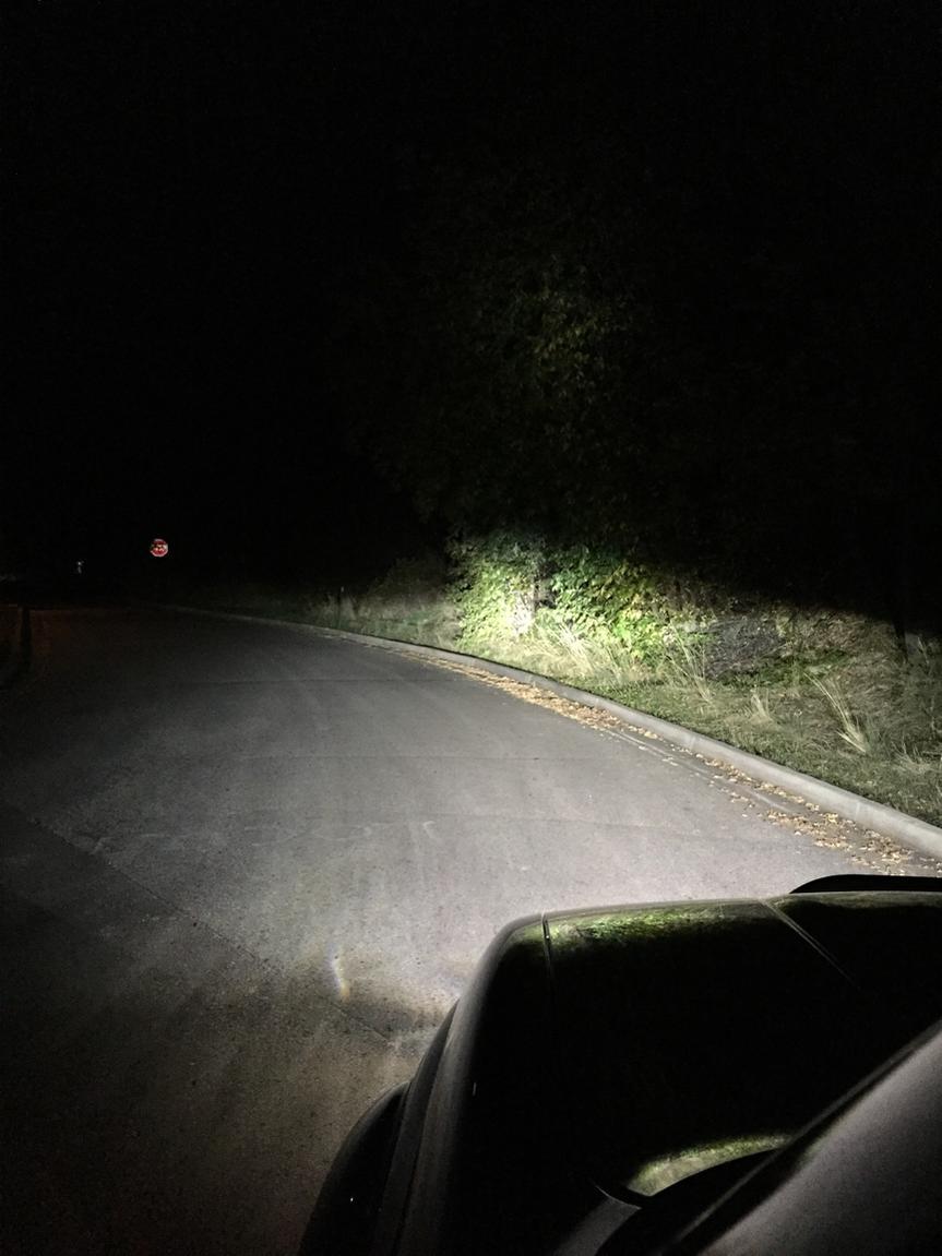

The picture below of the light cutoff shows:
* FX-R fully assembed inside the light housing - on the bottom.
* Mini D2S v3.0 - bare with no light housing - on the top, not mounted yet
I'm pretty sure the top looks so much cleaner becuase it isn't yet in the housing. I think the housing glass bends the light slightly and causes a light double line.

UPDATE: Important Gluing Required
TYC materials are cheap but you can make them stronger. If you don't do this or already did a retrofit and now the lights are pointed far down you may need to take them apart and do this step.
They shouldn't be aimed far far down for no reason. I think what happened is the TYC white/black plastic adjustment shroud came apart. It's cheap material. It happened to me on 2 sets of lights.
Here is how you fix it. If it ever happens to you in the future.
* remove light from the Truck
* look at the white/bkack adjustment piece of plastic, when the screw driver head touches during adjustment
* it should look tight and not like it's falling apart
* if it came apart you need to remove the entire BIG black plastic assembly then snap the small black/white pieces back into place, then JBWeld. Don't worry, it takes 5 minds and you don't open the actual glass light
* I did all 4 (2x per side) so I never have to mess with it again
* use needle noise pliers, and 10mm socket, use the pliers on the spring and on the square plastic clip, look closely at the square. Disassemble.
* now look at the white plastic screw driver driven adjustment piece.
* snap it back together
* clean both with alcohol
* very careful add JBWeld so it stays together for all time
* do not glue the 2 spinning parts to the black base piece. You want to glue to white and black spinning parts together but in a way that allows them to still spin.
* let it dry overnight (even with quick JB I still give it 6 hours)

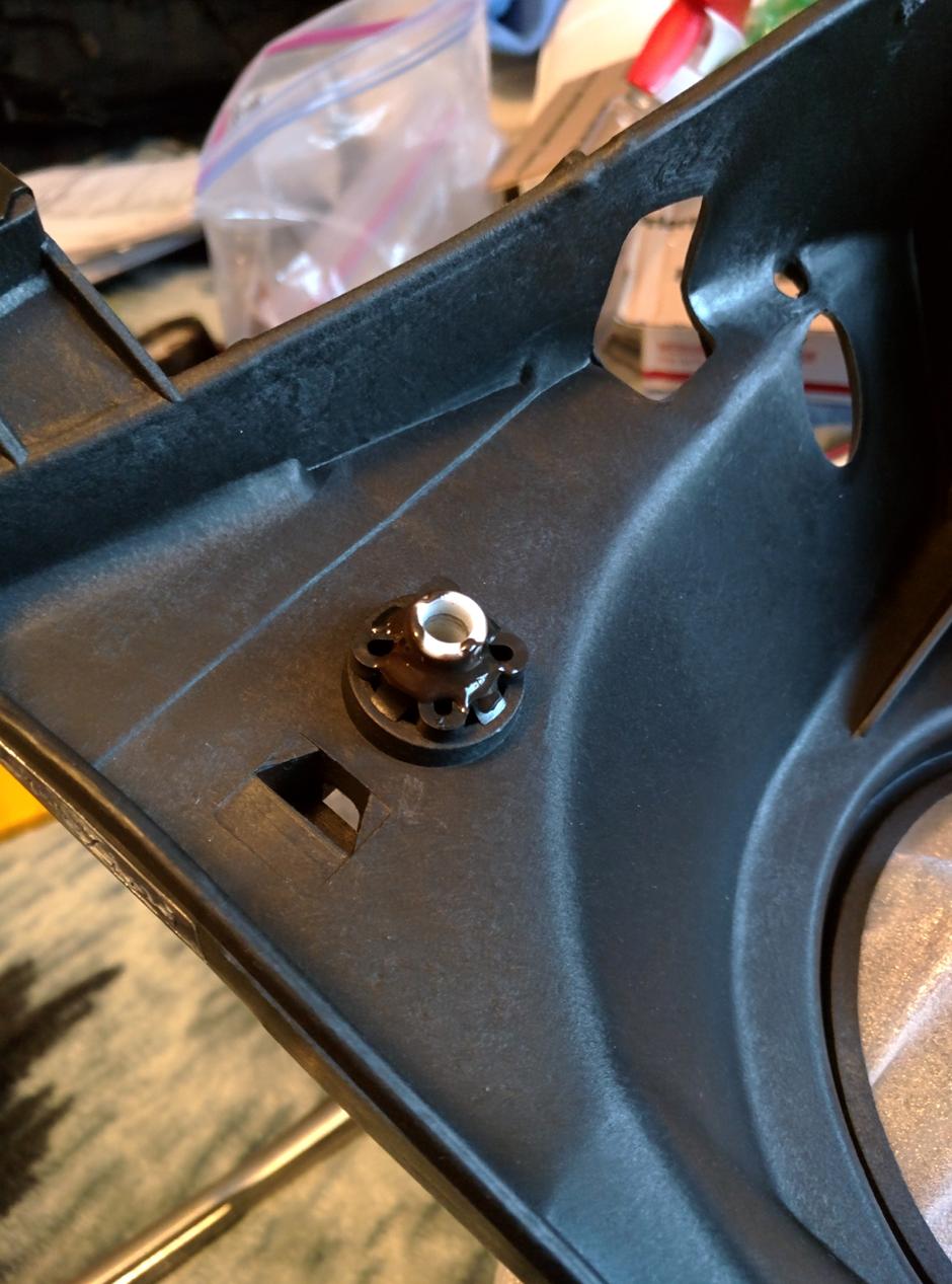

Lastly while you have the assembly apart remove the dome screw shown below, clean the area with alcohol then coat in JBWeld and re-screw in into the housing. Make sure there is no JB on the dome.
See pictures for reference.

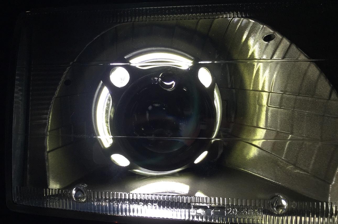

Here is what the Halo looks like on the Panorama. It is crazy bright and this is only 1 LED ring.
