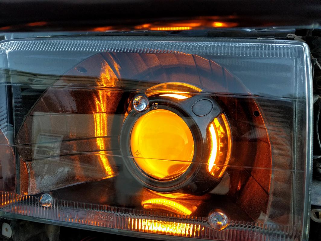

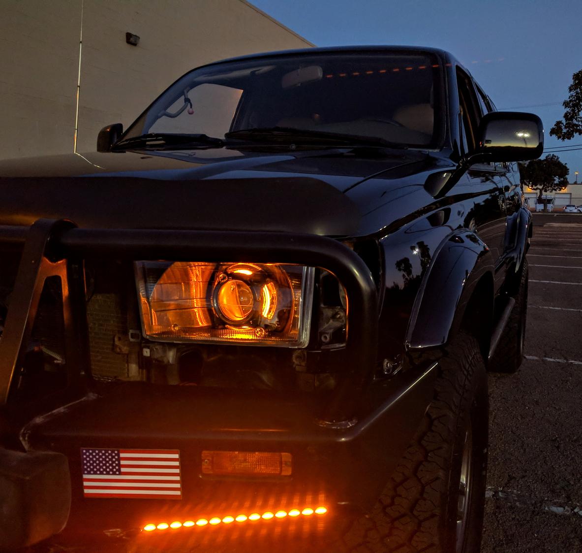

Funny that this thread comes up today. I just finished my Mini D2S 4.0 retrofit. The halos were a PIA! See the Panorama shroud ... customer painted and I painted right over the little circles making it a tilted X. I think this looks a lot better.

These look really badass. I want a set of them but don't have the garage to build them in and I don't want to pay $600. What do you suggest?
I'd suggest you skip the halos and do it yourself, pay someone or find a friend with a garage. If I were to sell them it would be more like $800 because they were such a PIA. BUT I don't have time for this crap lol. My place has been a mess for 3 days now because of this endeavor. I've got a full time job.
If I ever have to do this again I'll skip the halos. Plus these orange are discontinued by TRS and the replacement model is more like a crappy yellow/orange not burnt orange like these.
I probably spent 1x time on the retrofit (painting, cutting, mounting, etc) and then 2x time messing with stupid halos lol. I'm so glad to be done!

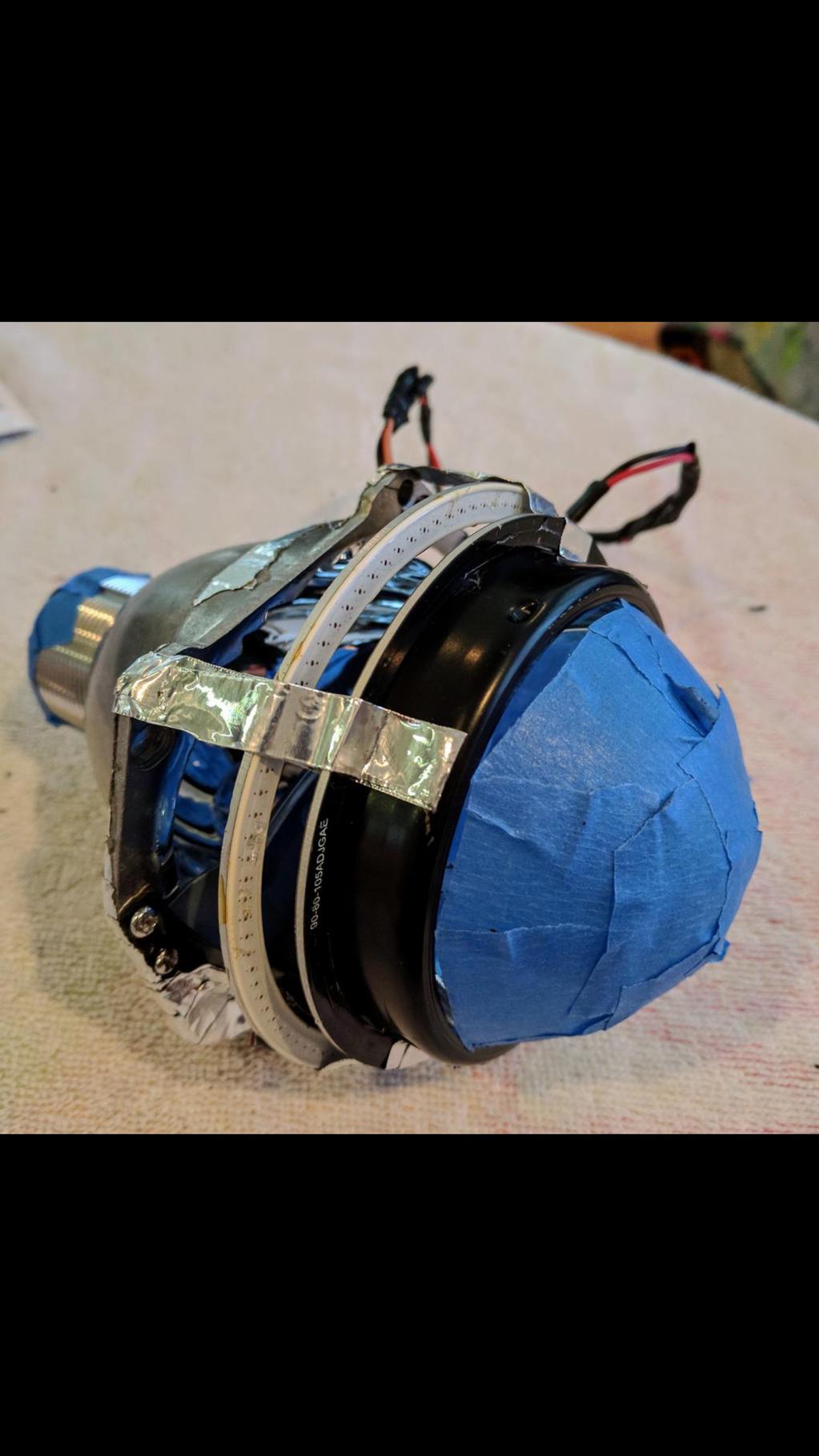

Hi Brian,
Thank you so much for the info! Have you had any issues with the projectors overheating because you taped up all open areas to eliminate light leakage? I am in the middle of a retrofit and I noticed that as soon as I taped up a projector, it started to run a lot hotter.
Also (you replied to this issue in another thread of mine), do you think there is any issue with grinding the halos a tad to reduce their OD? I figured it should be fine as long as I don’t touch the actual LEDs?
Hi Brian,
---> I only did that on the Mini D2S v3 retrofit, which I then sold. It seemed to work just fine. My most recent one I did not seal it up. The most recent v4.0 picture above is the only tape used.
