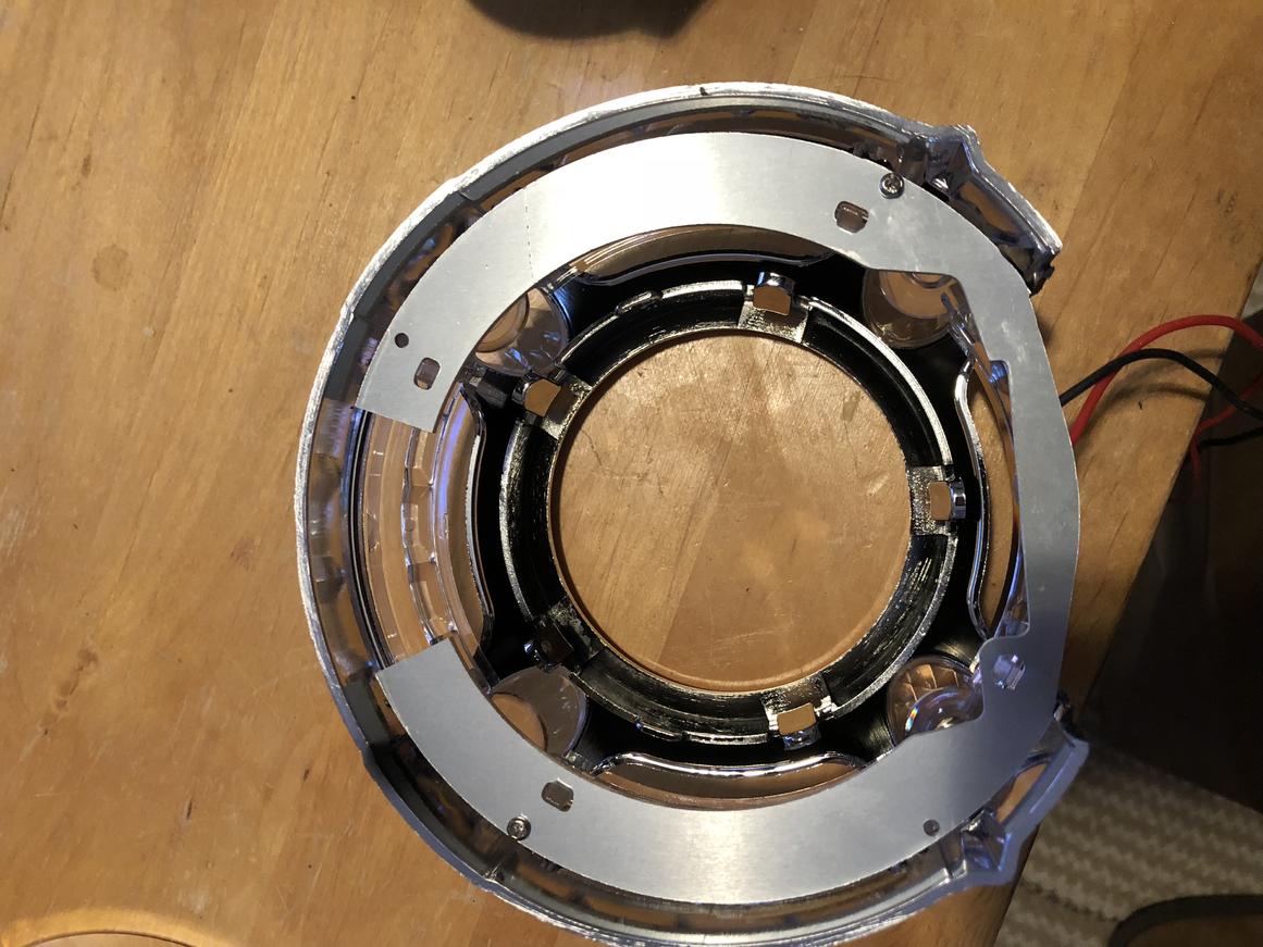

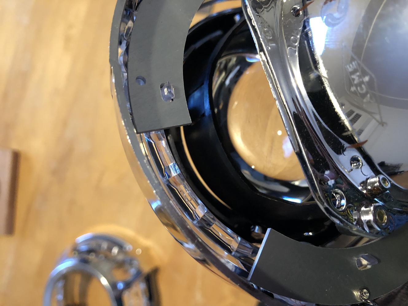

So I feel like this is simple, but I'm trying to see how the Panamera shrouds fit to the H1 projector and it doesn't look like there is much contact between the Panamera shroud and the projector... IMG_0612.jpgIMG_0614.jpg
Also, do I need to cover this whole middle area with aluminum tape to prevent light pollution? I was under the impression that these new projectors don't need to be taped? IMG_0611.jpg

The projectors do not NEED to be taped.
With the 3.0s Mini D2S I did tape them but with the 4.0 I did not.
It is not a requirement.
I cannot comment on the H1 fitment with Panorama. Have you tried asking TRS? They have really good customer support.
Thanks so much! That was really frustrating, as the TRS guys told me I didn't need anything else before I purchased the kit -_- I ordered it, I'm going to do the wiring then hopefully complete this next weekend.
No problem! I searched eBay first to find you better pricing for the rings but seems like the US based sellers only sell them with shrouds, cheapest was almost $25 a pair.

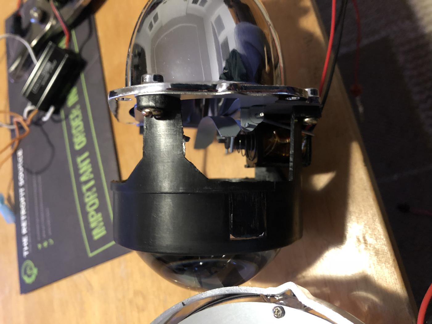

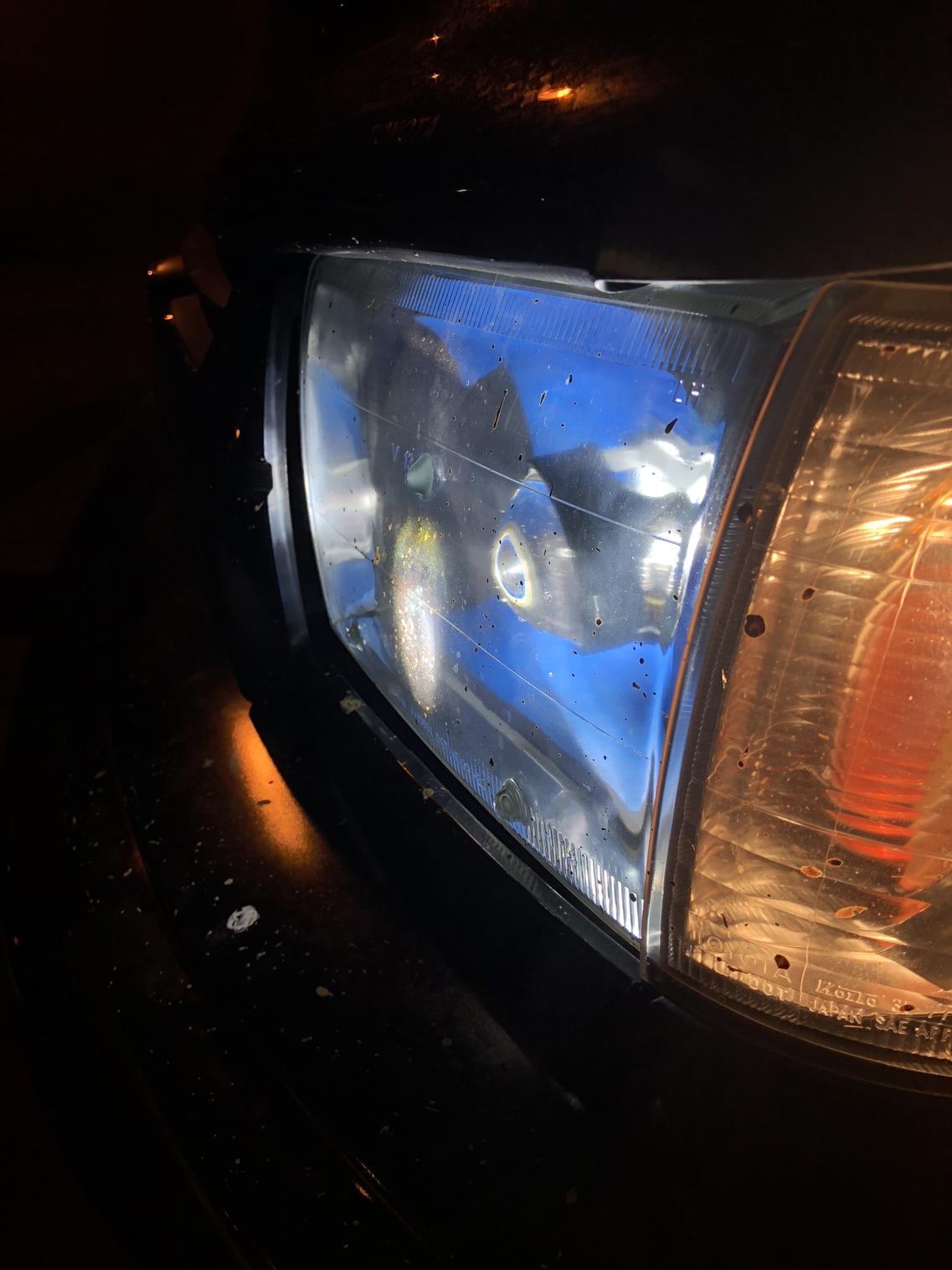

So besides the shroud issue, which I will need to finish installing next weekend, I installed the retrofit and was pleasantly surprised with the ease of the plug and play :) Here's a couple photos of the
1. Looks like I will have to add some aluminum tape to block out the excess light (don't mind the painter's tape, LOL) and fix the aiming of the projector (it looks like it's aimed low in the housing) IMG_0622.jpg
2. These things are on all the time, how do I disable the DRL feature, or wire the halo to be white to run the DRL (i'm sure I can find it via search but figured I'd highlight all my issues)
3. I had no idea where to plug in the two small wires that come from the projector, which I assume opens and closes the little gate for the high beams...any suggestions on this?

Yes the running lights (corner light bulb) circuit is stock and the aftermarket headlight HID wiring harness is tapped into there same stock circuit via plug n play harness. I don't have DRL (97) so it is manual lights on.
My halos (2 per light) and LED strips (1 per side) equal out to 6 parallel wires setup to turn on/off via a Toyota OEM switch I installed. This makes troubleshooting way way easier. Taping into stock headlight wiring for your halos is certainly possible but in the long run (think 2-3 years down road) it can be a pain.

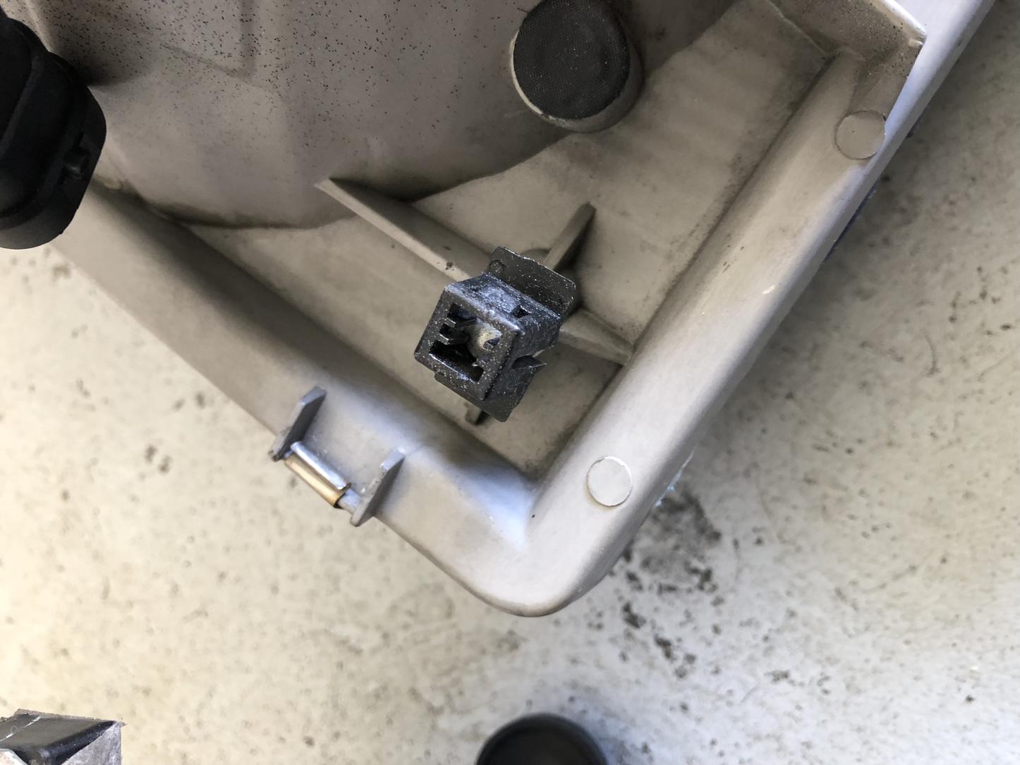

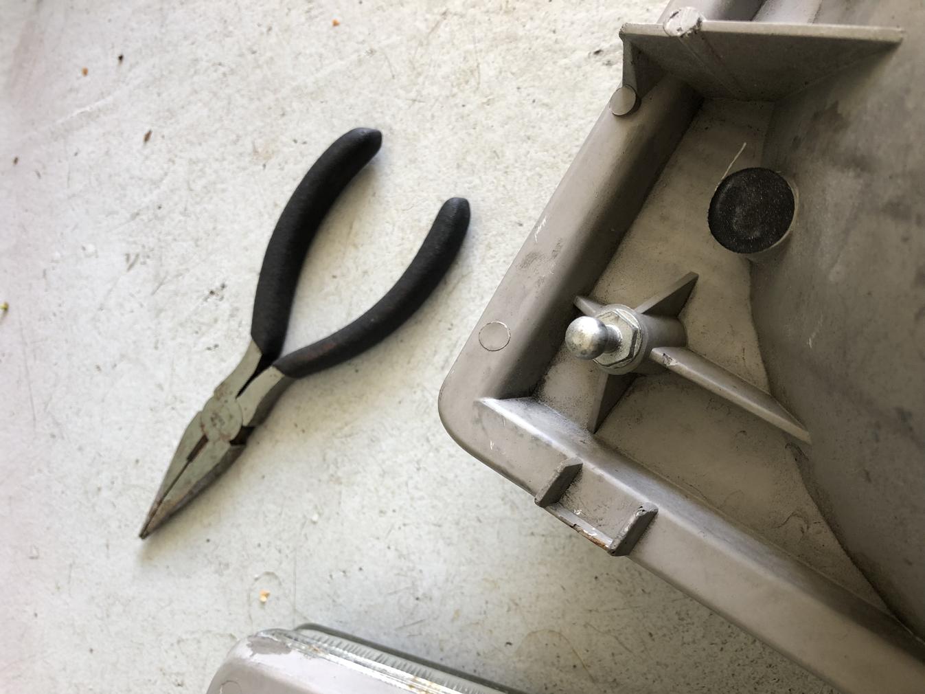

UPDATE: Important Gluing Required
TYC materials are cheap but you can make them stronger. If you don't do this or already did a retrofit and now the lights are pointed far down you may need to take them apart and do this step.
They shouldn't be aimed far far down for no reason. I think what happened is the TYC white/black plastic adjustment shroud came apart. It's cheap material. It happened to me on 2 sets of lights.
Here is how you fix it. If it ever happens to you in the future.
* remove light from the Truck
* look at the white/bkack adjustment piece of plastic, when the screw driver head touches during adjustment
* it should look tight and not like it's falling apart
* if it came apart you need to remove the entire BIG black plastic assembly then snap the small black/white pieces back into place, then JBWeld. Don't worry, it takes 5 minds and you don't open the actual glass light
* I did all 4 (2x per side) so I never have to mess with it again
* use needle noise pliers, and 10mm socket, use the pliers on the spring and on the square plastic clip, look closely at the square. Disassemble.
* now look at the white plastic screw driver driven adjustment piece.
* snap it back together
* clean both with alcohol
* very careful add JBWeld so it stays together for all time
* do not glue the 2 spinning parts to the black base piece. You want to glue to white and black spinning parts together but in a way that allows them to still spin.
* let it dry overnight (even with quick JB I still give it 6 hours)
Lastly while you have the assembly apart remove the dome screw shown below, clean the area with alcohol then coat in JBWeld and re-screw in into the housing. Make sure there is no JB on the dome.
See pictures for reference.
