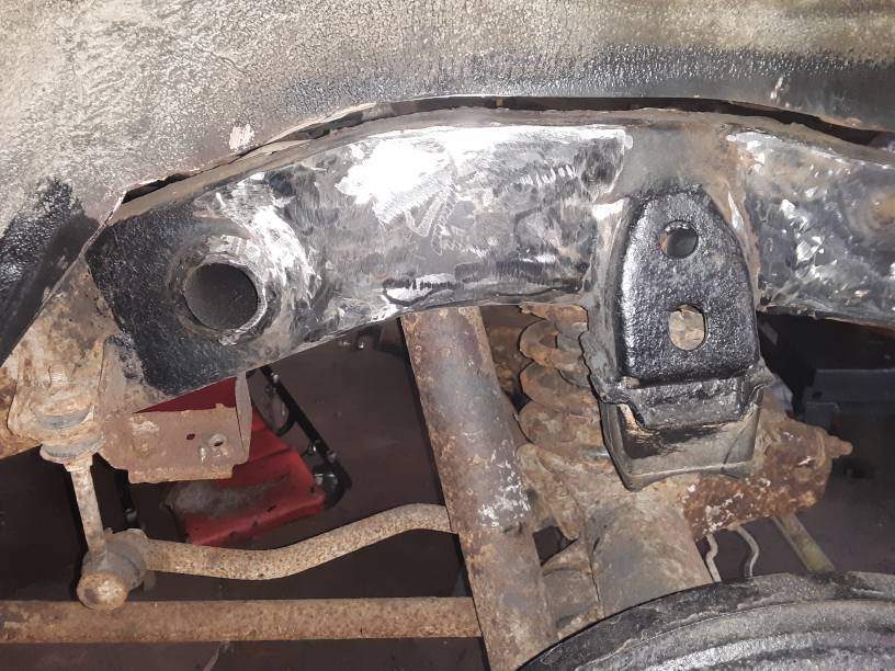

The rust inhibitor dried now it's time to cut and weld plates. :)
Sent from my SM-J337V using Tapatalk
I know you mentioned you use corroseal, have you found that it's better than the rest? Or, basically all rust converters are all the same and, corroseal is just cost effective? The one I've used in the past is Skyflo Ospho.
Corroseal is decent. However it's best to coat with something else after the corroseal is dry. Seemeds to be a working as a rust inhibitor. Just not as a top coat. Ospho been around a long time. I sure it's a grear product as well. :)
Corroseal is rated pretty high. I perfer it because its non toxic.
Inside the frame here I coat it all with corroseal then when welded shut I super coat everything inside with FF. Any of the rust prevention solutions should work fine as the frame is hole free when I done.

I did get the bottom plate welded in on the back. I have to cut 2 outer plates. Then weld the outer frame back on as well..:)

This arch on the 5 speed is looking better..:) half back sealed up again

I like the looks of your frame repairs. Your steel work flows along like the oem frame, looks great!
For a Do it yourself project. My frames are good. I prefer the internal plates and I make a U out of the plates inside. Yet at the same time seal all the frame holes. Seems to work the best out of all the other frame fixes.
