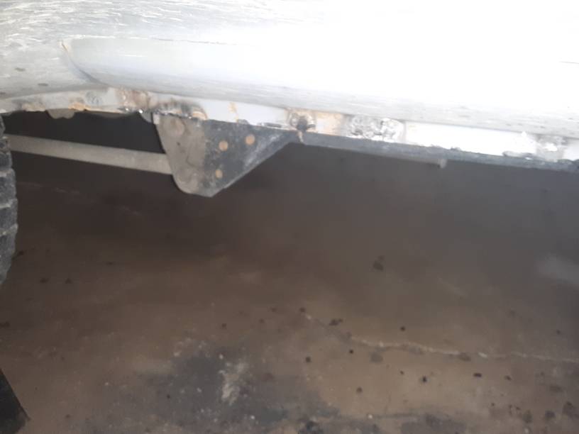

Made the inner rockers tonight and welded them in :] starting to look a little better :]

Finally got the passenger rocker welded back on. Well the top of it anyhow. I ran out of welding gas. Anyhow getting closer to getting that area sealed up again.. :D

Rebuilt the front corner used the piece that I cut off the rocker to weld the 1 x 2 into place. Then welded a homemade angle out of 20 gauge over the both. Reboxed the front with 20 gauge and saved the front factory hole for spraying the inner rocker. The bondo is only to seal the rocker. I smooth that up and paint it but at least it's all sealed up in the front now.

Went back to good old Tetanus 1and rebuilt her drivers inner rocker. I cut the old inner rocker about 3/8 to 1/2 down from floor level. Then welded 4 inch strips of 20 gauge in to rebuild it. As the center support to the front of the rocker was ate by salt. I cut it out as well. Once the inner rocker been welded in and seam sealed. I use a 1 in x 2 in rectangular tube to weld a 3 body mounts to it. Then cut the outer rocker to fit. I cut this one to fit before installing the rectangular tube. You can see I removed the top pinch weld from the rocker. I didn't want to increase the size of the upper pinch weld plus it seems I can get a better fix with it missing. Here are some photos so far. It seems I need to take photos of the inner rocker sealed and painted:]

Photos of the homemade inner rocker. I am not a professional autobody man. Also, I am sure there are 5 ways to do this. This is just how I did it. Next will be the rectangular tube weld on. Then lastly the outer rocker.

Did get the driver side rocker half welded on.
I would do a few things differently.
1). Put the dog leg on last.
2). I would pop rivit the rocker down first then weld it in. Once welded on drill and fill the pop rivets.
Cutting the inner rocker about 1/4 to a 1/2 down. Does seem to work well. I welded the inside and seam sealed both sides of that inner rocker.
The 1×2 rectangler tube. Seems to do a decent job tying the 3 body mounts together. As all my internal structural steel was pretty much gone.
I used the rocker pieces I cut off to weld and strengthen that rectangular tube.
That was my first set of rockers. So I didn't do horrible. Could have went better probably. I know would have been a lot better if the inner rocker is savable.
I need to clean up the welds and smooth with a little putty yet. Then I will paint the rockers red again :)
Not sure how gluing these on would work. If I went that route the metal has to all be bare. I would fit it a few times. Then drill pop rivit holes. Then use them to line it up.
Use the pop rivits as the vicing holders. Then probably just light puddy them over.

Passenger side bottom completely welded on now. I did a drill and fill with it using a 1/4 inch drill bit. Didn't turn out too bad at all considering I started with very little metal left
