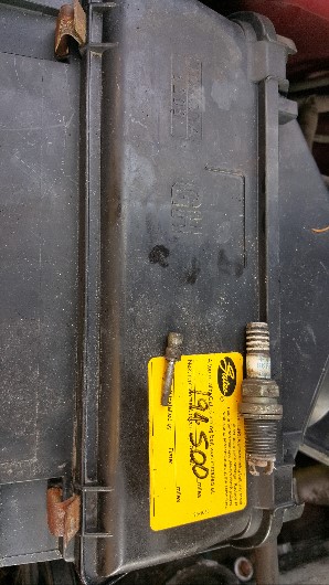

This is the spark plug that broke the electrode at 215K. It was misfiring when I first bought Tetanus 1 several years ago. Its also why they should be replaced as a section of that electrode is stuck in the piston of the cylinder its in.

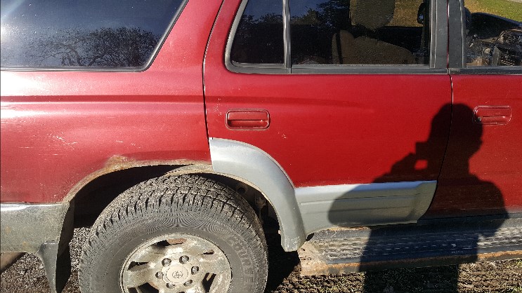

Well January of this year, I had to replace my bumper and repair my rear fender wells on Tetanus 1. The bumper was done from the rust belt and my driver side rear behind the wheel well was getting holy for the PA chrome. I swapped my door first then removed the Sr5 fender strip on the passenger side.
What are you using for replacement bumpers? My rear bumper is perforated with rust and I’m not quite ready to build or buy a plate bumper, and the oem replacements even used are at least a few hundred dollars, any experience with the sub $100 replacements from eBay or rock auto?
Look under my profile on the Tetanus 1 picture album. That is a rock auto limited bumper and sides. you may have to tweak it a little but it was affordable. I painted the inside with gloss black Rust-Oleum and played super soaker with FF. So you can see the Rock Auto rear limited Bumpers looks like. :-)
