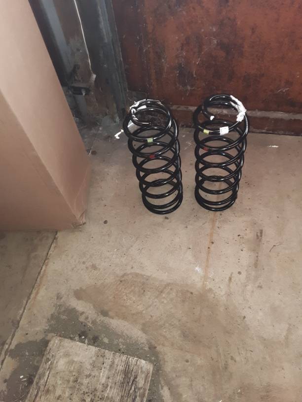

My next little project is to get rid of my 2 inch lower driver side to the passenger side with these 99 Hilander springs. The A/M springs didn't last 5 years so they are junk. I am sure these will last alot longer.:D20200222_170344.jpg

Post a before and after picture with the new springs installed.

Oh sorry. I had a 2 inch lean on my drivers side. I can take an after photo but my springs that were in it were 5 years old A/M junk. :( I am level again with I say a slight 1 inch lift .

Major difference on those springs. Almost like a new ride.
