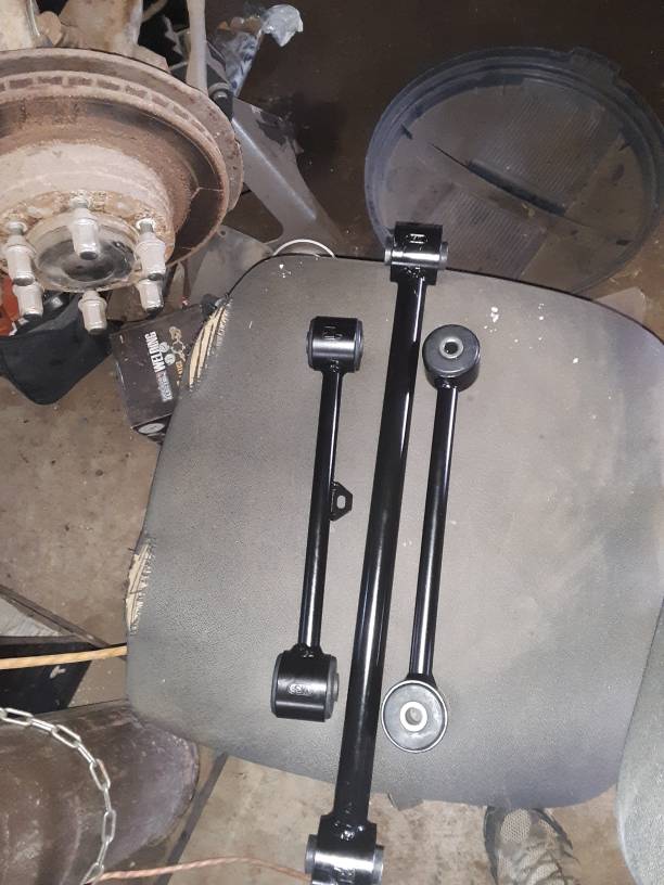

Well it just saved my a pile of time. I changed the rear control arms in the rear and a bolt w as seized. So on 15 Amps and on 110. It melted the nut off. Then I sliced the bolt off about 1/4 from flush and ground it a little. It all fell apart and didnt melt the bushing out of the control arm like a torch would. Nor did it melt my bracket any..:)
Sent from my SM-J337V using Tapatalk
Tetanus 1 just got 4 new control arms today. The one was already installed when I snapped the photo..:) 20200524_132205.jpg
