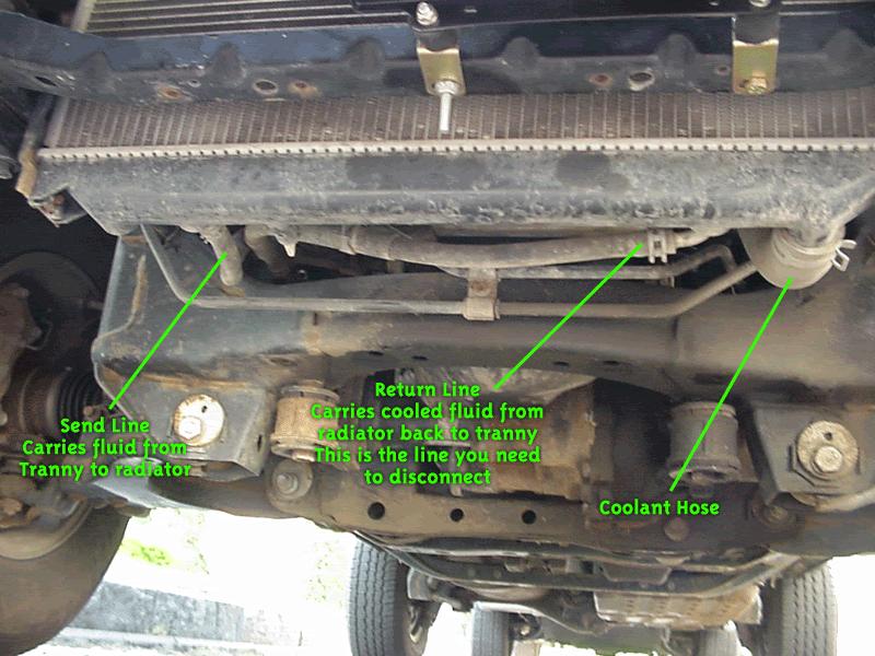

Hook a 3/8 barb nipple to send line on the radiator line cooler ( pull the rubber line of the passenger side of the bottom of the radiator ) use a small rad clamp on the nipple
Hook the new fluid line unto the nipple you just pulled the rubber line off and lightly snug with small radiator clamp.

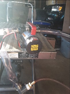

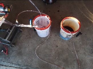

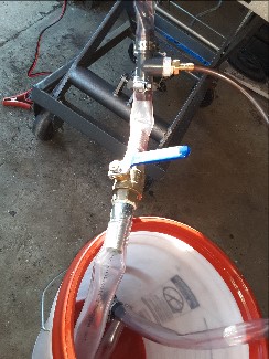

I had an issue with burning cheap oil pumps. So I made a mistake of not paying super close attention and ended up with a 1 inch id Oil pump so I had to retrofit my system to accommodate this way too big pump. So please excuse my photos of the system with the return line into my new fluid bucket and my T feed and ball valve to control the flow and pressure of the fluid going back in.

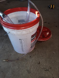

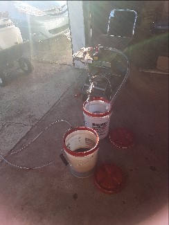

I did however attach some photos of the buckets and pump setup.
Edit: I have a smaller oil transfer pump that i will be adding photos of shortly.
I need to rewire it and put a toggle switch with clips that conect to the battery. I will display it shortly.

2 Translucent 5 Gallon buckets that have graduation levels

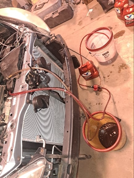

One Bucket is your new fluid bucket the other is your used fluid bucket.

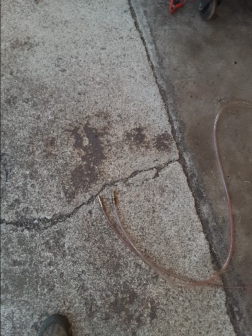

The Send line now goes to the use oil bucket

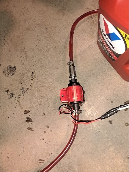

The new fluid line goes back to the outlet of the pump.
The inlet of the pump goes new oil bucket filled with 3 gallons of new fluid (use small clamps if need)

Step 4: Start the oil pump as soon as that is going. Start up your engine in your 4 runner and your used fluid will flow into the used oil bucket.
Step5: Once your fluid goes bright red your fluid is exchanged. Its super close to 3 gallons of fluid. The buckets show you how much came out and how much when in. Shut off engine and if need pump more fluid do it. Check fluid levels.
