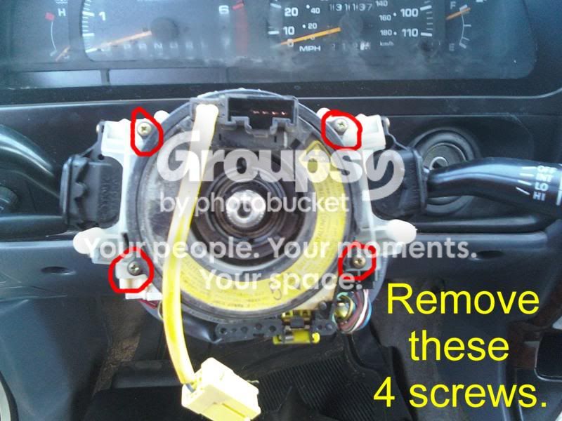

Thanks! I may have messed that up in the process but that isn't what I broke. Look at this picture below, and around the steering shaft threads are three black pegs in a triangle around it. See them? Those are what I broke. Need to find out more about the unit they were connected to.

No, the clock spring IS what you broke. If you have cruise control I bet money that it doesn't work either. Its only designed to rotate a certain distance. If you installed the steering shaft back on even one spline off, it can break the spiral cable which allows you to use the horn and for the airbag to deploy even while the wheel is turned. I have direct experience with this and did almost exactly what you did.

Ok good to know thank you. What did you end up paying for one? I also broke those clips mentioned above though either way so I need to figure out that as well while I'm in there fixing things.

I had mind break right after I bought it. The ribbon cable had kinked and broken several wires over time. I got one off the classifieds for $35 I think. I'm fairly certain ones from tacoma's will work also. Easy replacement.
Those 3 little clips your talking about are part of the turn signal switch I believe. Its the "cam" that turns with the steering wheel and cancels the turn signal switch.
Put on the turn signal and spin that piece and see if it cancels the turn signal. Then you know for sure.
Yeah they cancel the turn switch, but I really don't think that's what the tabs are for. I can see the physical piece in the white unit moving to reset the blinker when I rotate the middle. Really need to figure that out haha.
