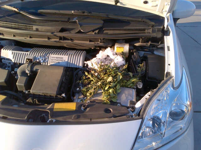

I feel for you. I had the same thing happen to my 2012 Prius. Check out what I found after just under 32hrs outside! This was a $9300 insurance claim, main loom, inverter, firewall insulation, and other components ruined by a giant mother rat. I knew something was up when I saw debris under the car..when I lifted the hood up, a huge rat ducked deep into the engine compartment. We actually got the car started and pulled it back about 10 feet and the rat dropped out of the bottom and made a dash to the bushes, my dog immediately intercepted it, and tore into into it, biggest rat i ever saw, dog dropped it and I beat the living crap out of it whilst cursing at it at the top of my lungs!!! Prius was at dealership collision center for 2 months!!!! The damn thing was practically rebuilt. I had a 1K deductible and Metlife auto paid the rest. It was covered under comprehensive. Havent had any problems with the car since. Those vermin love warm cars and electrical wiring. The salt residue accumulating on wires is a delicacy for them. Dude...what an ordeal! I hope it all works out for you, I know what you are going through.
