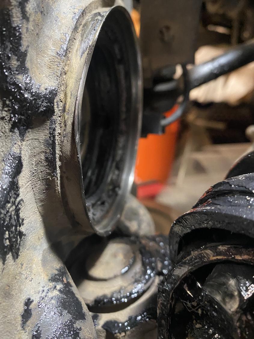

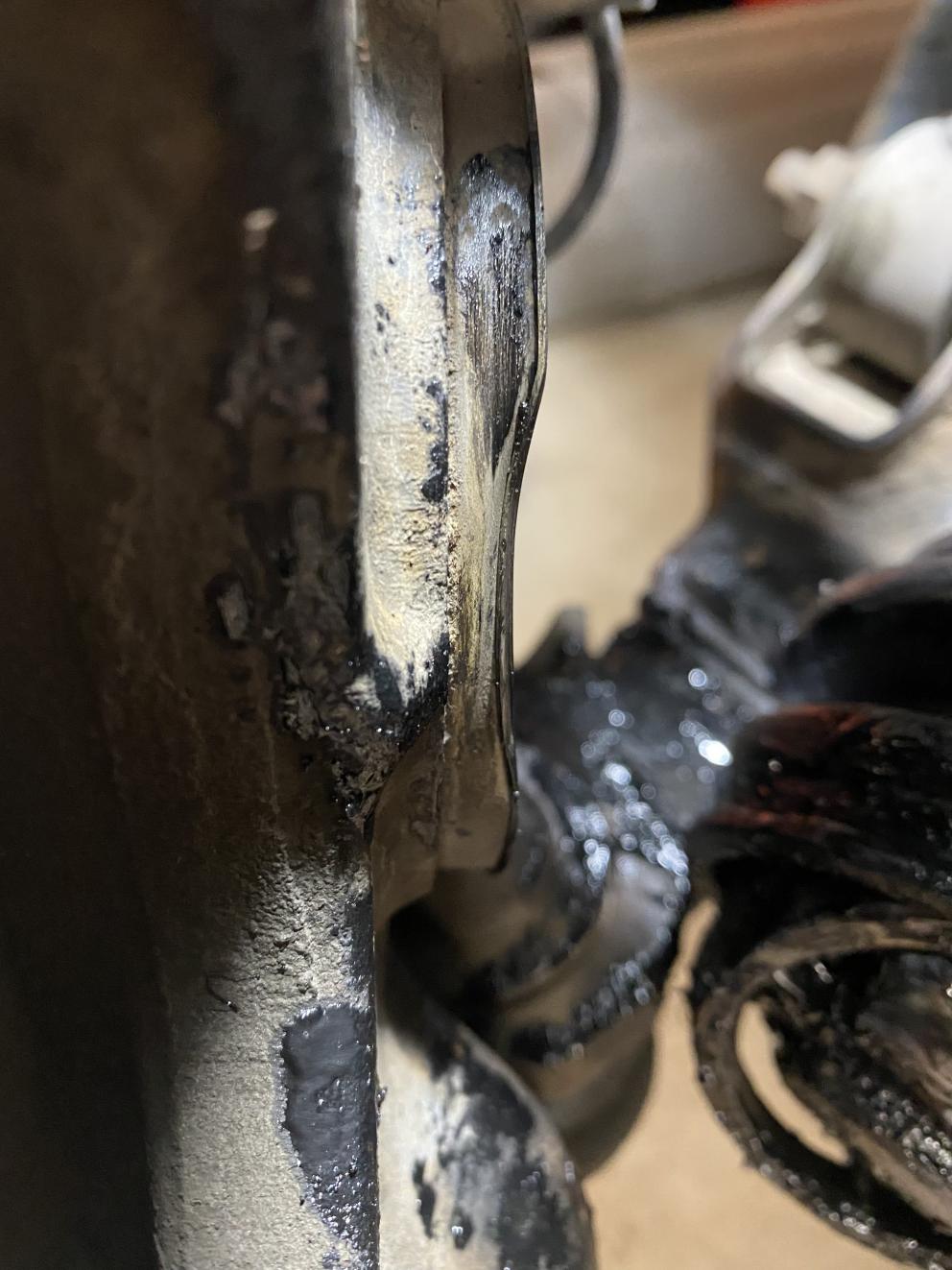

What is bent? Do I need a new hub? I think a seal may go here, what is it? Can I ignore this bent ring? What is it?

that is the seal itself, the wheel bearing seal if i'm not mistaking, or whatever you want to call it. If you want to do it right I would replace it, however I have also hammered stuff like this straight and let it be as well lol
Change both at the same time. Oem is recommended but I got a set of aftermarket A1 Cardone axles for $120. So far they are smooth as a cloud. The quality of the boots and the method they are banded on are exactly the same as OEM I off road a lot also. I figured I could buy like ten sets of those for the same price as oem. And it's not that difficult to repair so why blow money on hear say. Keep you old pair in case. You can reuse the boots if necessary. Do a diff service and check the diff dust seals for damage and are properly seated. I changed my axles at 100,000 and the diff seals were in perfect condition. They are very good quality. The bent area on the hub probably happened when your axle busted. It looks not only bent but crumpled in also. This is where the dust seal on the axle seats so it needs to be not crumpled.. bummer.. I see the dust seal on the inside of the hub. It looks destroyed and filthy in there. There should also be a stainless retaining spring in that seal. C clip gap down when installing. Be careful around your speed sensors I just take them out. They need cleaned anyways of metal particles. Also the same with the magneto ring. Careful with your abs line not to stretch. Replace old filthy grease with the same amount removed. The correct grease! Good to go.

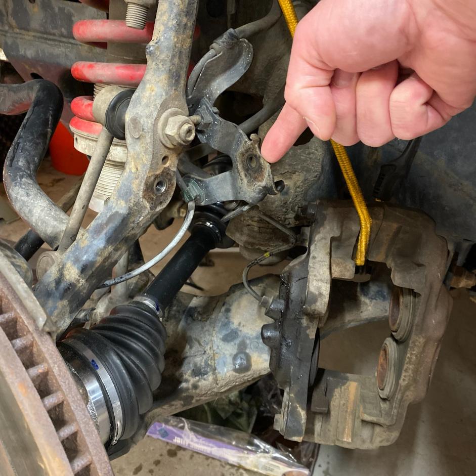

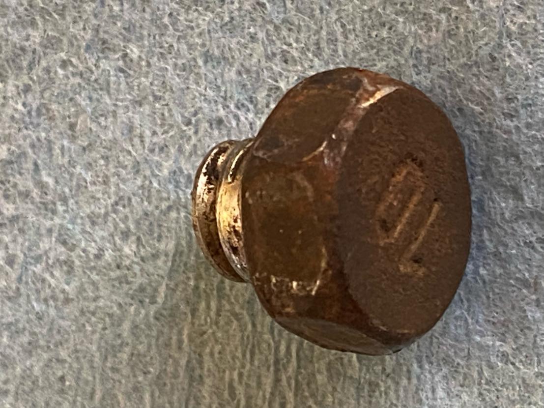

Thanks for all the feedback, I got it done with one exception.
I have one further question that frankly is really pissing me off. I broke the #10 bolt for the brakeline bracket, it seems to be impossible using the interwebs to identify it's size and where I can get one...just one, I don't need $35 of a kit of other shit I will never use. Help, I'm really frustrated.
its either m8x1.25 or m6x1.0. Go to ACE or Tractor Supply and pick one up.
I don't remember the exact size but I bought the same bolt for my 4Runner at either Home Depot or Lowes, it's been a while so I can't say which store it was but they both should have it, I just took the broken bolt with me to the get the correct diameter and thread using their bolt/nut size display, for the length I just got the one that I thought was right by measuring the depth of the threaded hole as best I could.
