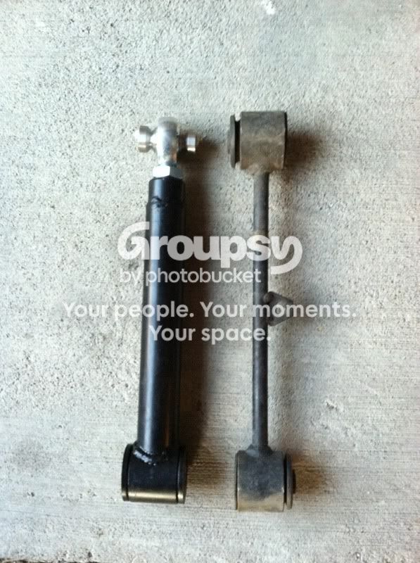

Here is the toytec ones.. at 289 a pair..
*NEW* Fully Adjustable Rear DOM UCA - Toytec Lifts: Toyota Lift Kits: FJ Cruiser Lift Kits, Tacoma Lift Kits, Tundra Lift Kits, 4 Runner Lift Kits, Sequoia Lift Kits, Toyota Truck Lift Kits
They are the only ones I can find that arent part of a complete link kit.

Here is another couple of links for 4Runner UCA and LCA's that I had bookmarked:
HFS Suspension Links | Hardline Fabrication Systems
Control Arms
Thanks! I am actually looking at building a set of my own now. I have a local source for DOM tubing, I have access to a shop where I can notch the tubing and prepare the bushing ends.
