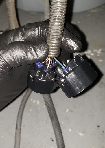

Broken plastic electrical connector. OEM replacements? *Pic*

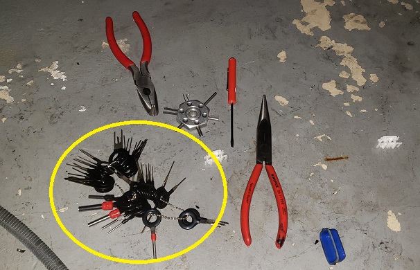

I picked up a similar tool kit.

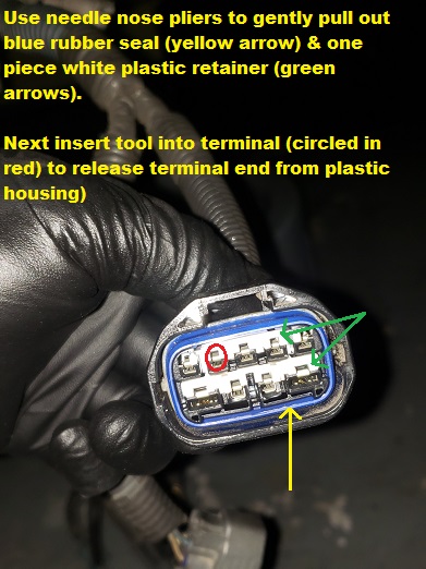

From what I saw on youtube, it seems like to depin this connector, you first pull out the white plastic retainer circled in yellow in the first pic using needle nose pliers, then insert the depinning tool so it slides underneath the small plastic tab that is resting on top of the metal terminal, in the 2nd pic circled in red, to release the terminal correct?
Yes! The only resistance should be the wire seal on the back of the housing. Any old pick should be able to move the locking tab, as it is right there. Go pin by pin (remove, insert into correct pin on new connector, continue) to avoid mistakes.

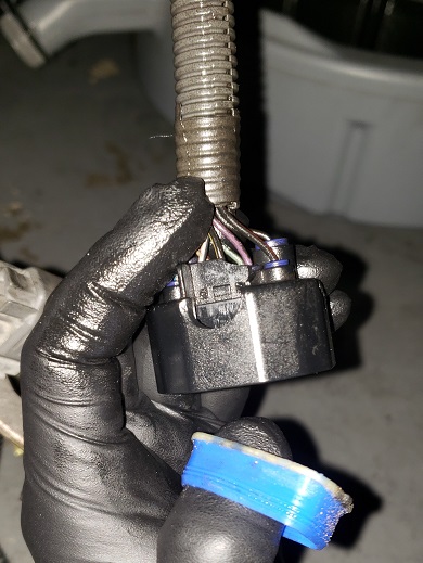

I had a lock tab break so I just put a little RTV on the plug, only a small spot to hold the plug in place but able to remove if needed.:zoom:

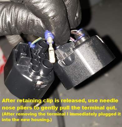

Pics below depinning the park neutral position switch terminals & repinning into new housing. This was pretty quick & easy to do BUT I destroyed my original plastic housing because each time I inserted the tool to release the terminals the plastic would break apart. Not an issue in my case because I was replacing it with a new one since the original one was already broken. It was probably a combination of the old brittle plastic and my lack of experience depinning electrical terminals. The tool circled in yellow (last picture) worked better than the hex shaped lisle tool above it.

How do you like that tool with all.the different size depinning options?. I know mine comes in handy. :)
Sent from my SM-J337V using Tapatalk
I liked it much better than the lisle tool because it had a lot more size options to fit into the terminals.
