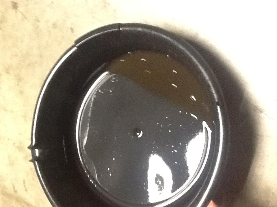

Important maintenance issues: I just replaced the fuel filter. The old one was a Toyota part which means it probably has been filtering gas for all 107,000 miles. The new one looks just like it w/o Toyota sticker. I noticed a nasty brown tint to the fuel I drained out of the filter. Thankfully that's what a filter is for--to catch all that stuff. Noticed better throttle response after the new part.
This is the gas I drained out.

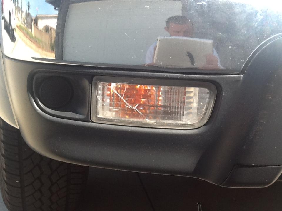

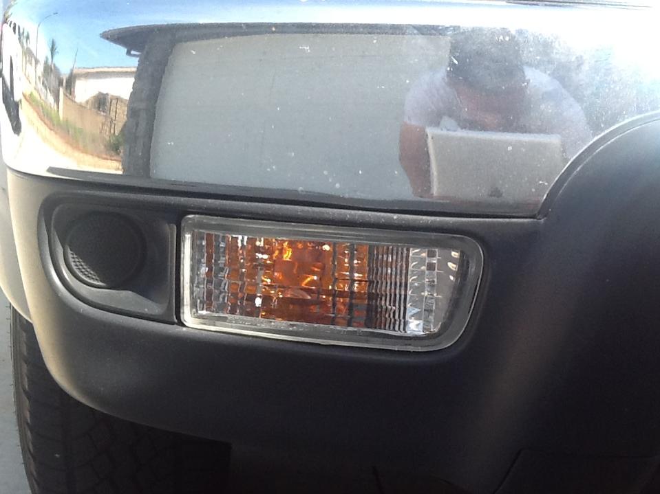

I also switched out my blinker assy. since it was cracked.
Before

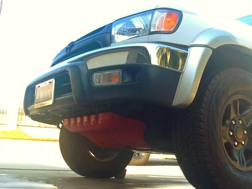

Less important aesthetic issues: I painted my skid plate red. I think it looks awesome :)

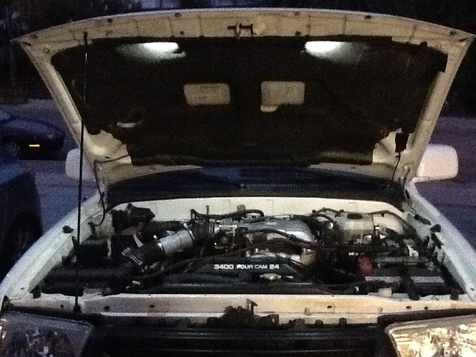

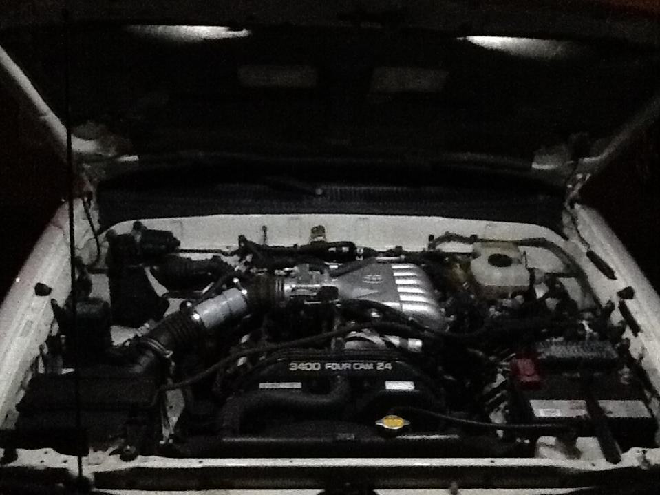

I just did a sweet mod that I found on the 4th or 5th Gen pages (shhh, don't tell). I installed LED lights on the underside of the hood so the engine compartment is lit up when the hood is open. Here is the site I found the lights and the hood switch
It wasn't too hard to install. Recommended materials are:
-at least 2 LED light modules
-hood pin switch
-about 50ft of 22 guage electrical wiring
-2 non-metal washers (plastic works well)
-3/8"-24 thread nut (this is a finer thread- 18 doesn't work on the hood pin)
-Rubber stopper
Here is a write-up of the mod.
Here are pics. First is a wide view.
Next is the engine compartment at night, lights on.

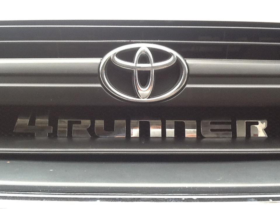

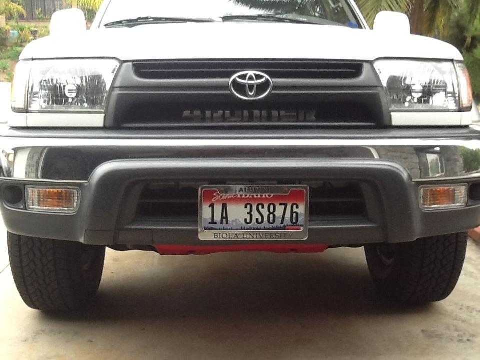

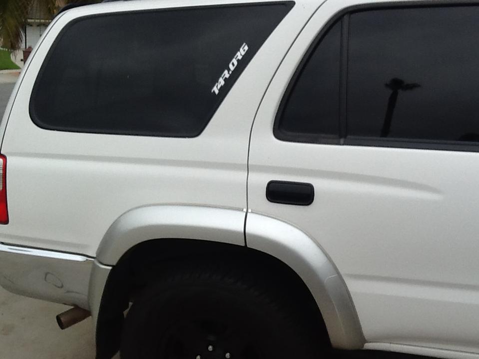

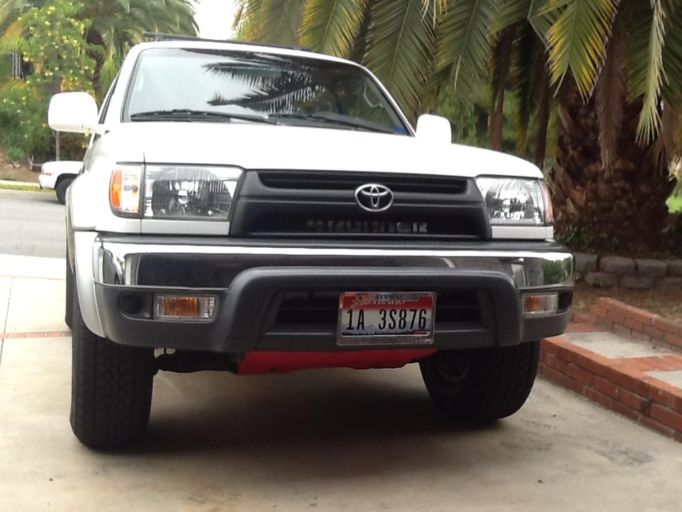

Modified Satoshi Mod and T4R.org sticker
Got my T4R.org stickers in the mail today!

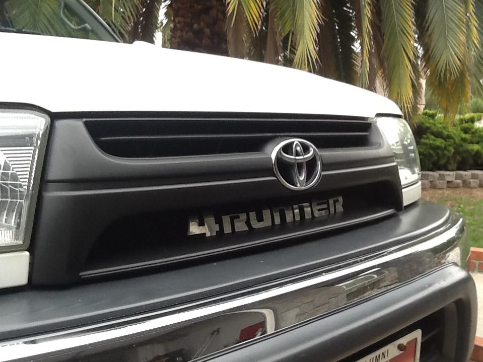

I also attempted a modified satoshi grille mod. I think it looks pretty good.

I'm not crazy about the grill but I definitely give you credit for trying something different. Looks like a clean truck, good luck with it.
I like the grill idea man. I might paint/plasti it black (stealthily blend in) or red (to match the skid) instead of chrome but that's just me, great idea either way!
Nice work so far - maybe if you slid a small strip of LED's in above your grill mod that thing would really pop at night! Just an idea...
